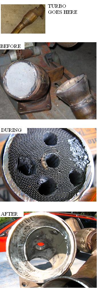

I believe that gutting the precats is worth doing on any car, and definitely the K03's if not for the power but just the fact that it reduces the heat build up on the turbo hot side.
Those precats are awfully close to the turbos. Like Woody says "ever tried breathing through a breeze block".
Id say, if youre having exhaust put on the car, or having the downpipes off for whatever reason it would be a good idea to have the precats done as youre half way there already.
At present Blower I believe is having some BHP under construction which = change of turbo's etc. As the downpipes are off I would recomend gutting them, firstly you would have less heat build up, and secondly as a result, less restriction. Even a few extra bhp squeezed will make a difference. Its the pennies that make the pound!
Reducing that back pressure as Julian has said was my main goal, and I believe that in doing so my whining K03's have lasted the miles that they have.
When downpipes are off at the garage , you could Just take them away and drill away at them for a few hours till job is done.
I think looking at the pics below (courtesy of another thread) it becomes apparant as to how restrictive the precats are.
I wouldnt say its necessary to do them, but if youre running high boost as in the usual stage 3 upgrade or high boost on weak K03's just for safty reasons its a good mod to make just for prolonging the life of the turbos. Any power gains made are a bonus.

I have some facts about gutting the pre cats. The car (A6 biturbo, tiptronic) has a chip and cat back exhaust, and it was dynoed before and after the gutting. Nothing else was changed.
The difference was +10 HP and +20 Nm, on the 2500-5500 rpm range. And the maximum power and torque came 500 rpm's earlier. On the 1/4 mile the car was 0.3 secs faster.
I think that is well worth doing compared to the costs.
