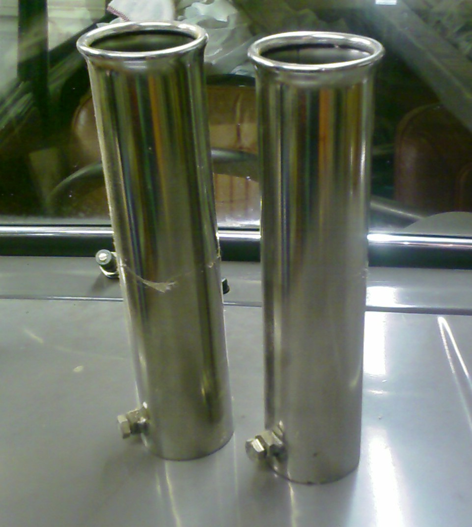

Just been out in the garage...
They are about 24.5cm long and 55mm diameter
Mark

Thanks. I suspect small diameter pipes, even the same size as stock S4 will look daft as the RS4 outlets are wider apart to accomodate the large oval trims.
Think I need one more quote for say some 2.75-3" tailpipes then I'll make a call.
Sourcing something like the picture in the right diameter should be easy and the welding not an issue so long as they just need to align straight on, no angles required to bring the trims up into the cut out. I am hoping the box can adjust up and so the tailpipes stay at the level they were before.

Yes you wouldn't want them too far apart.
You need to get under the back of an RS4 to see how it all sits
Mark
