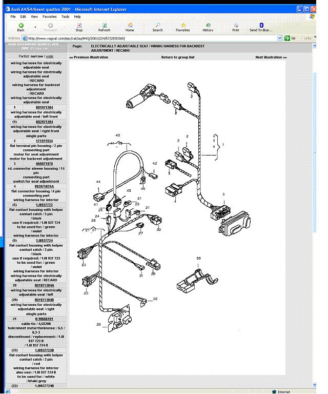

Post by shineydave » Wed Feb 21, 2007 6:54 pm
oh dear, this is turning out to be quite a job trying to determine whether the Recaros have heaters or not.
Got under mine and there certainly appears to be more than 3 plugs then i found this lot.
so the quest continues. from the drawings it looks like were looking for a flat, 6 pin conector
