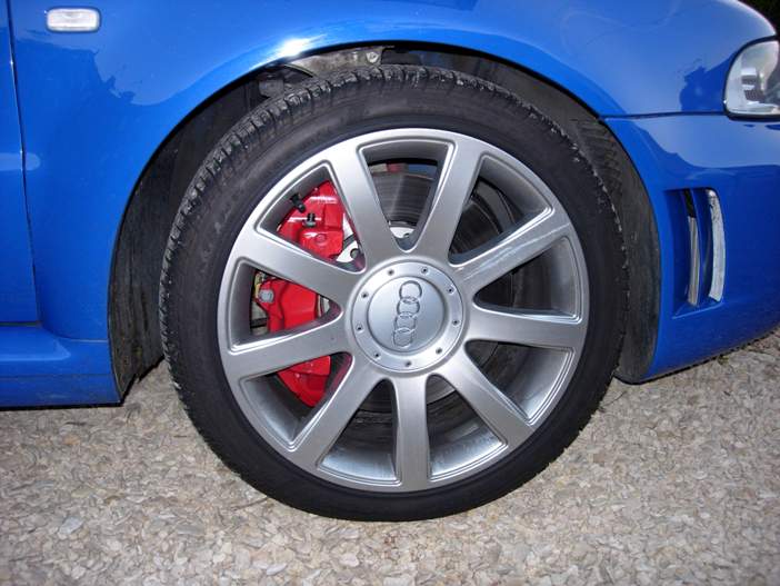

What Keith uses are Brembo 6 pot calipers which were designed for a GT3 I believe. With a small modification they fit the RS4 perfectly and look good. He fitted mine as a bit of an experiment 6 weeks ago and they're very good. Used them at Croft recently and no real noticeable fade with the yellow pagid pads. Significant improvement on the original 2 pots which as people have said are adequate for normal use but no good for really fast driving/trackdays.

Managed to take a quick picture to show you. Dirty wheels but you can see why they need to be 18". Could have had them any colour but like the original Porsche red. It also reminds me of the Movits on my previous S3 which were excellent but even they were a lot more costly than this option

The price Keith quoted me was very reasonable and it looks a good combo. Those calipers are massive!
