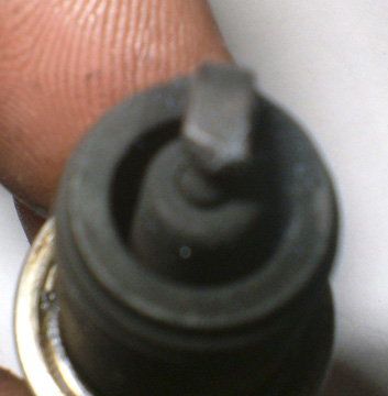

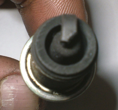

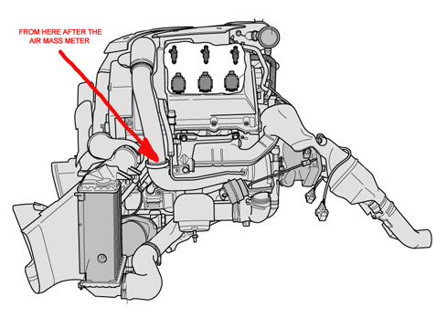

Post by BRETTCOLLINS » Fri Jul 01, 2005 12:16 pm
Outcome of my old engine, TWO melted plugs, deternation on 6 and 3 and engine was getting un-metered air after the air mass meter, see photo's.

RE: MY OLD ENGINE
Post by Dippy » Fri Jul 01, 2005 2:58 pm
I assume:
Air leak = lean running = hot running = plugs disintegrating = damage...

RE: MY OLD ENGINE
Post by DuncS3 » Fri Jul 01, 2005 3:12 pm
Sure, understand - In this scenario cant the ECU help by going into limp etc?
