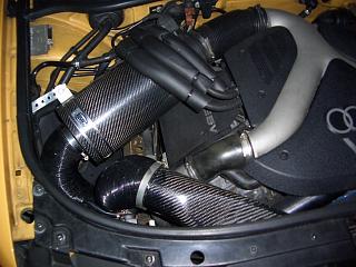

I have all of the above installed, BMC was the first to go in. It breathed a little bit smoother especially on the top end. But to be honest, to realize the top end a downpipe is the most effective mod to have. Mind you fitting of the BMC is tricky, i had to have a custom intake duct made to mate it properly with the induction tube. Will post some pics.

here's pic, wonder why i'm always posting replies twice....

Thanks for the pic and your help. looks very tight. where can i go to have an intake hose made to fit the original intake.

I'm located in Hong Kong and it's a custom job by a local shop. Not cheap, it was a group order for about 10 and cost was almost equiv to that of a CDA box. For show it's excellent, but practicality-wise i'm not so sure it's worth so much. It's one of the best looking CDA install i've seen on the 2.7T tho....

Where do you locate the four sensors on the to of the air box??

Underneath it, bolted to the chassis with a screw...
