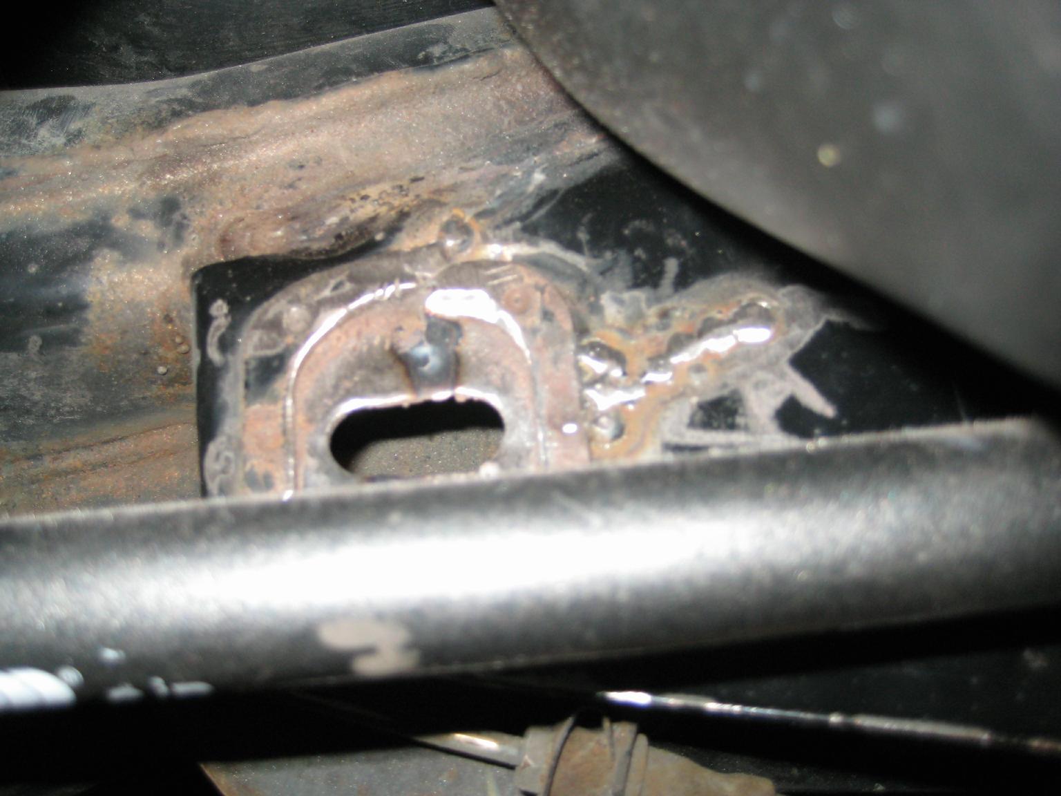

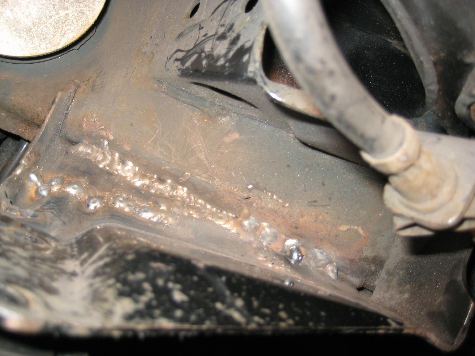

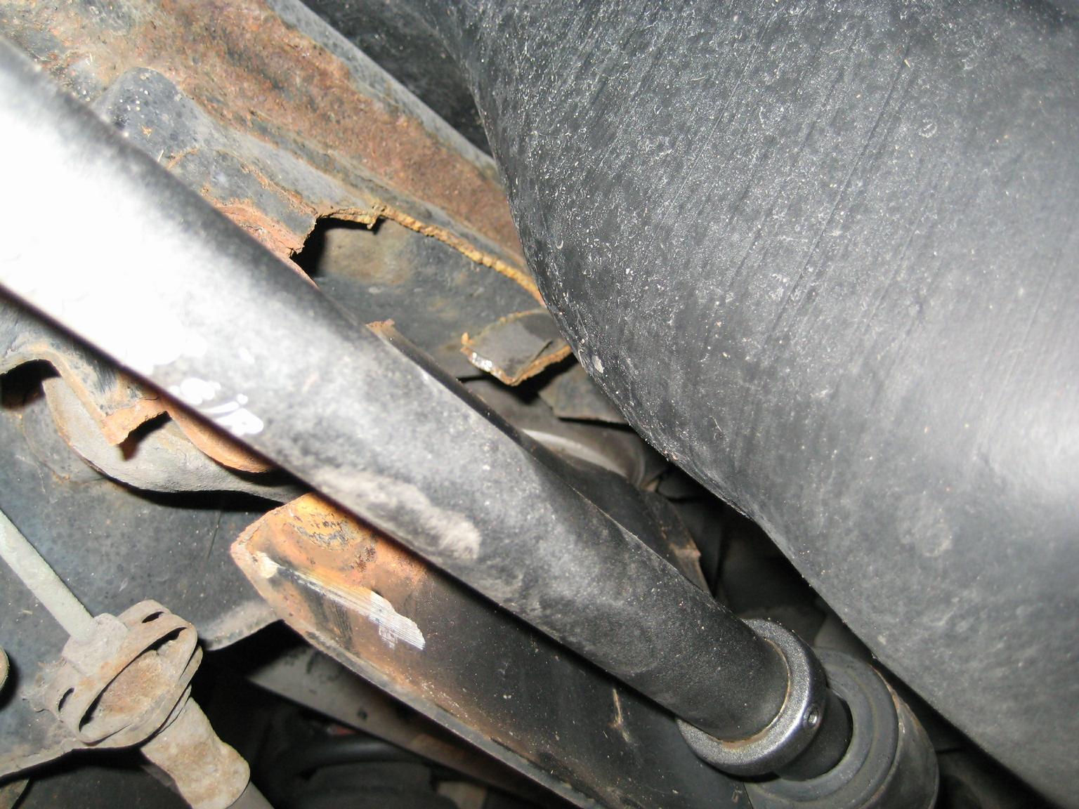

Mine was completely broken on one side - just hangling loose torn right through the rear toe fixing point.
Managed to weld it though; fortunately being the offside was quite easy to get to without taking the sub-frame off.
Then I took it to MRC pretty sharpest to fit the stregthening brackets - they thought my welding was ok.

Oh - and here are the pics
and completely welded
Toe repaired
Torn and hanging
