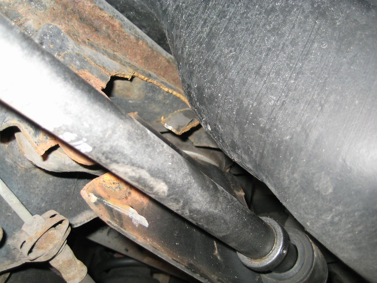

You also need to check around the rear toe adjustment bolt as mine had also cracked up through the bracket from just beneath the bolt to well above it meaning you then need a new subframe as mine did, its almost impossible to weld this area!
MRC for the brackets or make your own as I did. Easy bolt on job though.

Doug_S2 wrote:it is only going to get worse so get that welded asap and support brackets on there to stop it happening again.
I'm going to look into getting it welded one day next week, just gotta find someone who can do a decent job.....
Can you still supply the support brackets Doug or can you get them? I'm due a good health check aswell so maybe could tie it in together?

tdiquattro wrote::( 2000 facelift, stiff, fat......
:) 6mm metal plate and some less than attractive welding, £30, job done. (same the other side)
That's a good price you paid for the work you had done. I've been quoted £100 to have the cracks welded and a plate put on each side similar to tdi's.....
Does £100 pound sound steep or did tdi get a bargain job done.....
Also would i still need to fit the brackets or would the welded plate be enough?

Does anybody know if the welded plate will be enough without fitting the bracket's?

My subframe has gone too! Oh dear this is gonna hurt the wallet......
Anyone got a spare subframe for a saloon pre facelift?

KayGee wrote:My subframe has gone too! Oh dear this is gonna hurt the wallet......
Is it gone that bad it cant just be welded?

Find out Friday, hopefully can be welded and strengthened with some support plates.

Offside just started knocking - more than a bit broke? :cry:
Offside rear banging in the wind

Fixed now, suspect the tyre idiots that fitted the Dunlops did it.
I thought the tyres were shockingly bad since never felt planted since they were fitted in March..........
However now the subframe is fixed they feel 300% better. Whats the betting they jacked the car up on the ARB mounting plate?
