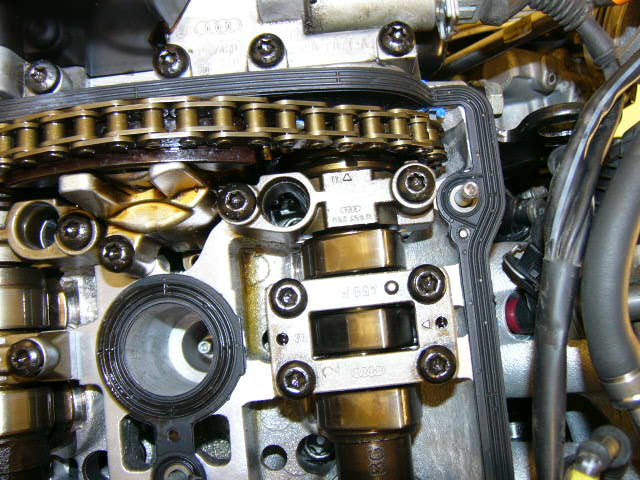

I have just fitted some 2,8NA head.. I have used my S4 cams, chain and
chain tensioner.. But one of the marks dosent fit 100% to the mark, after I have turned the engine. Is this okay, or will it fit when there is oilpressor on the chain tensioner? SORRY but dont know all the correct words to tell you the problem :lol: But let the picture talks :shock:

the arrows dont line up 100% it looks about right from the photos

quattronutter wrote:the arrows dont line up 100% it looks about right from the photos
I got 16 chain, something :oops: .. (Dont know the word) :lol: Between the marks on the cams.. So it must bee okay..

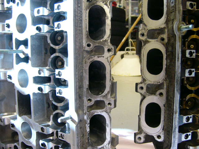

so whats the benifit of fitting th 2.8 heads?

h8cak wrote:so whats the benifit of fitting th 2.8 heads?
Maby this :shock: 2,8 om the left and S4 on the right

if you have 16 rollers (thats the parts that hold the links together) between the marks you are ok.

also the arrows should line up with each outer part of the square notch in the cam
Wow. So more power with the 2.8 judging by the hole size?

imolas4uk wrote:if you have 16 rollers (thats the parts that hold the links together) between the marks you are ok.
I do have 16 rollers between the marks on the cams.. So it must be okay.
