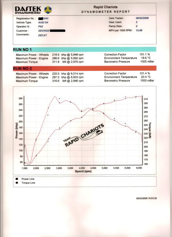

interesting to see a printout from another dastek r/r for a stock engine, had mine done on one in march, the plots are pretty much the same on yours as mine, with the high and low points on the graph in the same places. http://i49.photobucket.com/albums/f261/ ... age1rr.jpg
would make sense if it was something to do with the n75 i would have thought. would the timing effect boost reading at all?

GHH, was yours standard when that RR was done ??
My torque is quite low compares to yours.

AdamS4 wrote:GHH, was yours standard when that RR was done ??
its standard bar 710N's, fully decatted stock system, RS2 plugs and some holes in my airbox 8)
