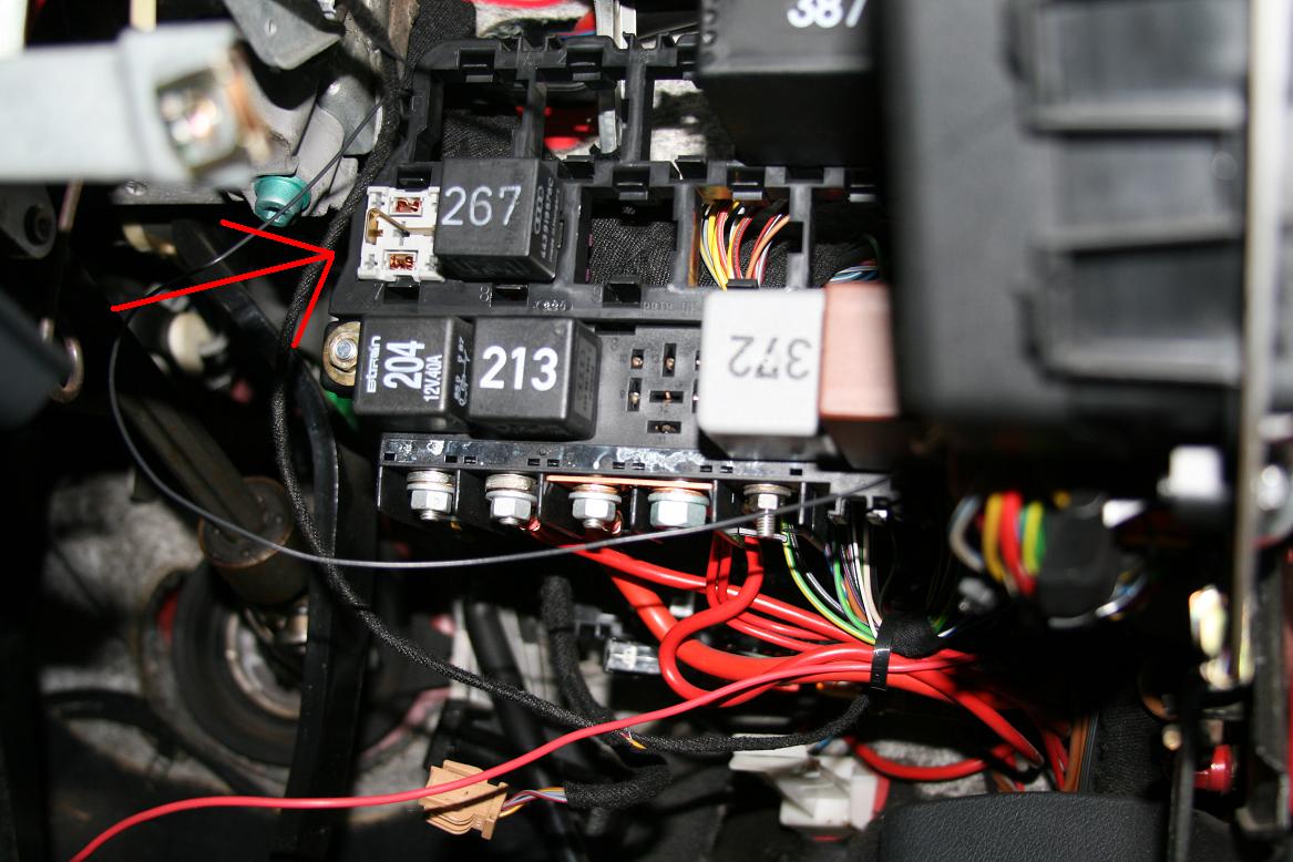

Post by g60bv » Tue Apr 15, 2008 8:01 pm
ok got the wire in. found a load of other stuff under there. a charging lead to something. see pics.
also looks like a relay is missing. any ideas.?
