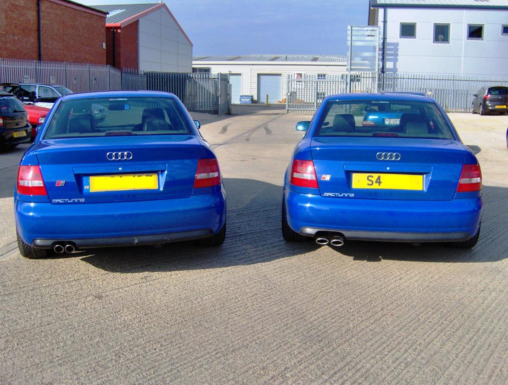

to add to the above.
the RS4 tailpipes sit lower than the S4 ones so once installed you really need to fill the cutout to make it look pukka, here's a pic comparing the two and you'll see what i mean
mrc twins.jpg (224.46 KiB) Viewed 1346 times
Dave

Thanks a lot... that's what I was looking for. The RS4 actually doesn't look that good?! Sit too low! Not gonna get it then!
