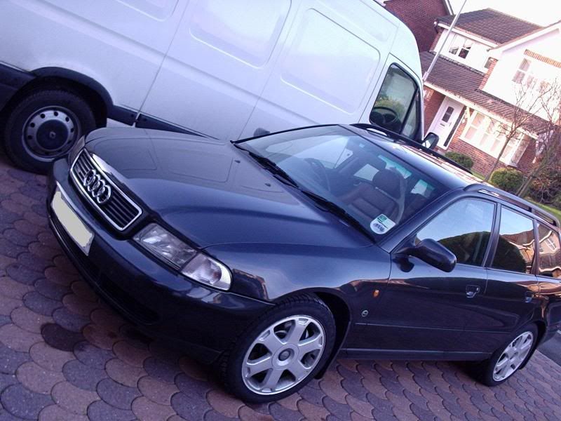

Appologies if I mislead anyone, I was only stating what I was told when I bought the car. That he wished he had bought the full car and transplanted more bits and bobs as it would of made his life much easier.
It may have been due to it being a 96 P Reg maybe? I know after looking into it he ended up fitting the DTA to get it all running correctly.
The car looks quite standard as you mentioned above, apart from the S4 wheels. Certainly suprises some people.
Insurance was a not that difficult to arrange to be honest. Just went with someone who specialises in modified cars.
Some pics
Some pics
