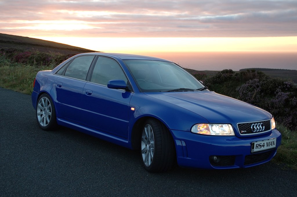

So, I have finally done it ...
As some of you know I replaced all the internals with RS4 parts.
My B5 S4 Saloon has now had the RS4 bodywork completed. Which includeds RS4 wings, bonnet, bumper, grills, doors, skirt and finally, rear quarter panels!
I will get some pictures soon, but I have to say I am very impressed with the results...

Here is a list of the major items replaced
RS4 Interior including recaros and roof lining
RS4 Engine/Gearbox/Clutch
RS4 Brake system
RS4 Wiring loom
RS4 Air bag and control unit
RS4 ABS pump
RS4 Prop shaft
RS4 Instrument Cluster
RS4 ECU with MRC custom map
RS4 ESP computer with steering angle sensor
RS4 Oil cooler and radiator
RS4 Steering wheel
RS4 front/rear hubs
RS4 Drive shafts
RS4 255/35/18's
Bilstein PSS9's
I will try to get the pictures up by the end of the weekend ...

Here they are ... enjoy ...
More pictures at http://www.rs246.com/modules/pnCPG/Copp ... ?album=366
3 Car Nose.jpg (128.5 KiB) Viewed 1571 times
2 sunset car.jpg (125.67 KiB) Viewed 1571 times
Wheel
1 Wheel.jpg (135.23 KiB) Viewed 1571 times

That is THE B5 RS4 saloon that Audi should have made - awesome!

Fantastic. Not only do you have THE car, you have THE roads to use it on too!

that looks so good!!!!! well done
makes me want to get my rs4 bumper even more now!
