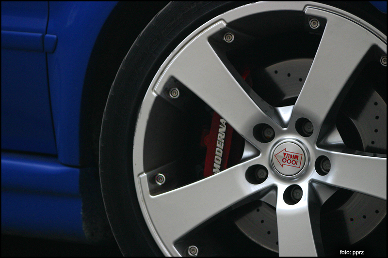

Oh, and to show off a bit, here are some pics of my car. I will post updated pics later, the car now has RS4 front bumper aswell...

don't know anything about mods but your mota looks good and pimped. what body kit is that and how far have you lowered?

rear is custom widebody, the front in the pics is also custom modified from original S4 front. But after a slight accident i decided not to fix the front but go with the RS4 one instead. No pics of that currently. As for the lowering, the car has H&R coilovers.

It looks superb Renarl, and I bet it looks even better now you've got the RS4 front bumper - looking forward to the pics...
What wheels are those please?

CliveH wrote: What wheels are those please?
love those wheels - really suit the slammed widebody avant. think theyre mille miglia avs

The wheels are Mille Migila, that is correct. They cost about 325 USD per wheel here in Estonia, so they are not too expensive and look great. I am also pretty happy with the choice of the wheels to match the body:)
