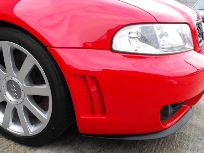

Was back at MRC for a detail of a very nice Misano Red B5 RS4 Avant.
Process & Products in a nutshell....

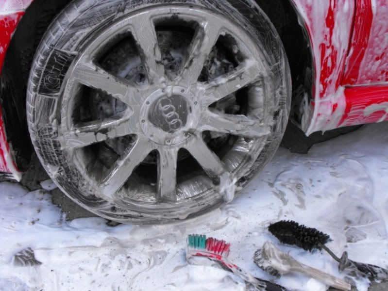

* Foam with - Nilfisk Washer / Foam Lance. Foam left to dwell for approx 20mins.

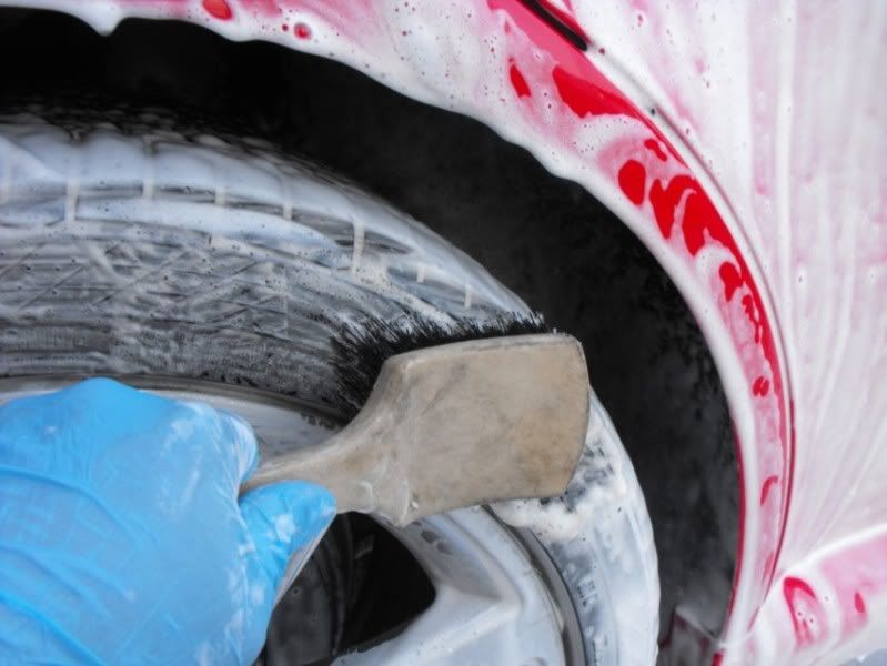

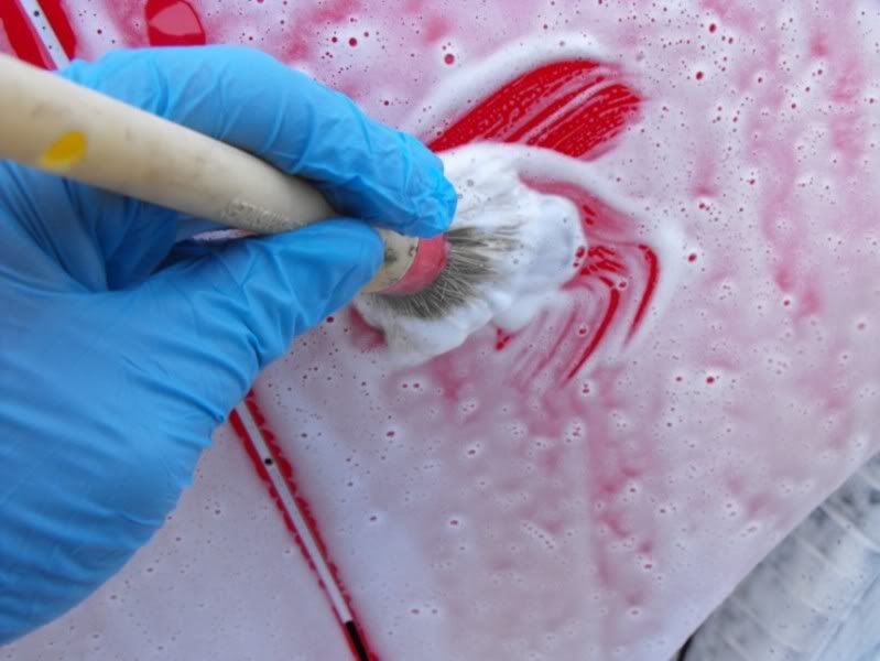

* Whilst foam dwells - clean badges, trim, grills, window rubbers with detailing brushes using the foam. Arches scrubbed and wheels agitated with brushes.
* Rinsed
* Badges, trim, handles, rubbers, grills finished off with APC and detailing brushes
* Washed with ONR and MF Noodle Wash Mitt
* Wheels decontaminated with Tar Remover, IronX

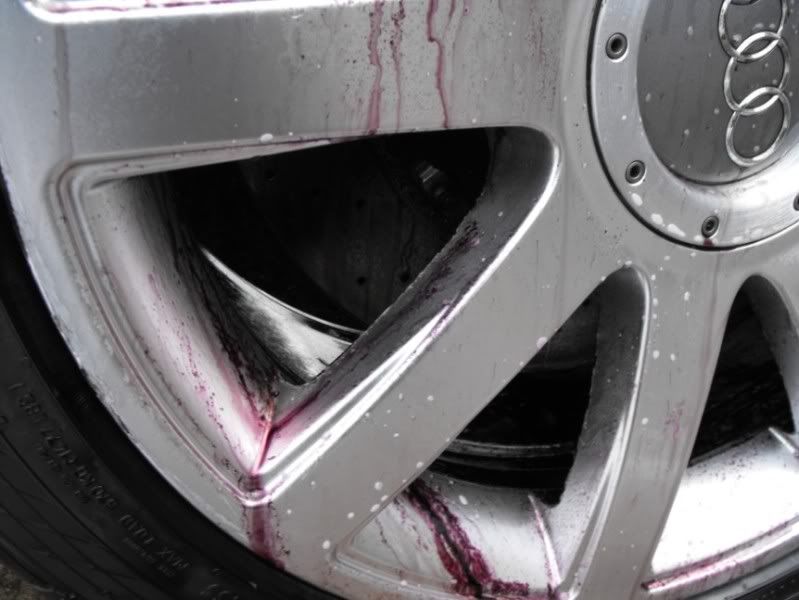

* paint/ glass decontaminated with Tar Remover, IronX
* Final Rinse
* Body Clayed
* Final wipe down with ONR as QD

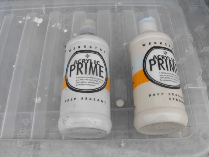

* All Shuts washed down with ONR and cleaned/polished/sealed wth Jeffs Werstatt Prime Strong using an MF Pad
* All Glass and badges, chrome trim cleaned/polished/sealed wth Jeffs Werstatt Prime Strong using an MF Pad
* Wheels cleaned/polished/sealed with Jeffs Acryllic Prime Strong. Protected with FK1000P
* Tyres dressed with CarPro PERL
* Arches dressed with CarPro PERL
* All Black Trim/ grills dressed with CarPro PERL
* Paint swirls taclked with single pass of Menz 203, using Menz pads.
* Paint Clean and LSP prep was Jeff Werkstatt Prime and LSP was FK1000P.

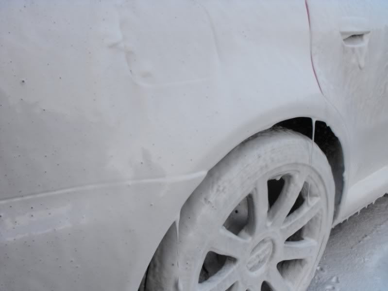

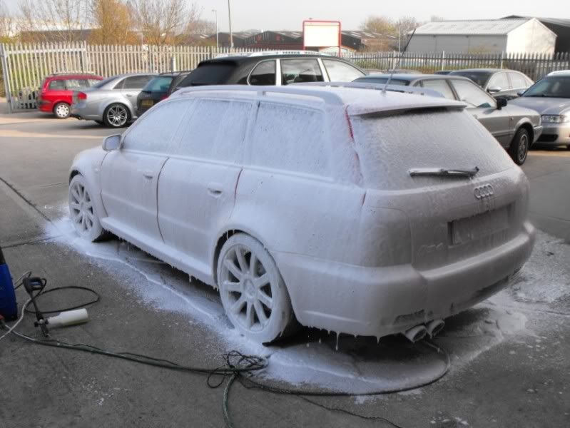

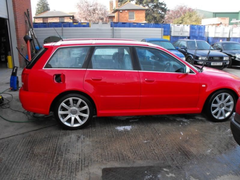

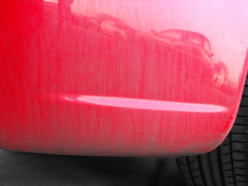

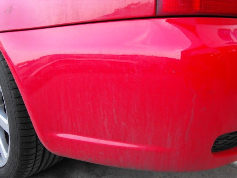

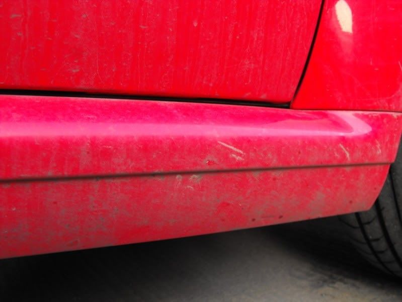

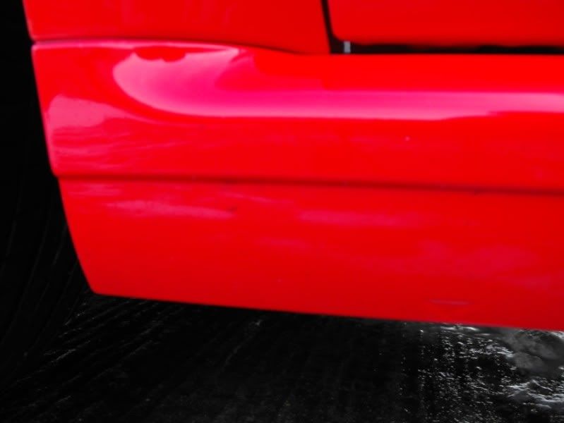

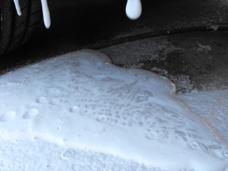

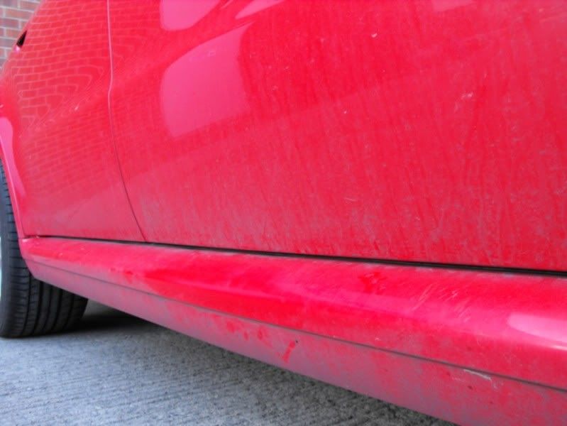

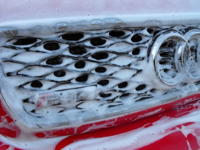

Foam doing its magic again, >90% clean giving an almost touchless wash :thumbup:

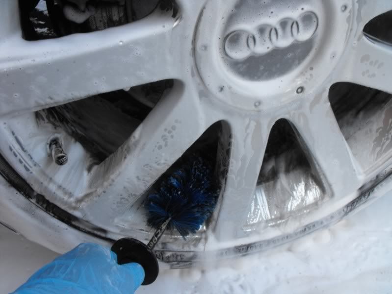

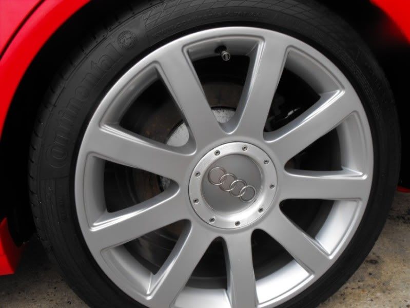

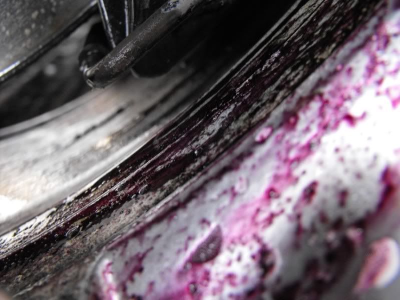

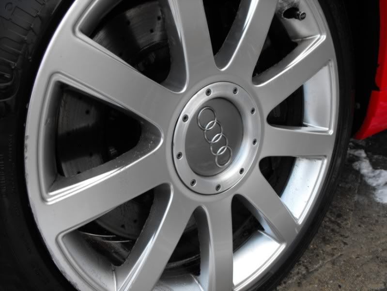

Cant grumble at these wheels really and no wheel cleaner product used, just foamed, agitated and rinsed, so there was spme bits missed but not bad.

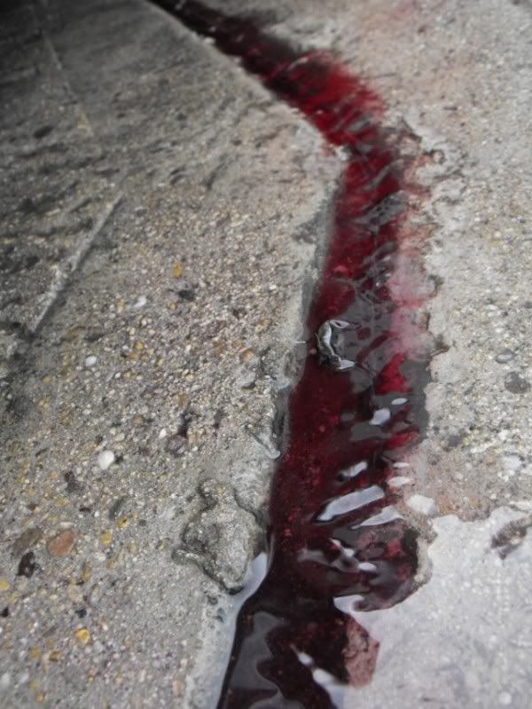

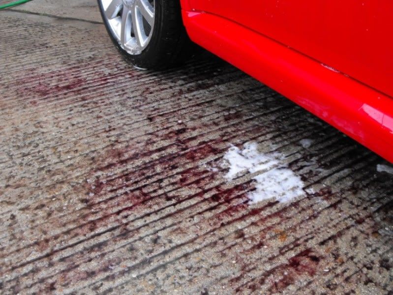

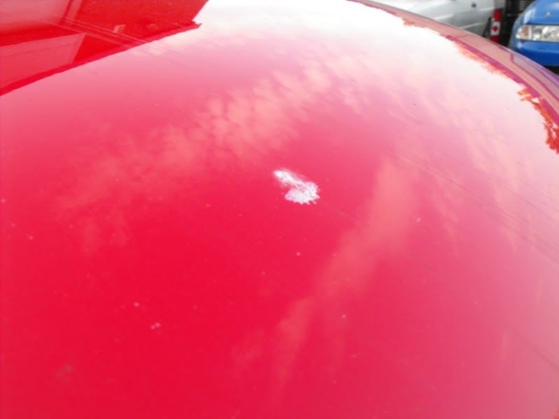

Tar Disolver applied to areas with a brush, spot treatmemt was not an option, it was like the car was wearing a spray-on layer of tar, was absolutely covered on the stuff :shock:

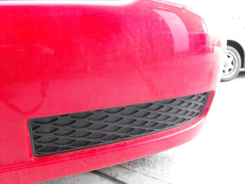

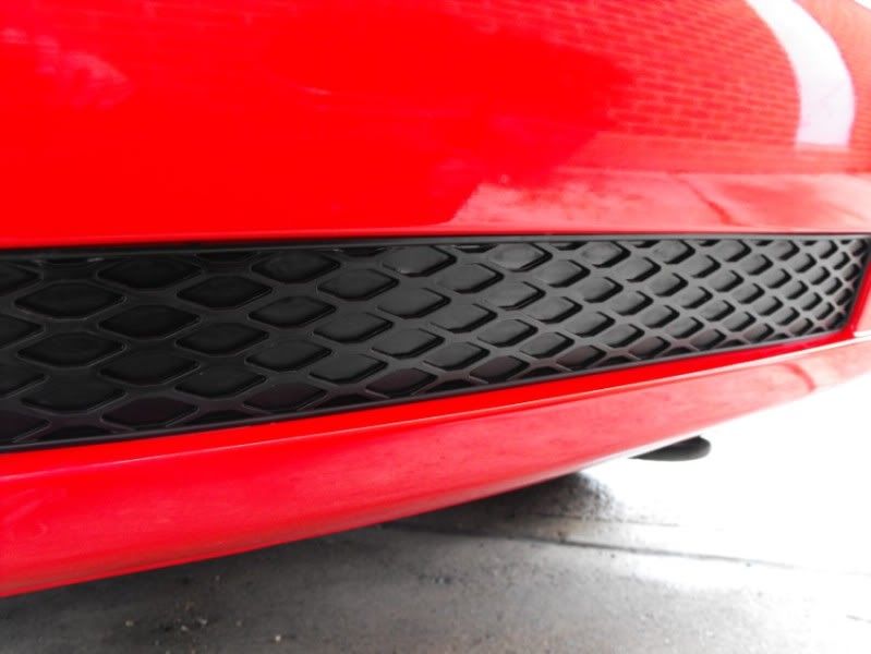

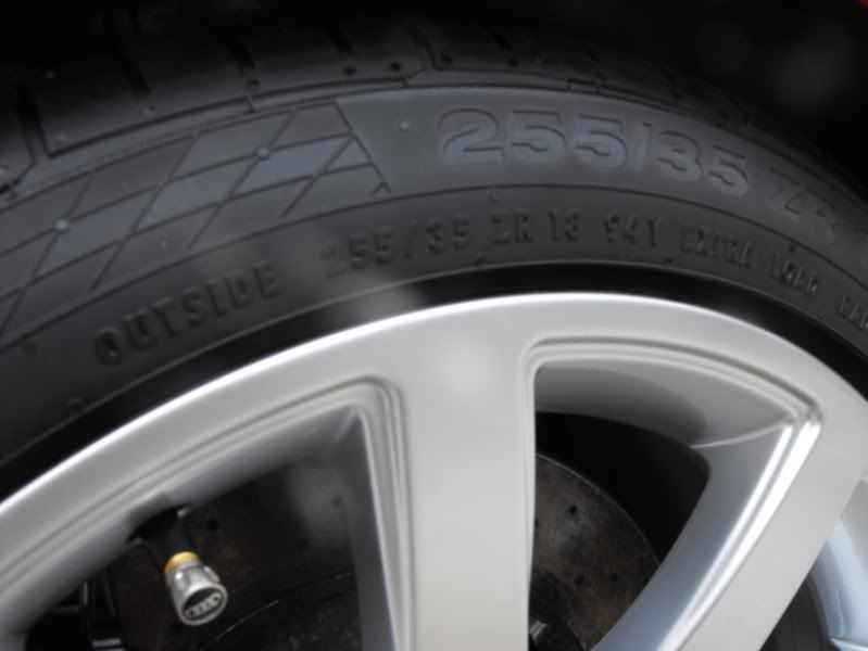

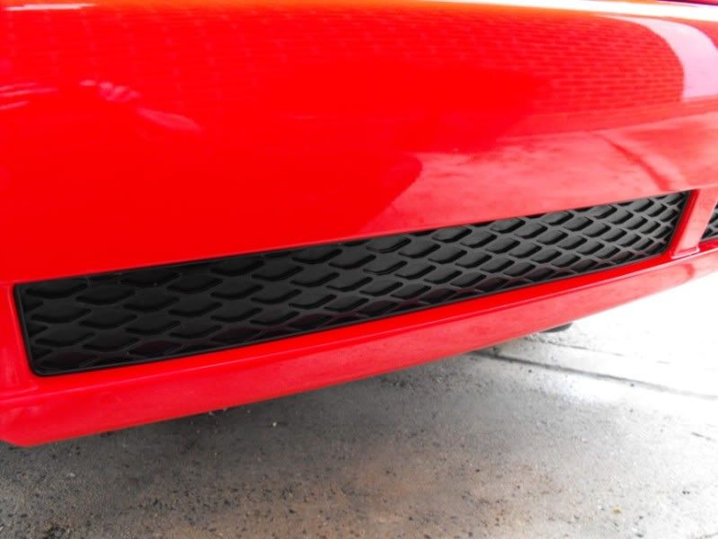

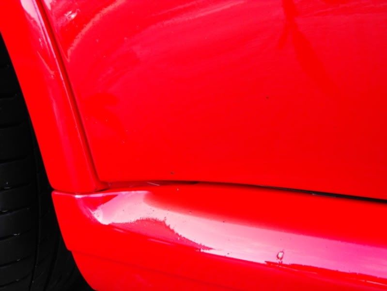

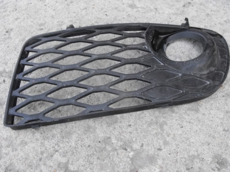

PERL amazes me on Plastic grills/ tims, here is a before shot, take a look at afters. Time will tell how durable.

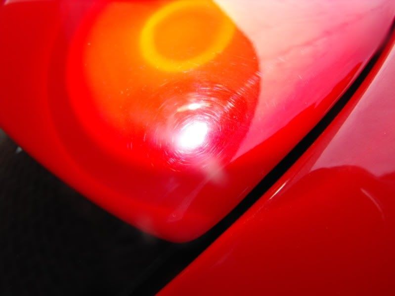

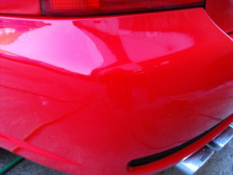

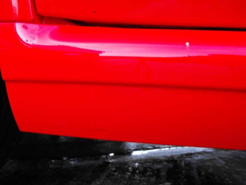

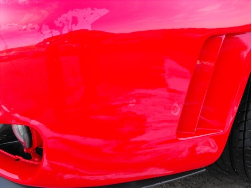

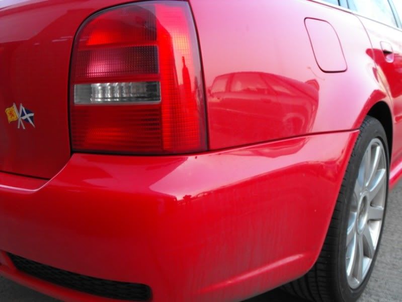

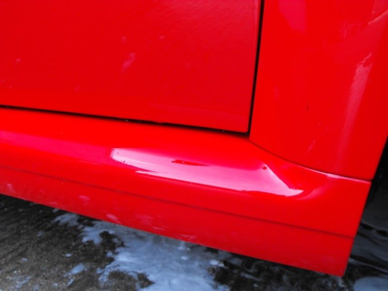

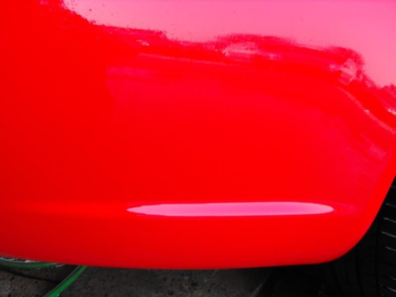

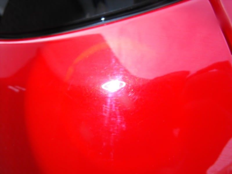

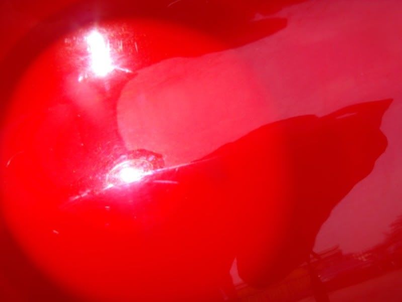

Nasty Swirls

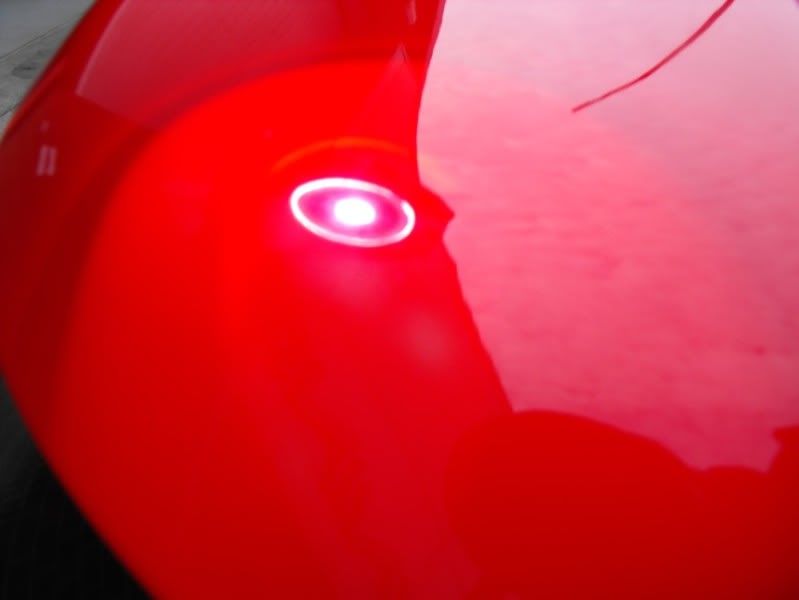

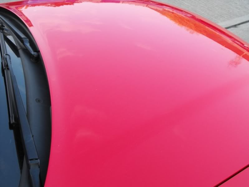

Swirls not gone, but signicantly reduced after single pass of Menz 203s

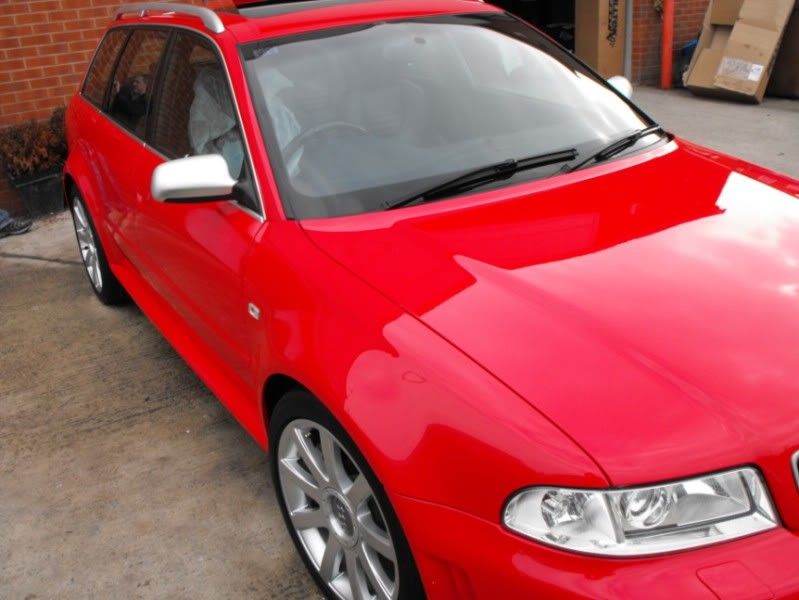

Apologies for some of these afters, I think has camera on a wrong setting as the ones outside havent come out well, I deleted loads and these wte the best of them

Another great job Steve, The inside wheel work was well worth the effort, and the foam.........really impressed with how much grime it removed without touching. I'm getting closer to buying that Nilfisk and lance every week.
