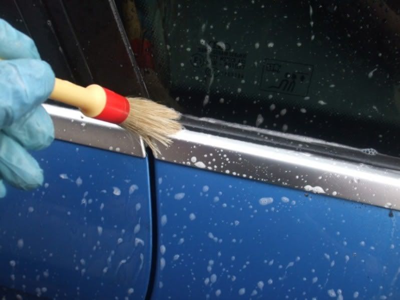

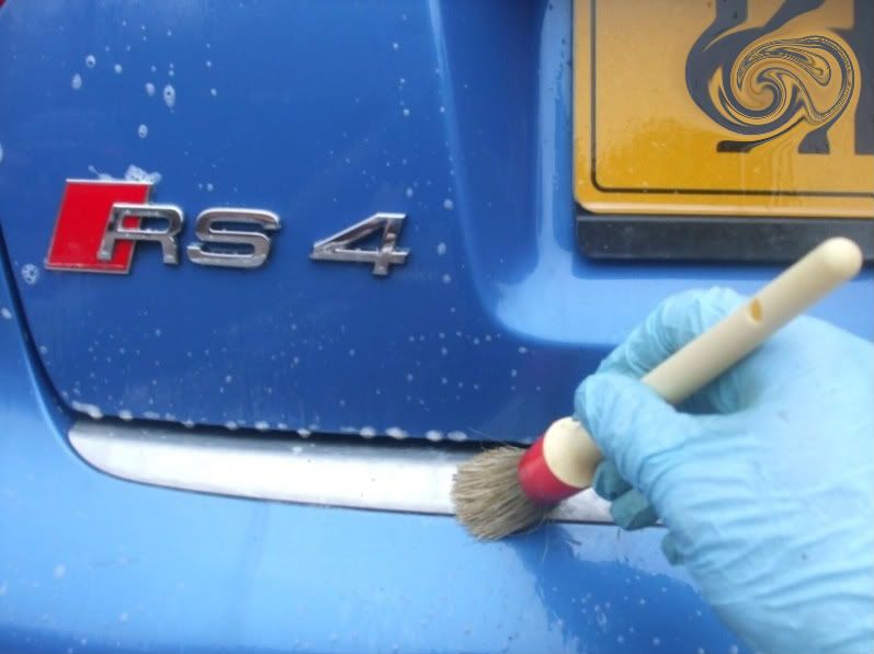

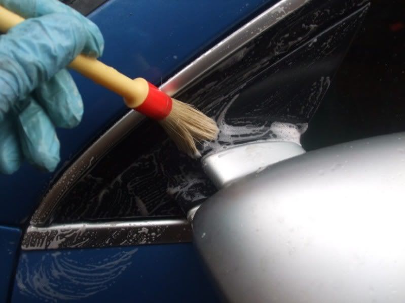

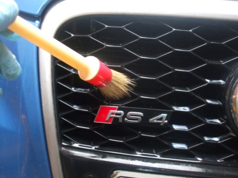

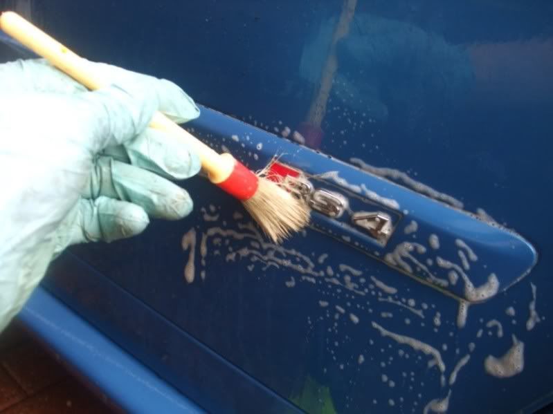

Envy brushes to agitate the badges, grills, handles, window rubbers etc using the foam

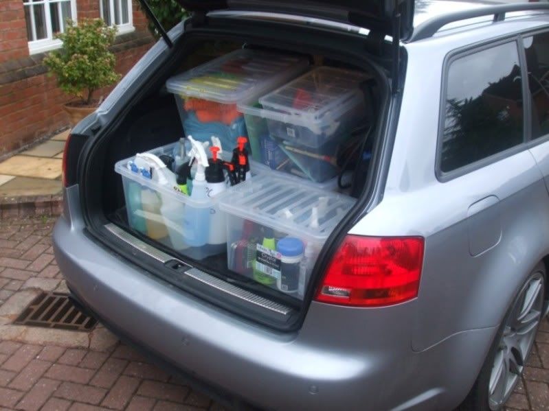

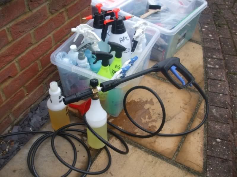

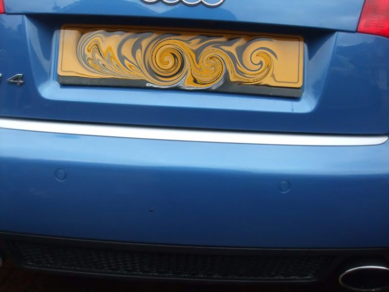

So, had a little stock up of bits before I started.... he doesnt look impressed
Loaded up the Avant

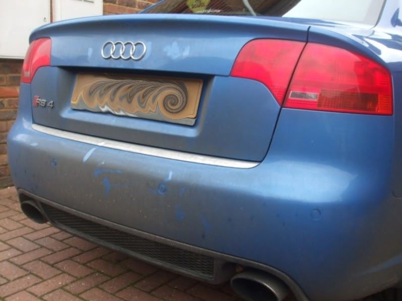

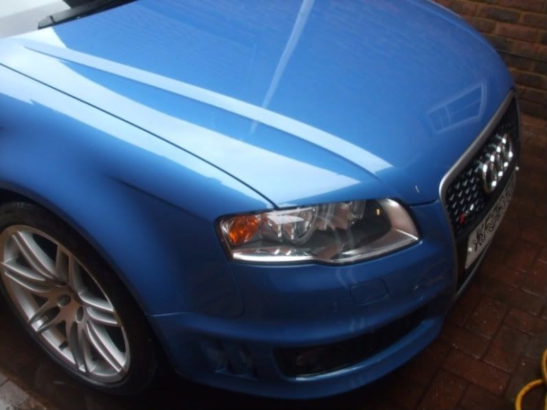

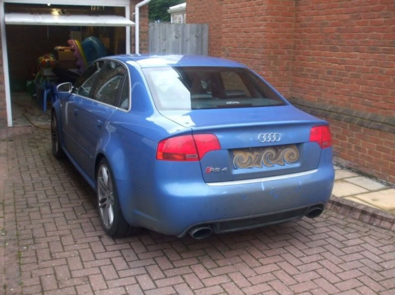

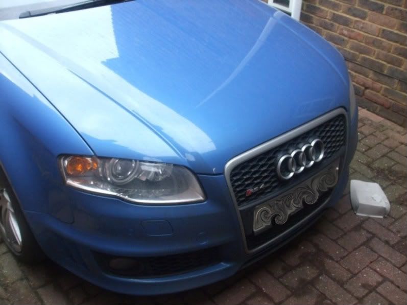

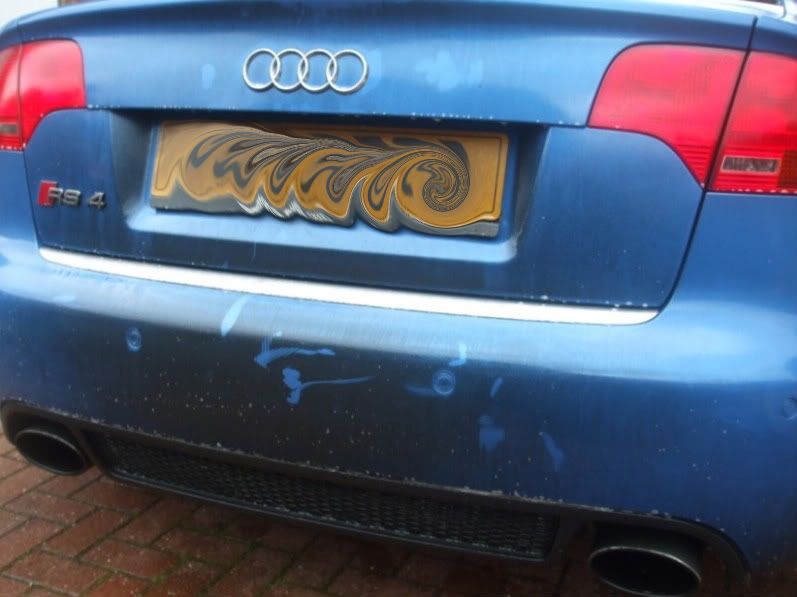

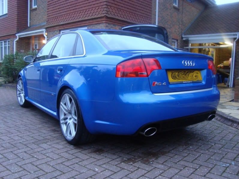

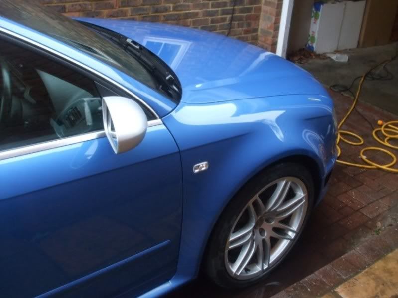

The subject of the days detail

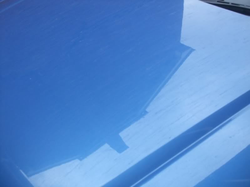

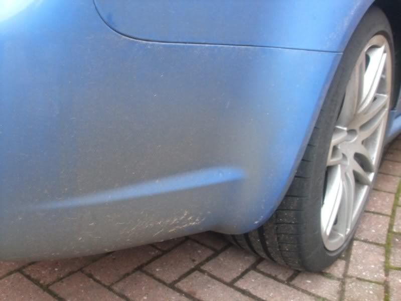

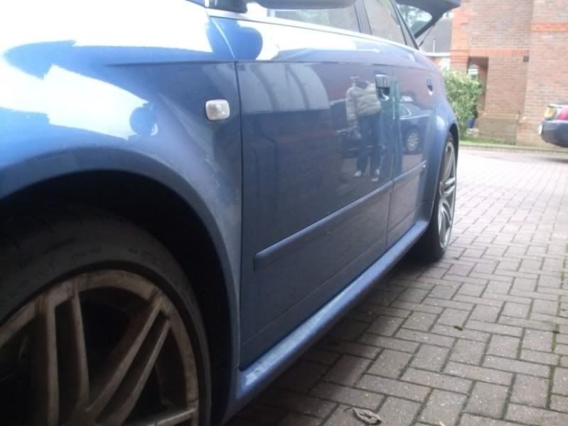

Not a lot of blue paint left on show here

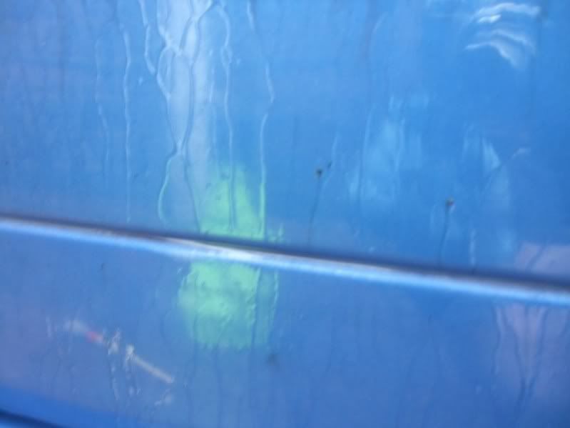

The ONR and G101 Pre-Soak

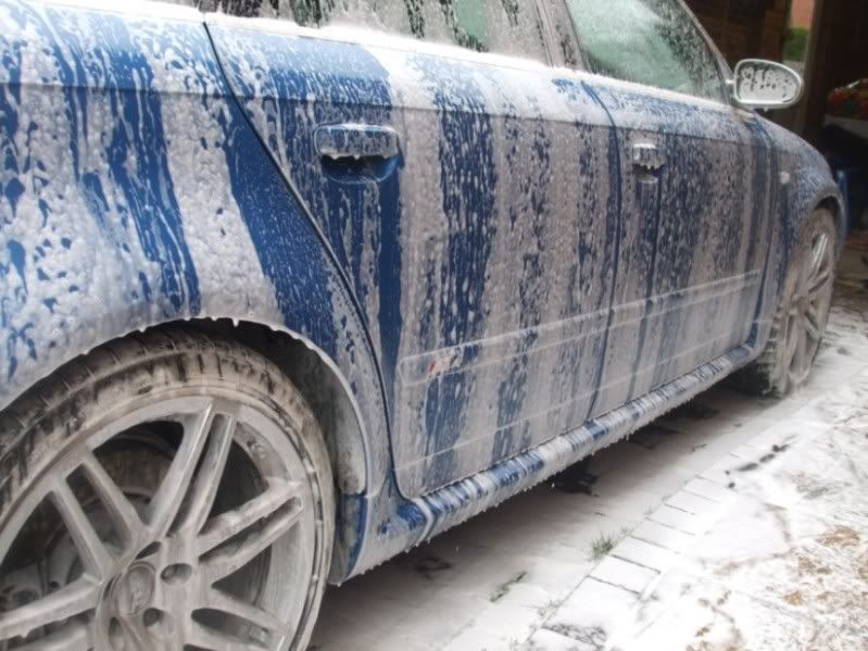

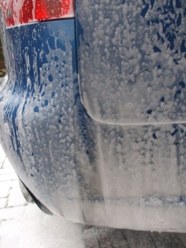

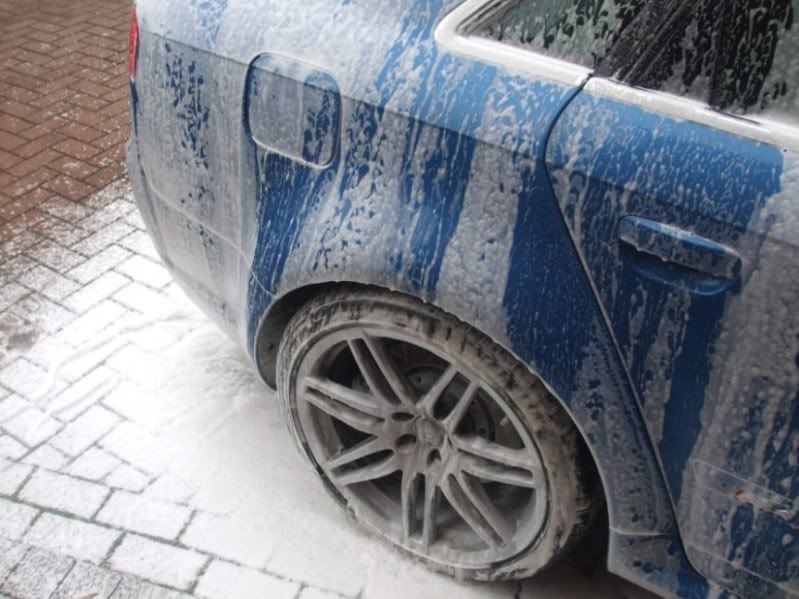

AB Magifoam and AB Foam Lance... didnt get the really shaving foam shots, these were shots after about 30 mins dwell time, maybe not clear on pics, but you could see that the grime was being actively disolved and running off with the foam.

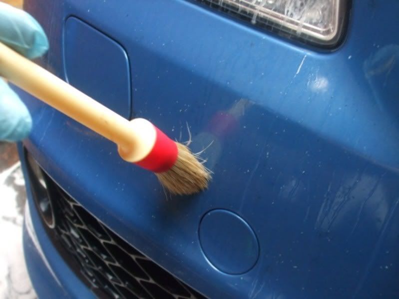

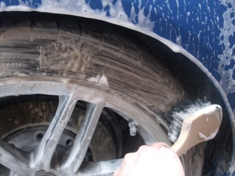

Tyres and arches scrubbed while the foam dwelled, using the foam to assist in the process
So now came the rinse phase to see if Magifoam had worked its magic and see what we had to work with.

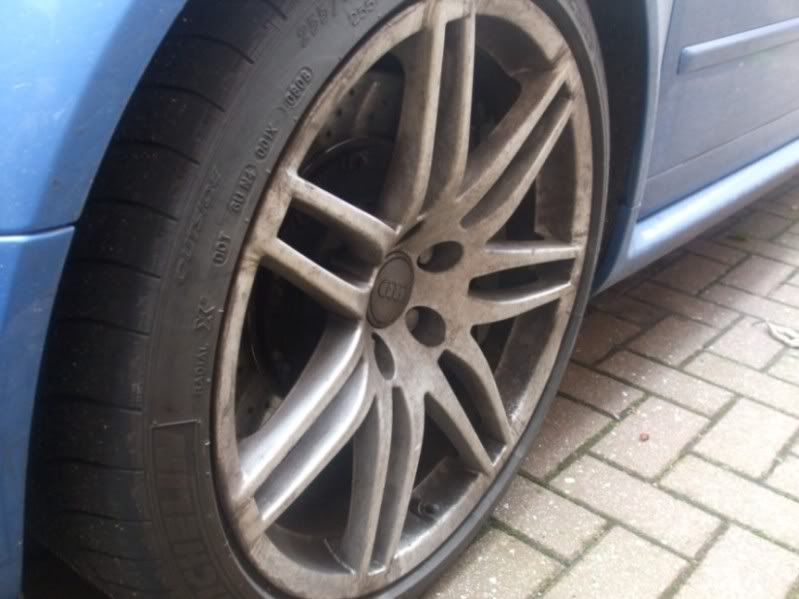

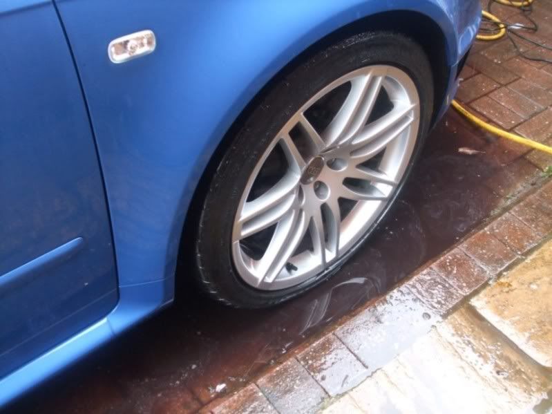

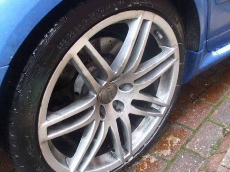

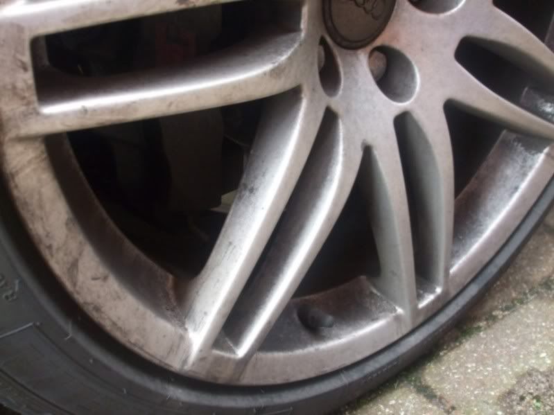

Wheels still bad but lots better than were

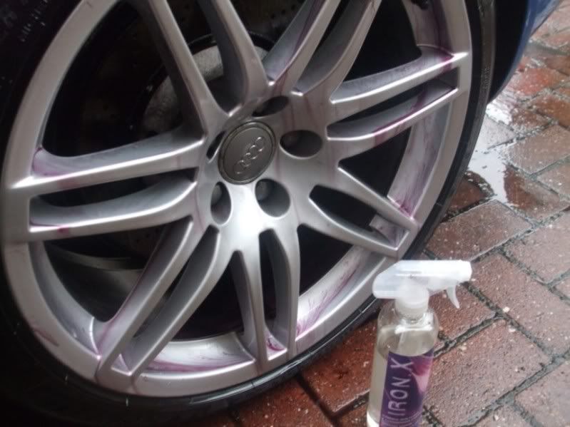

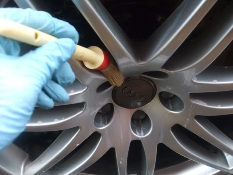

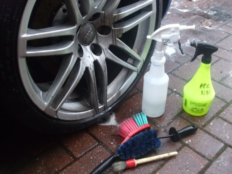

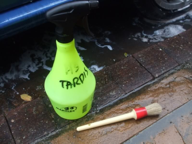

Wheels tackled with Espuma Revolution/Tardis/IronX to clean/decontaminate and Envy Brush. Tyres with G101 and Vikan Brush.
Results left with following a rinse were pretty impressive
Then applied ONR through the 2L Hand Sprayer again and left to dwell... this is in a much more concentrated ration than for a bucket wash, was more like 8oz or QD ratio.

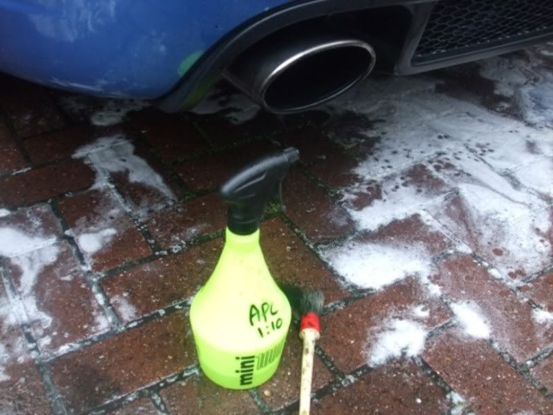

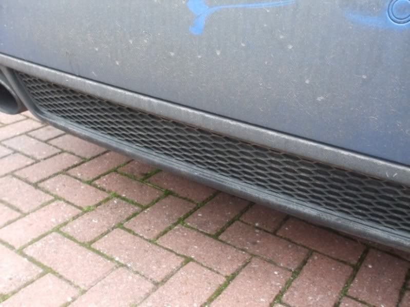

G101 APC was applied through a sprayer to some of the stubborn areas such as sills, arches, bumpers/ exhuasts to dwell. All trim, badges, grills, window rubbers, door handles etc were also spot sprayed using envy brushes used to get in everywhere.

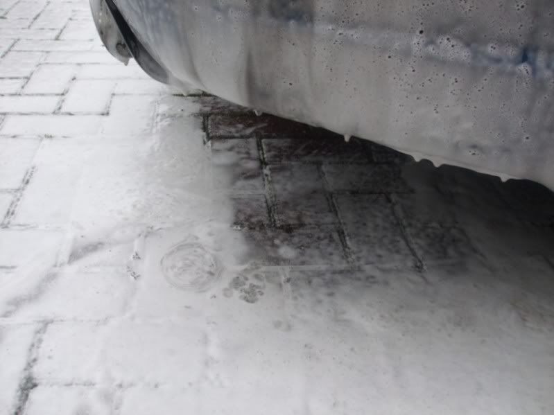

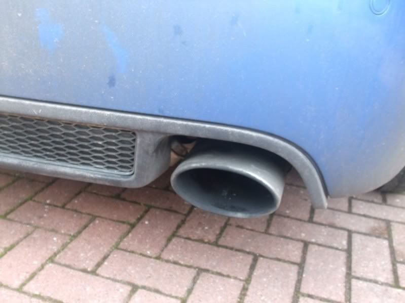

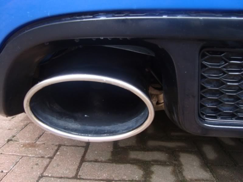

Tail-pipes were treated with more G101 to losen the grime

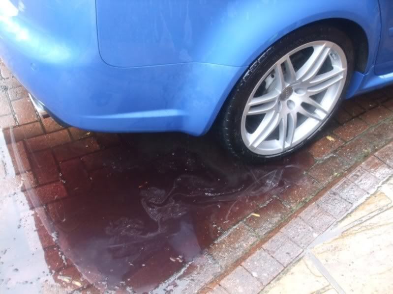

Car was then given a final rinse down with power washer and final part of the wash/clean was to ONR this time as a Drying aid and to capture any last remaining bits, ONR was mopped up and car dried using Eurow Blue Flufft towels.

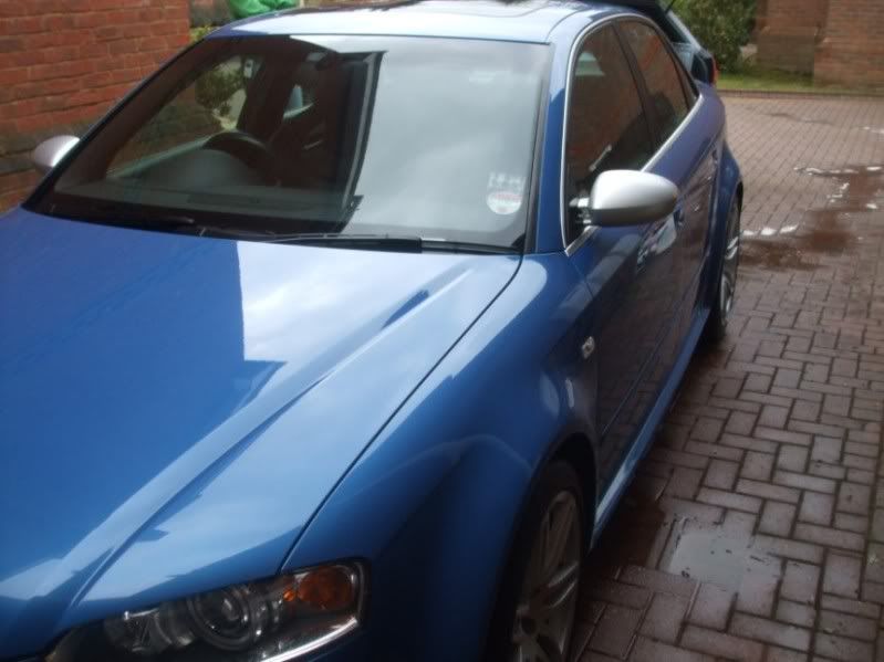

So that concuded the touchless body wash, all apart from the drying off stage. So in a nutshell it was Foam/ Rinse/ ONR/ G101 areas/ Rinse/ ONR wipedown as the drying step.

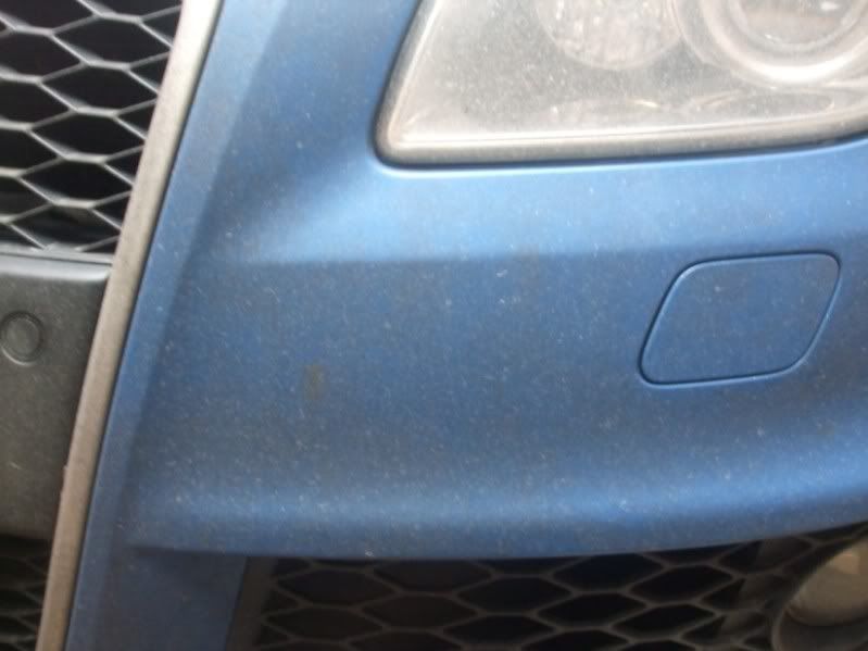

Now that the washing stage was completed, it was time to decomtaminate. At this point I forgot to take some pics so this stage was Tardis on the affected areas and IronX applied to the whole body...
I tested the IronX Soap Gel and applied to the whole car (although the IronX is not so concentrated, but was good way to get good coverage across the whole car and more economical use. The whole car was then rinsed thoroughly and clayed, but by this stage there was pratically nothing that came off with the Clay.

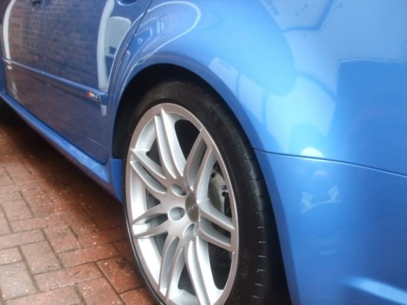

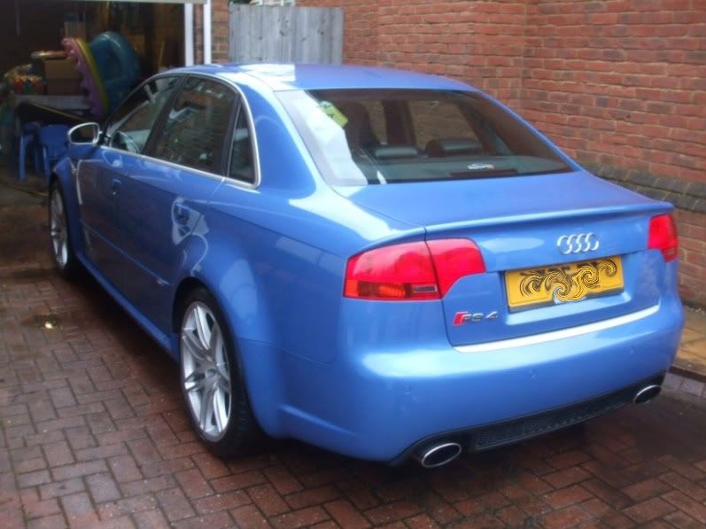

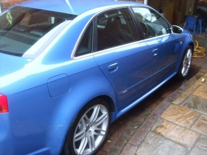

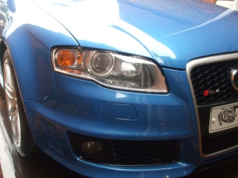

These next shots are after the final rinses and ONR dry-off. I was really amazed at the results achieved by this Touchless technique of foam and ONR and itself leaves a great shine.

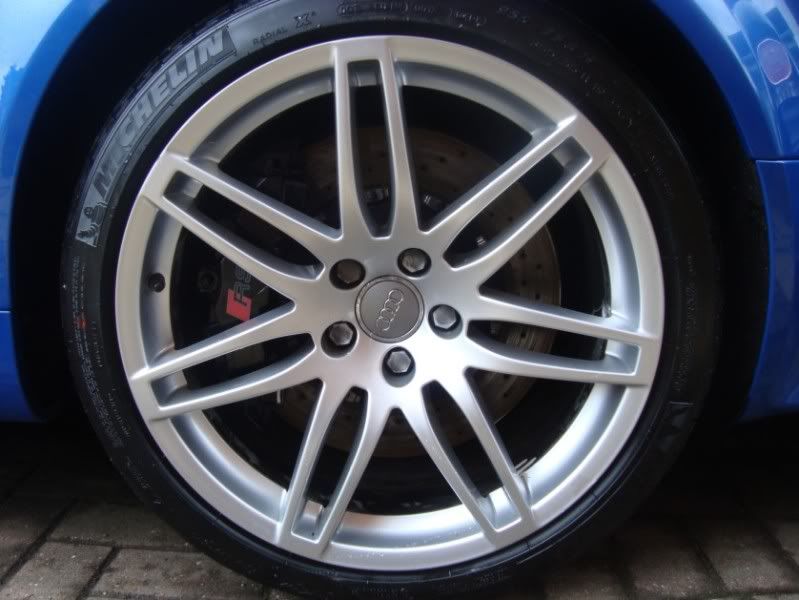

Was time to move the car out of its muddy bath water, so could polish/ seal the wheels and dress they tyres.
Wheels finally polished with Prime Strong and Sealed with Colinite 875.... wanted to test this durability over a dedicated wheel sealant such as the PB Pink. Tyres dressed with Espuma RD50

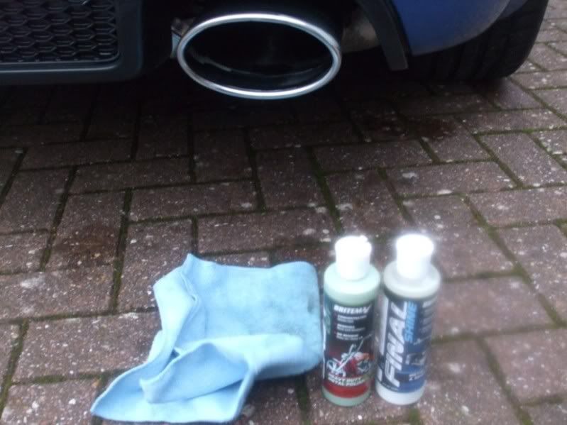

Tail-pipes were then polished and sealed with Britemax twins

So there we have it, 6 hours worth of detailing done, and one very happy RS4 Owner 8)
