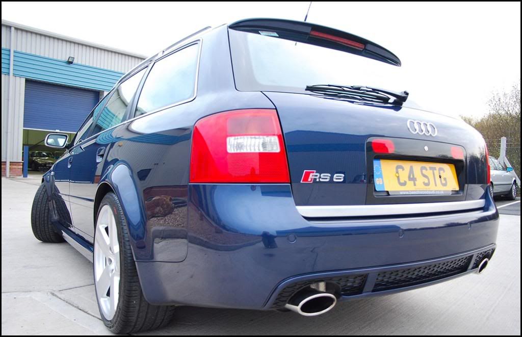

Here's a few recent cars that I've done.
my RS2
and my Audi 80CD which took best of show at ADI 2007 (pre 88 class)
my Audi 100

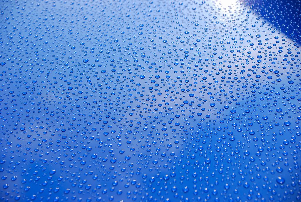

oh, and a gratuitous beading shot, well it's Noggy blue (RS Blue if being politically correct!!!!)

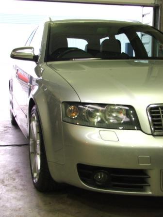

Post by chunky79 » Sun Dec 16, 2007 11:54 am
MODS. I really don't want to upset anyone hear by saying it was my car that was done by coxy due to him not sponsering the site. If i'm braking the rules please take this post off.
Got to say he did a great job. Unfortunatley my pic's/ camera don't do the car or the work carried out any justice at all!! Wish you'd remembered yours now alistair.
The car had scratches don't both sides of the car (full length) and a really bad one on the drivers side rear wheel arch. Apart from the one on the wheel arch(you really have to look close) you would never know the car had any marks on her. Not bad for a car with almost 70K on the clock.
If you want to do a write up to say how much work you had to do please feel free.
