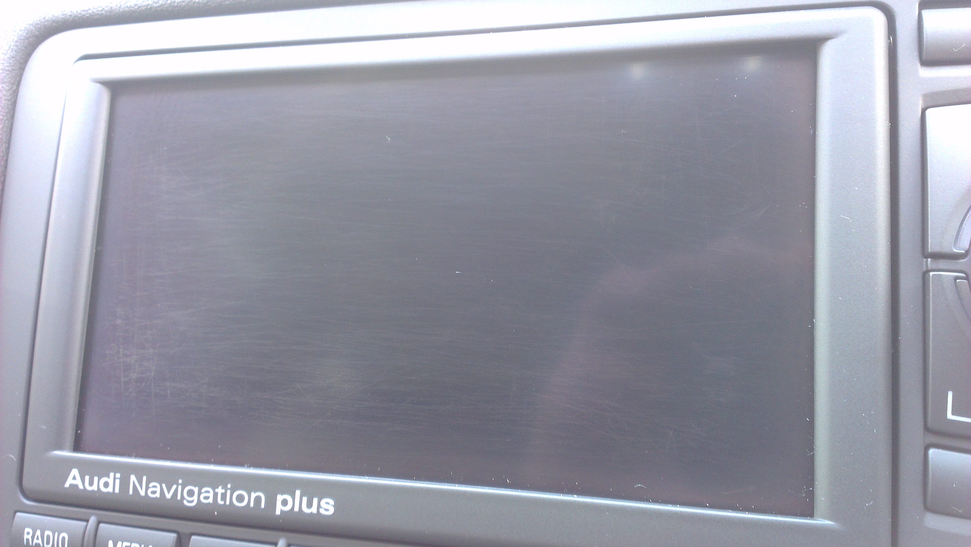

Did a bit of trawling as my wifes sat nav screen has started to get scratched this i found out was the anti glare coating on the sceen after much searching i found that Meguiars Plastx was gave a really good result

Looks good!
Did it remove the the anti-glare coating?
I had the same issue, but I was concerned about increasing glare if I polished it, so I got one of these http://www.amazon.co.uk/gp/product/B004ZXZK4O/ iPad anti-glare screen protectors and chopped it down to size.
I was mostly trying to get rid of the glare (which it seems to have done) but it also seems to have hidden the scratches nicely.

Yes It did remove the anti glare but it doesn't seem to be a problem the screen res is still fine even in bright sun light
