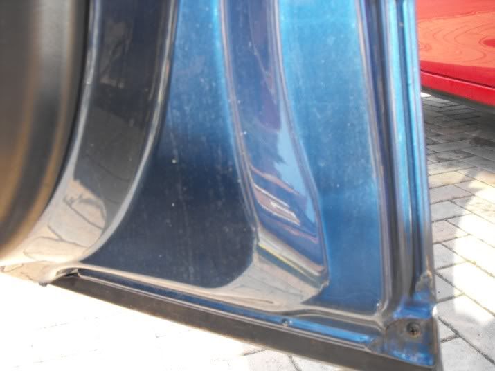

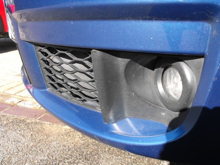

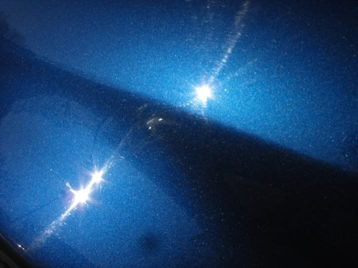

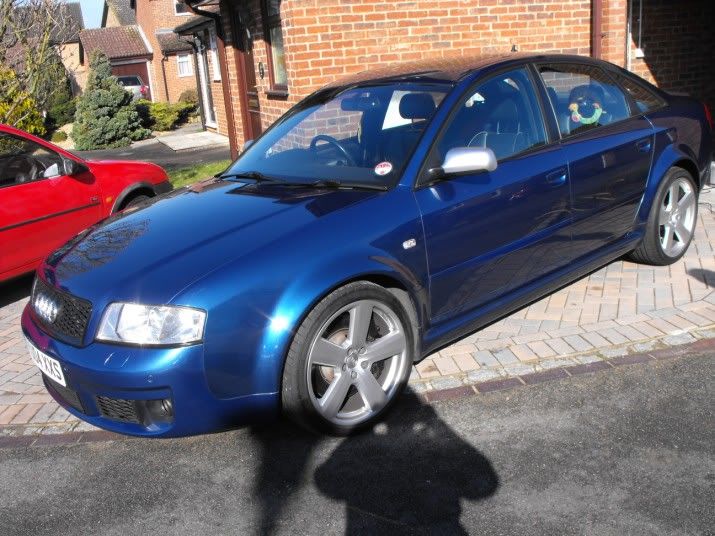

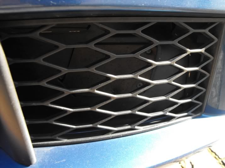

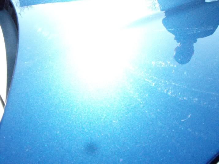

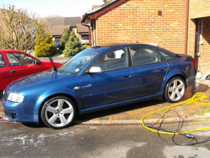

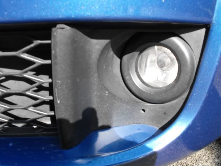

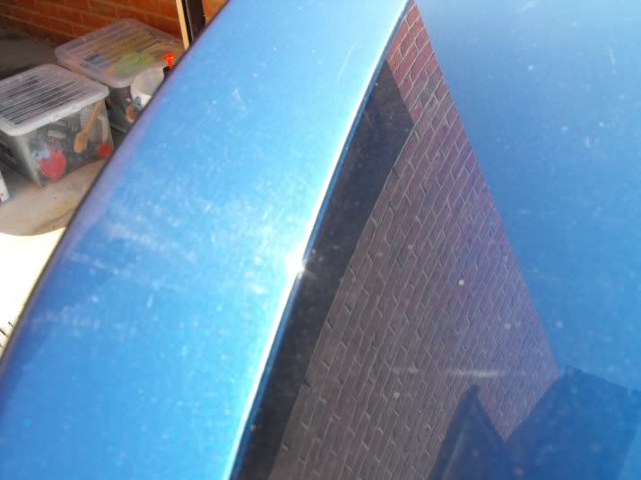

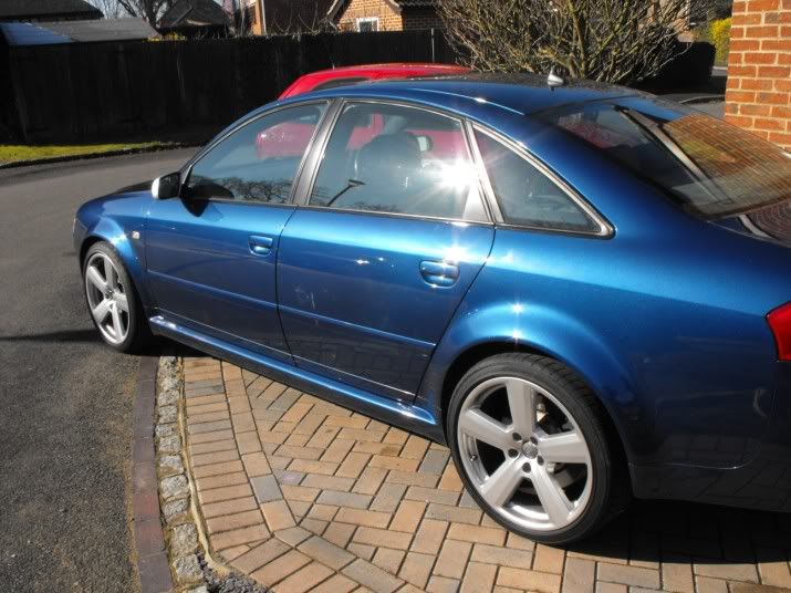

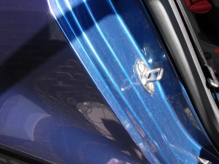

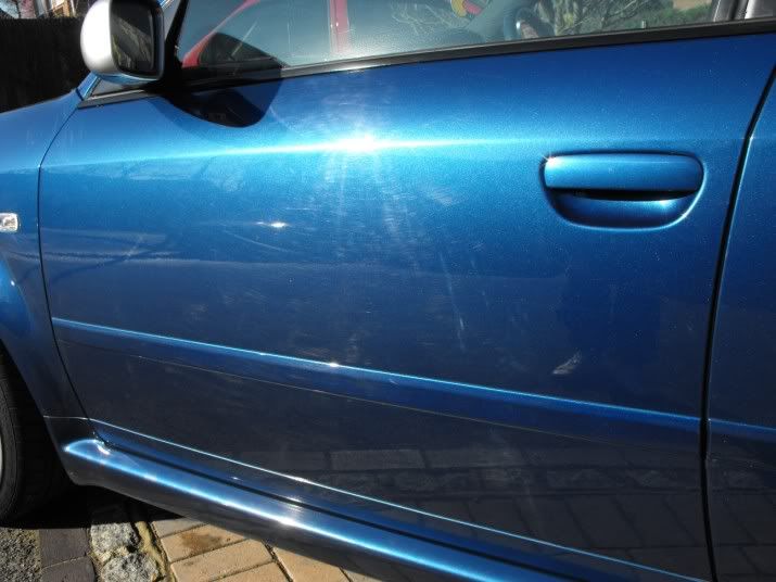

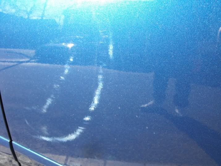

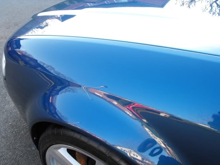

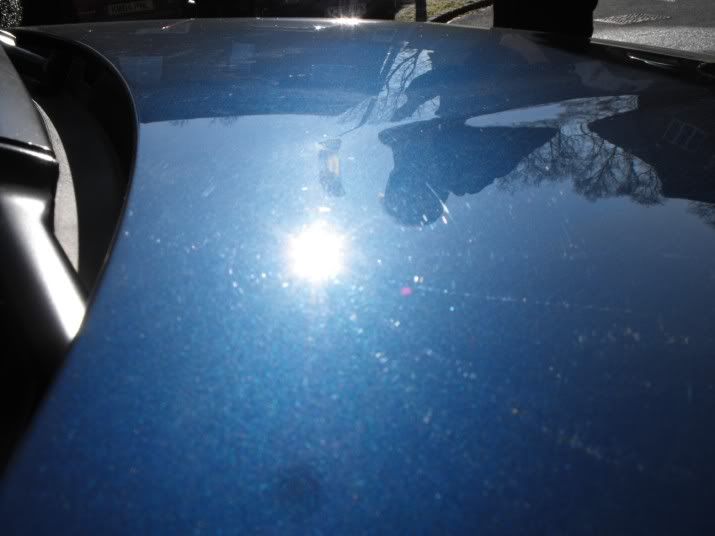

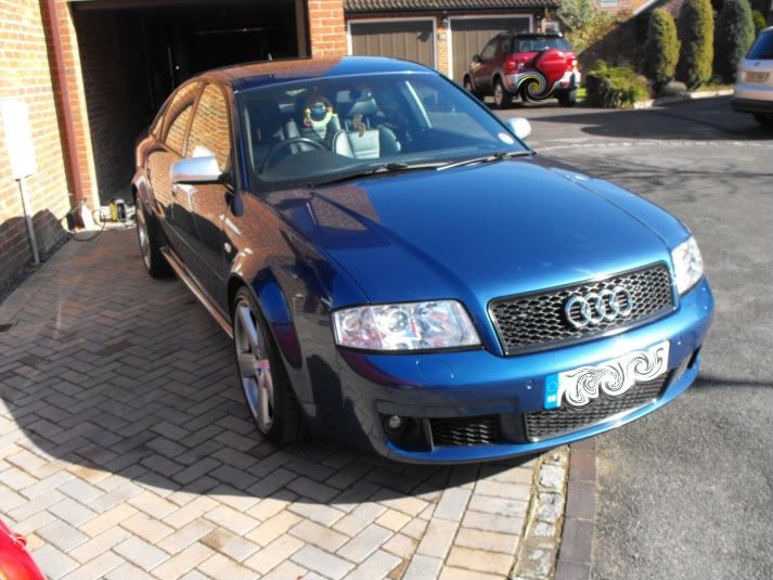

Some before pics on arrival....
Swirl, hologram and marr city :shock:

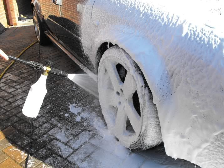

Onto the Detail

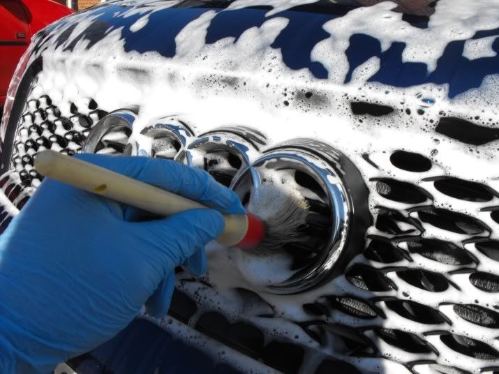

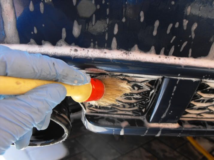

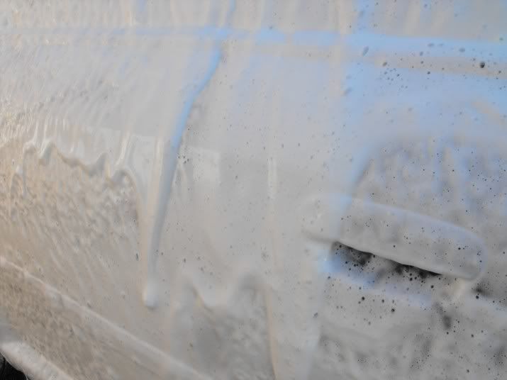

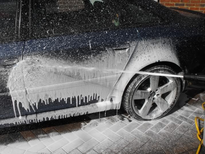

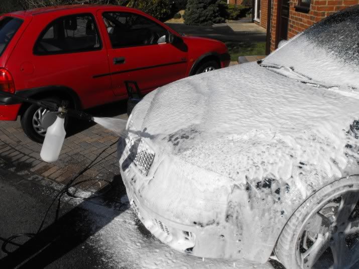

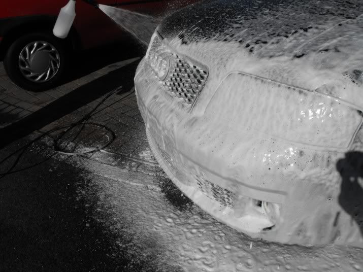

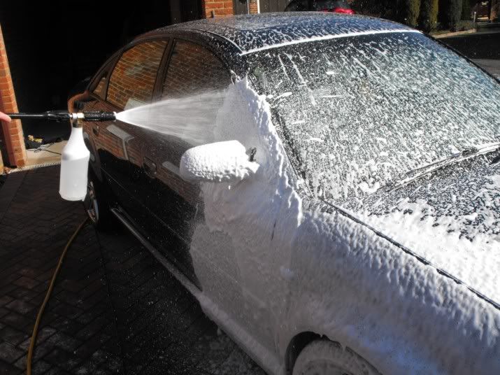

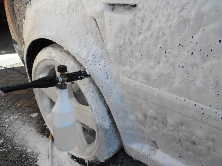

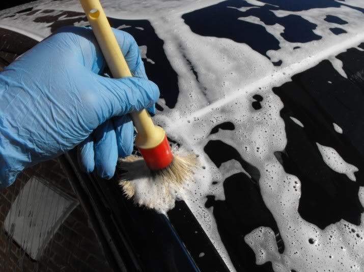

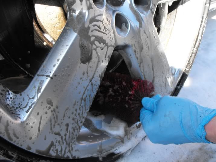

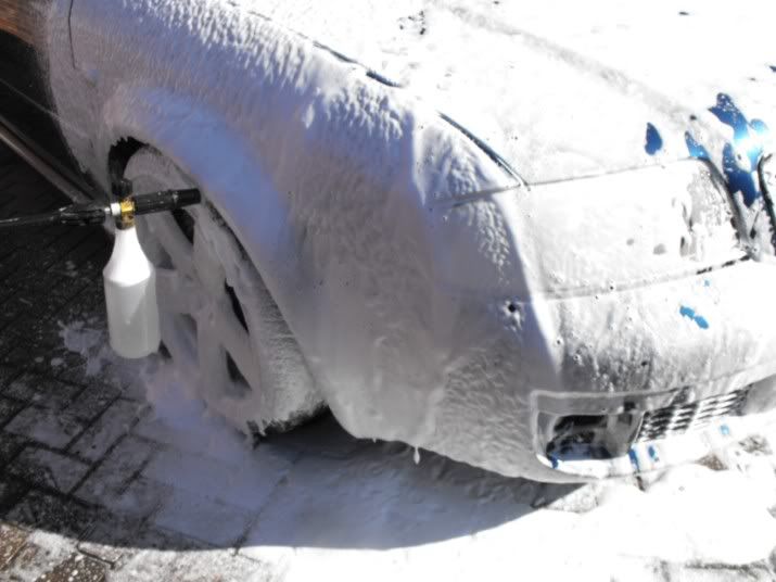

Car Foamed using Foam lance and Nilfisk

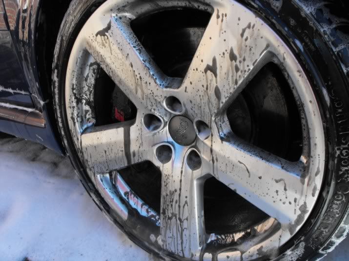

Arches, wheels, tyres scrubbed using the Foam to agitate.

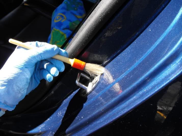

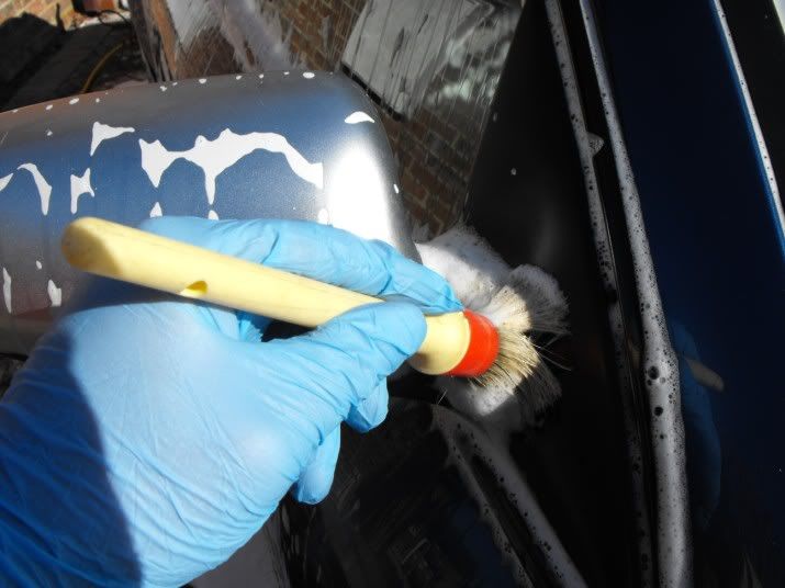

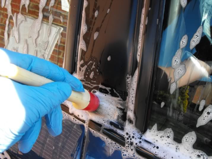

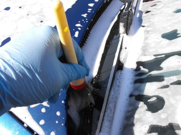

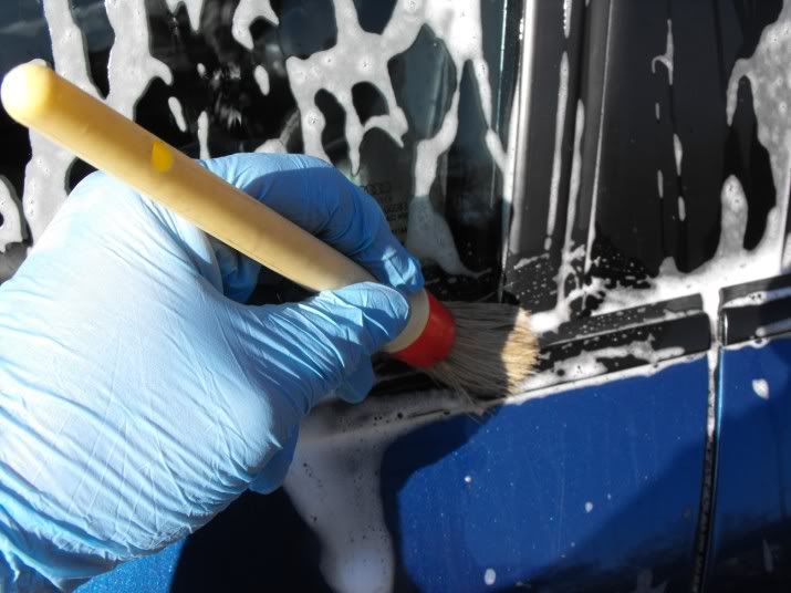

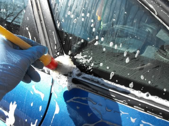

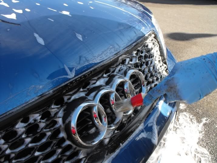

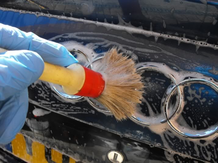

All badges, grills, window rubbers etc agitated with the foam using detailing brushes
Car Rinsed, arches rinsed and under sills and bumpers

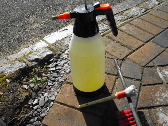

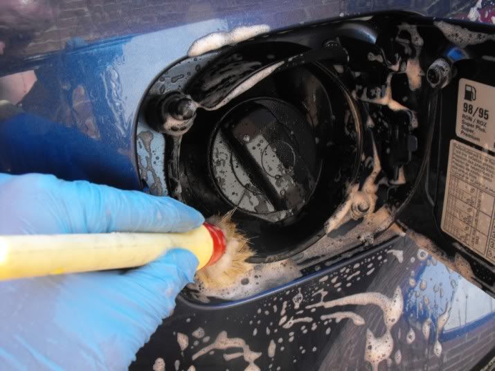

All badges, grills, window rubbers etc agitated using a foaming APC to ensure 100% clean

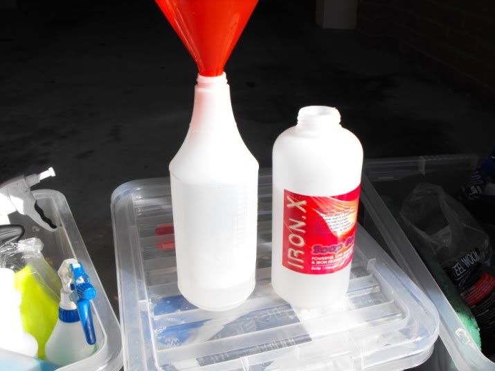

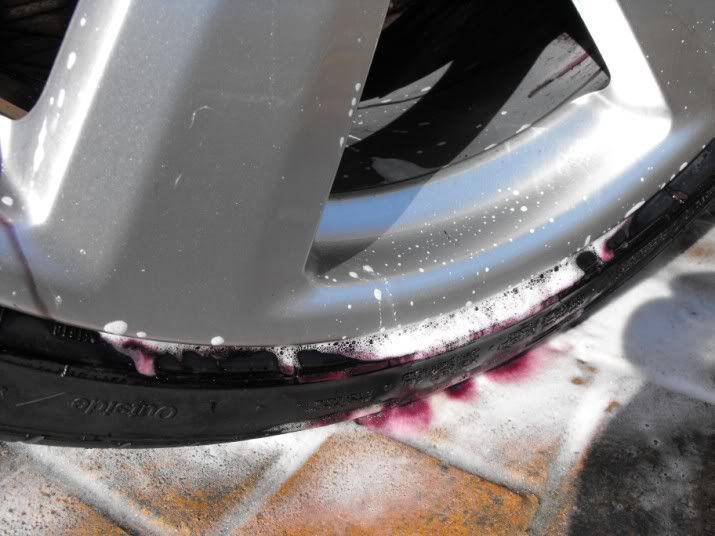

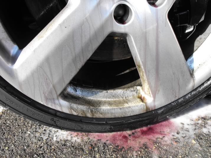

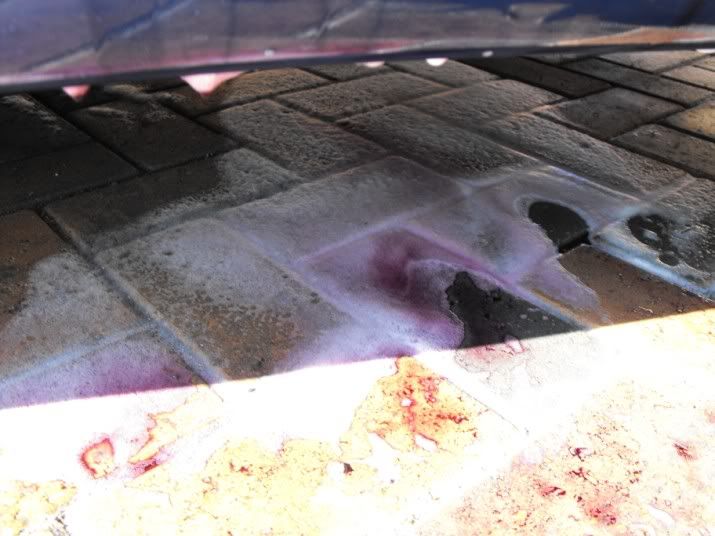

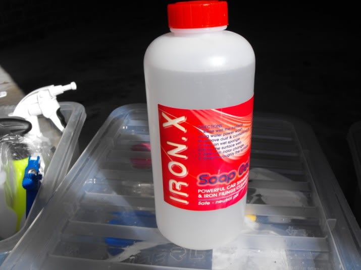

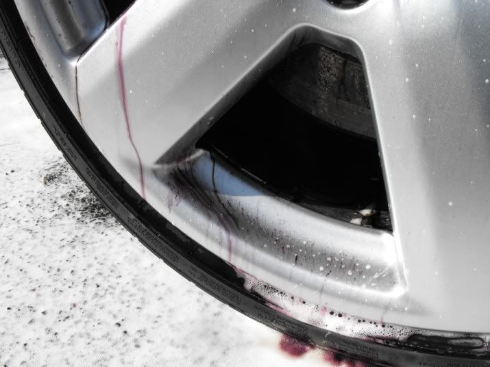

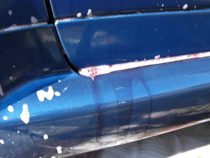

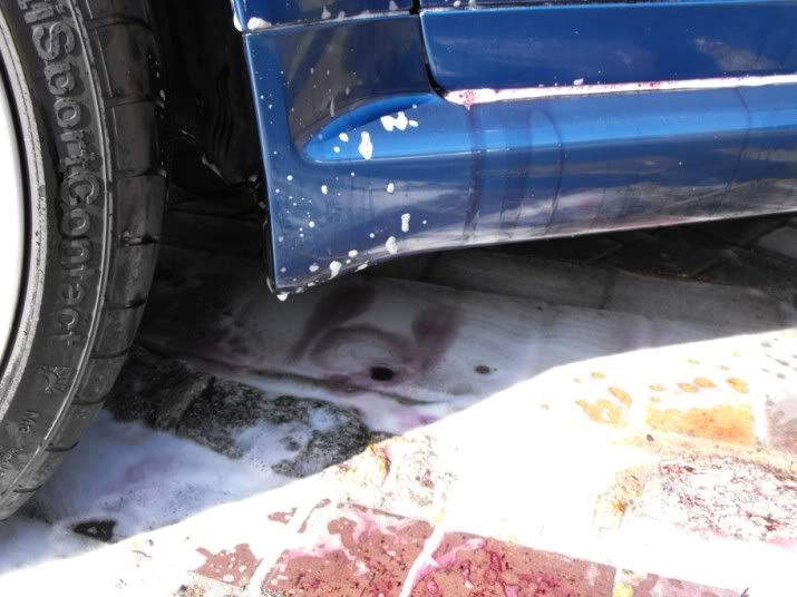

Evaluating a new product and put the IronX Soap Gel through the lance to test the lance as application method.

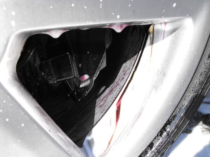

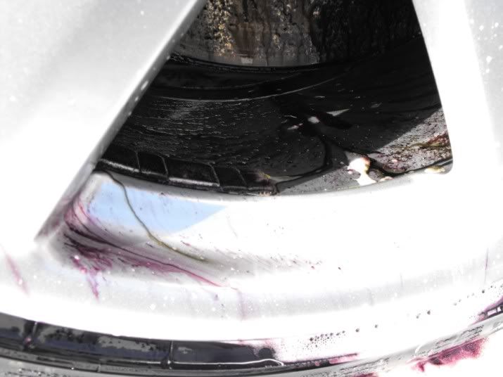

Decontamination stage started using IronX, then followed by a Tar Remover and Clay bar. Rinsed after IronX and Tar Remover before using Clay.

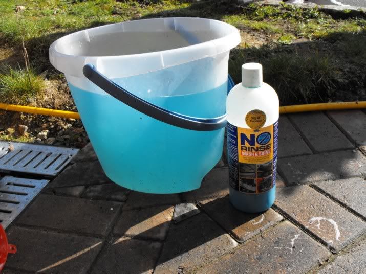

Final Wash with ONR

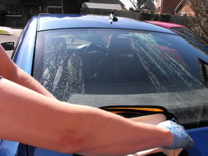

Evaluating new drying owel, all good so farm this was one wipe across the surface. More testing to do.

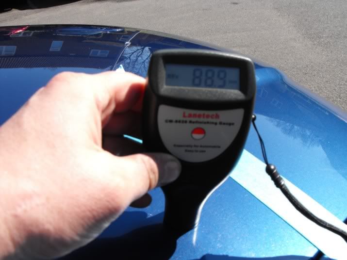

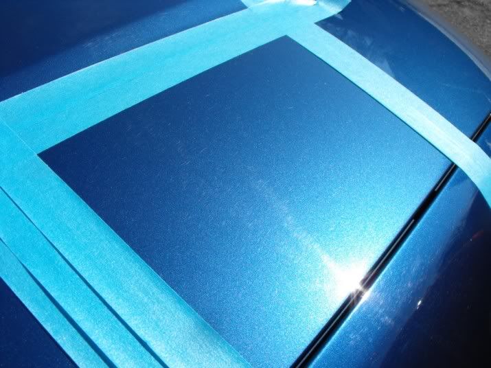

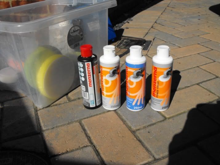

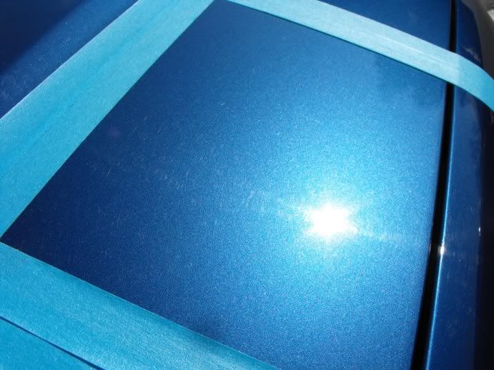

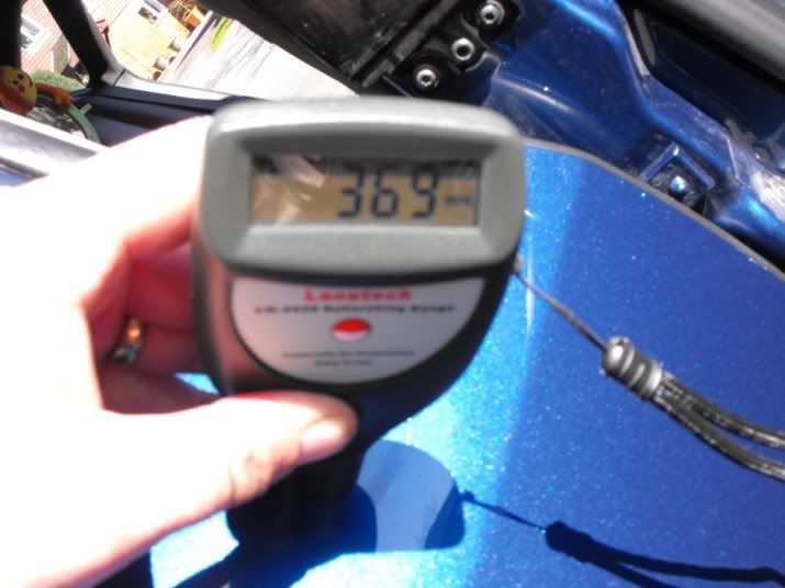

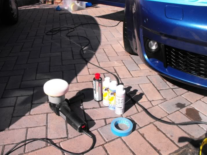

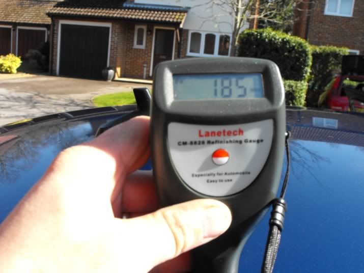

Paint Correction starting - Menzerna Polish selection and orange menz pads used.

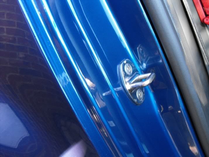

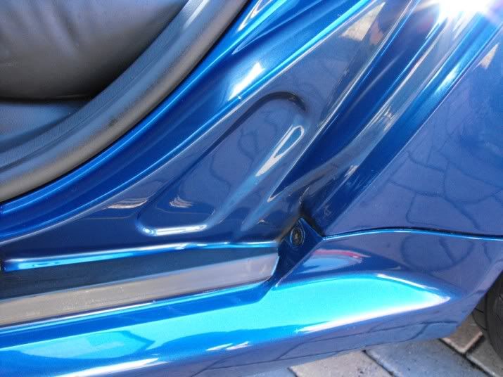

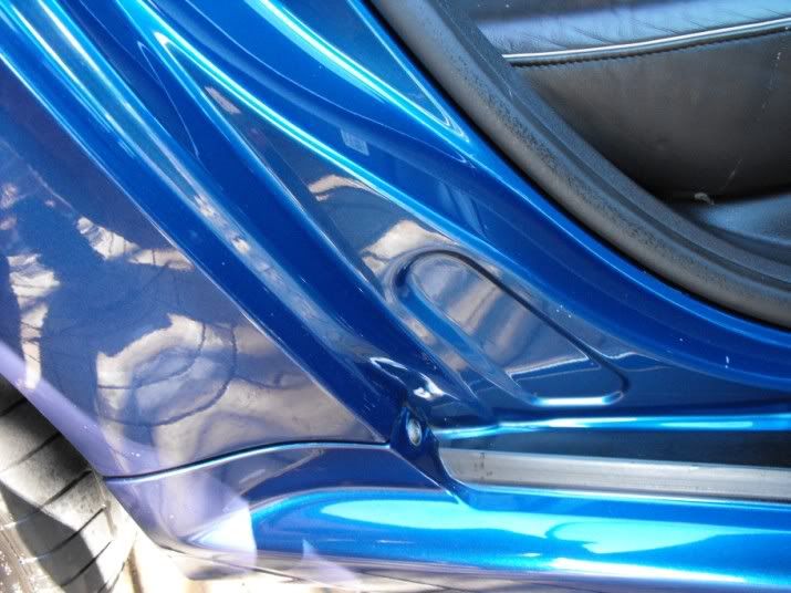

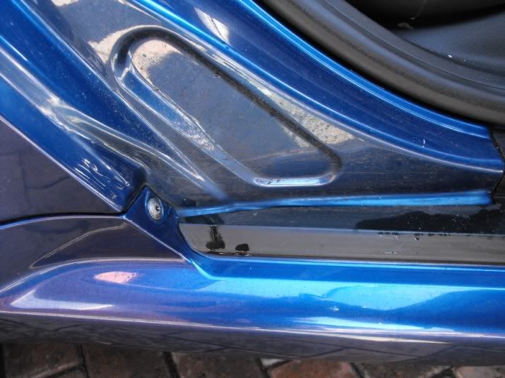

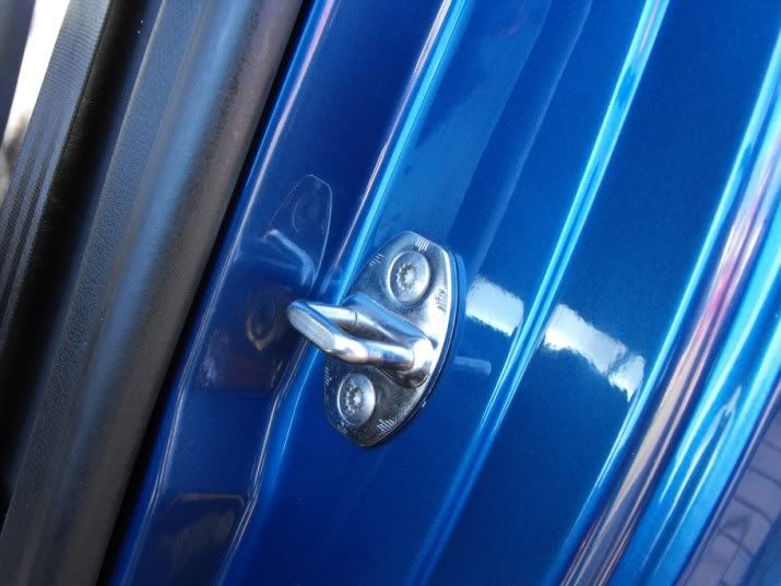

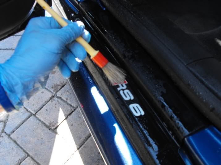

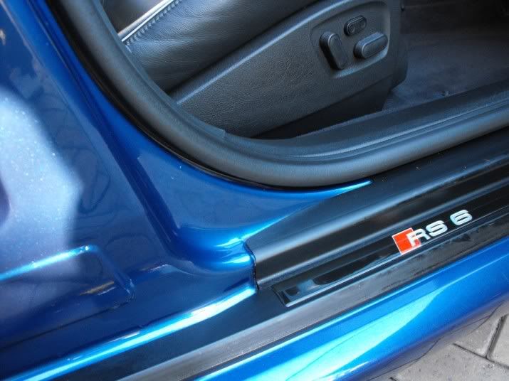

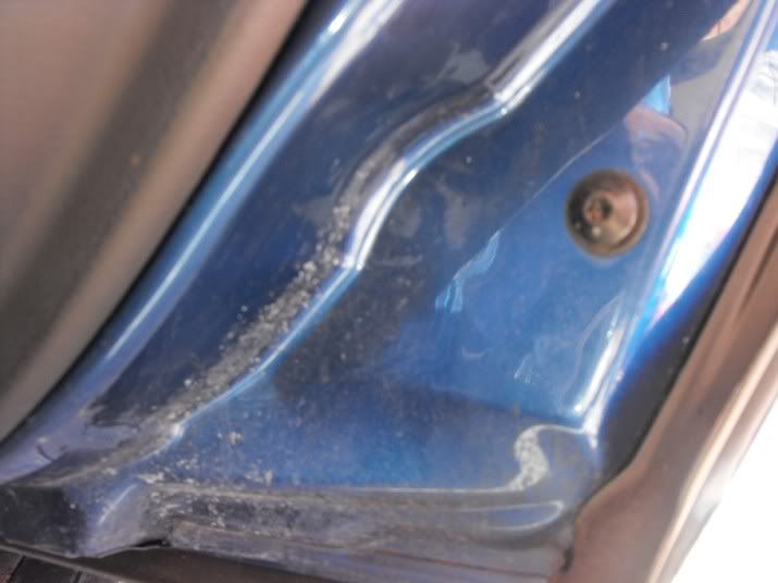

APC and Jeffs Prime Strong used on shuts, sills.

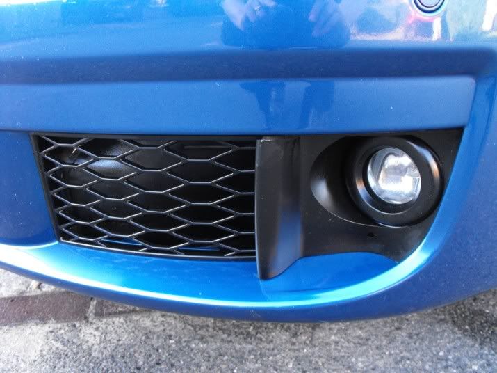

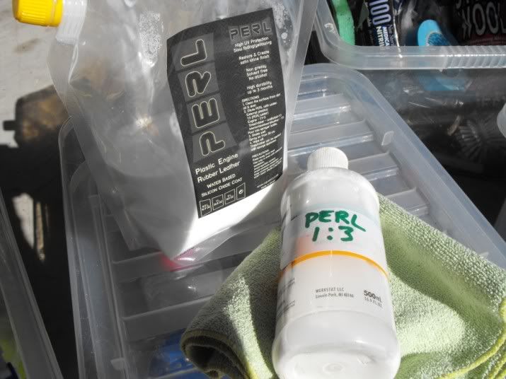

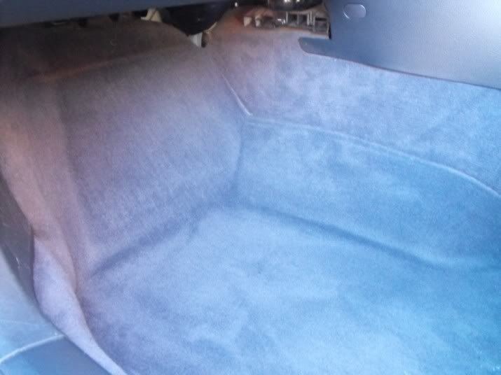

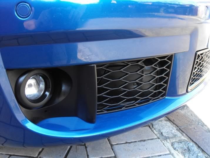

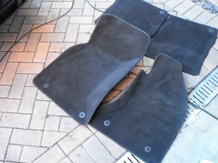

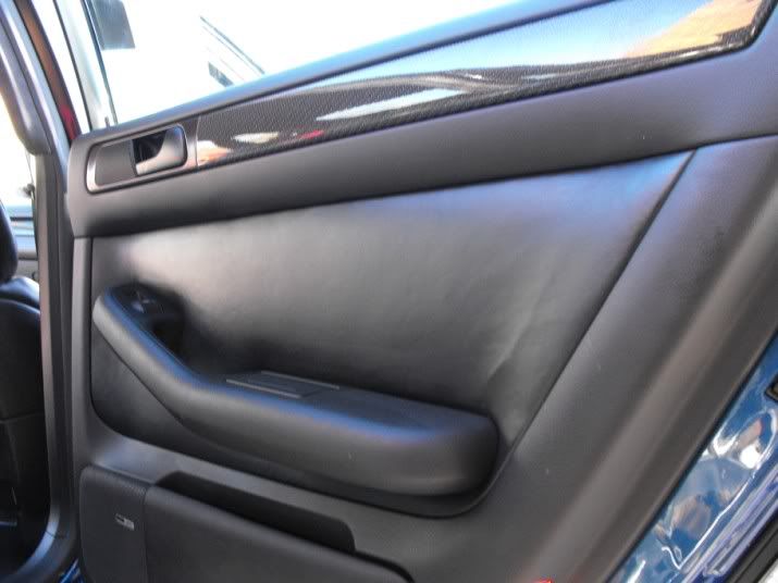

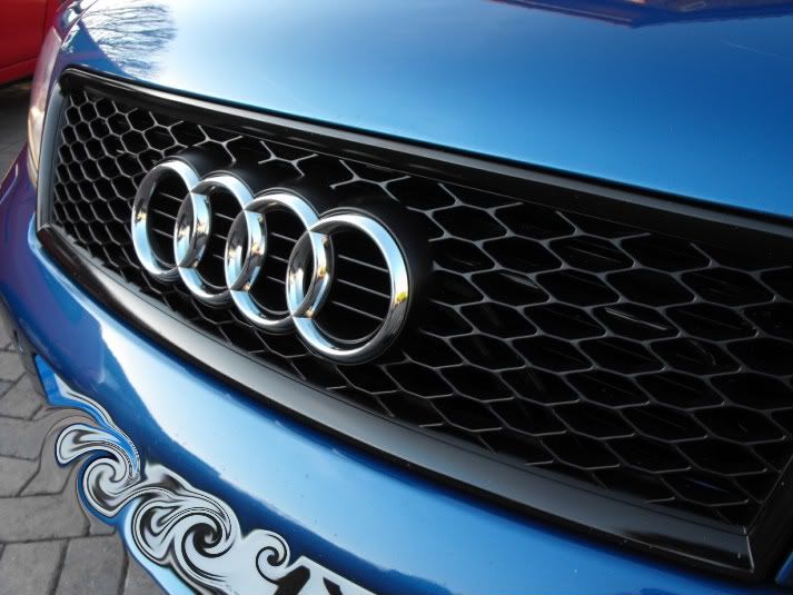

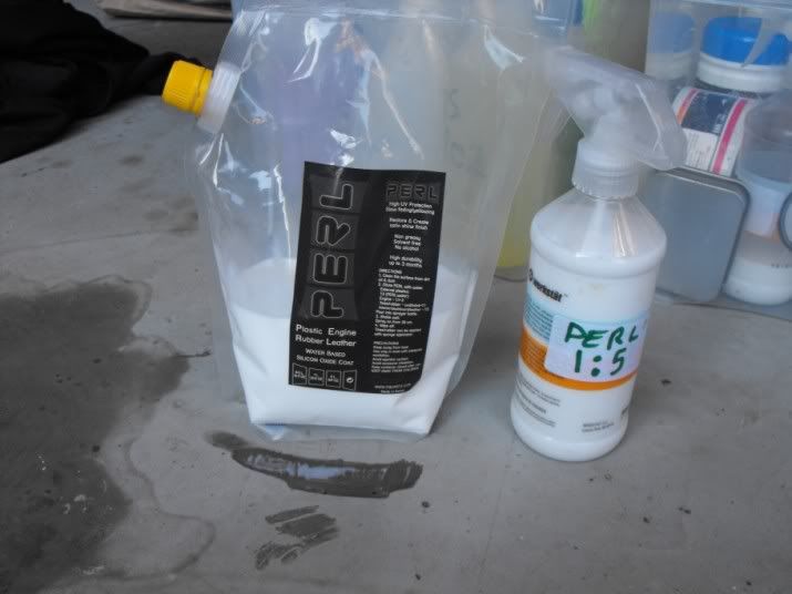

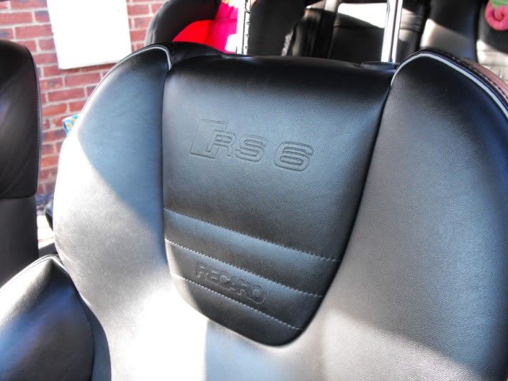

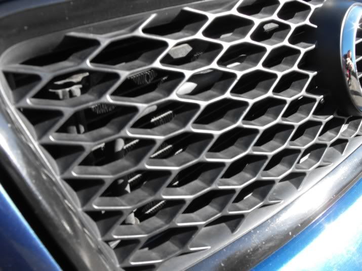

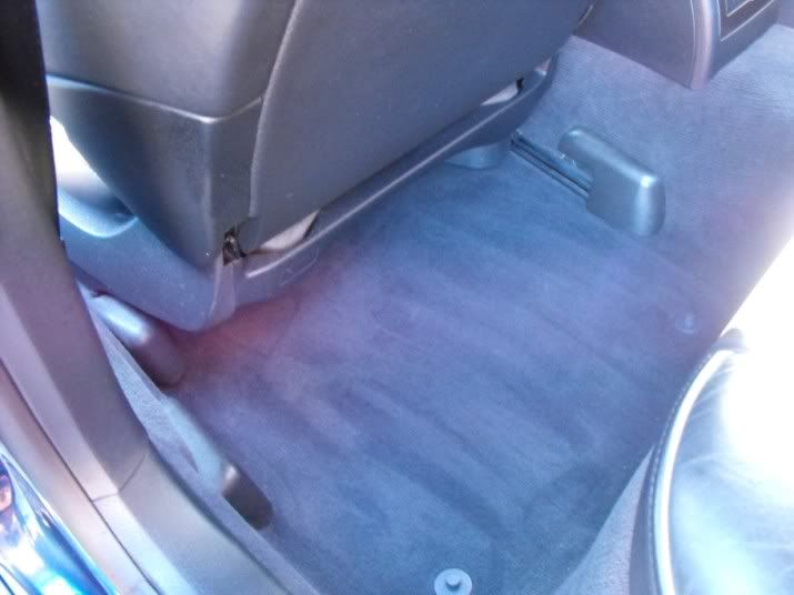

Next up was interior, hoovered, and all surfaces cleaned and dressed, leather seats cleaned and dressed. Evaluating CarPro PERL, very versatile and is now replacing previous products that used such as VP Trim Glitz and some of the dash sheen products. Various Dilutin ratios give you a product that can be used on hard plastic trim (this stuff looks to rock on the honeycomb grills, window rubbers etc... time will tell how durable is. Can also be diluted for leather and neat for dressing tyres.

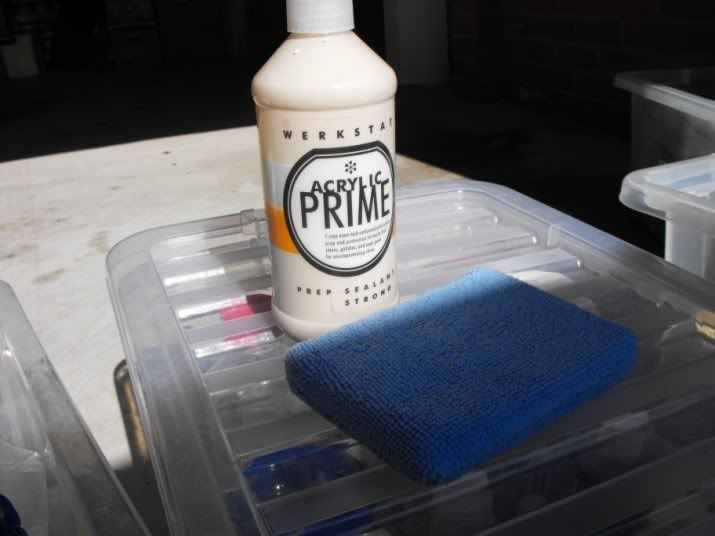

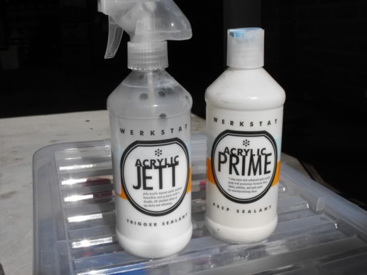

Base protection and paint flake enhancement was achieved using Jeffs Wekstatt Acryllic System. Prime base sealant applied using DA on a menz yellow finishing pad. Jett Sealant applied in two coats.

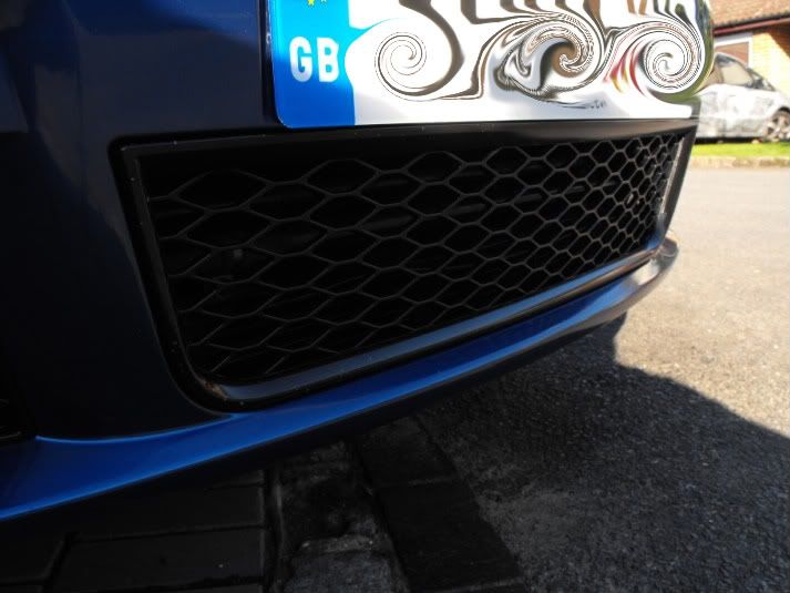

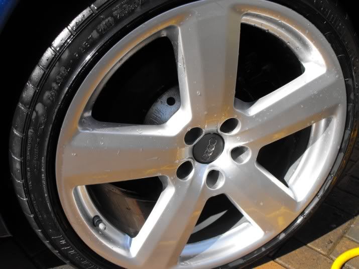

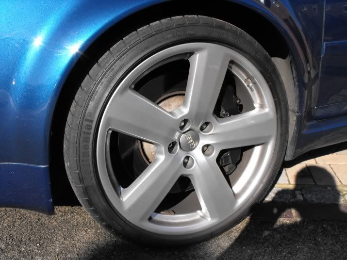

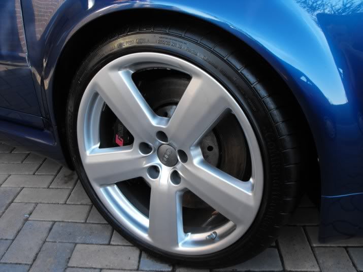

Wheels sealed and protected with FK1000P and tyres dressed with PERL at 1:1

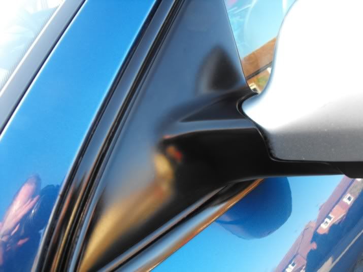

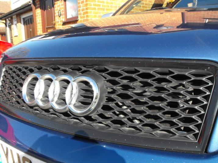

Black Plastics dressed with PERL at 1:3

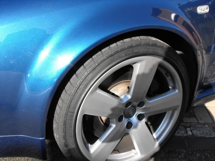

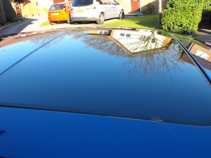

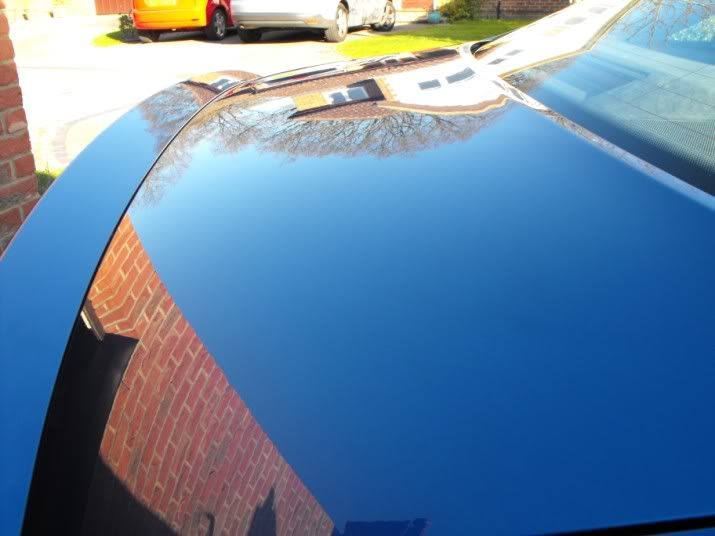

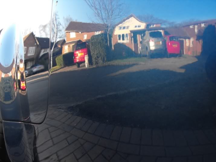

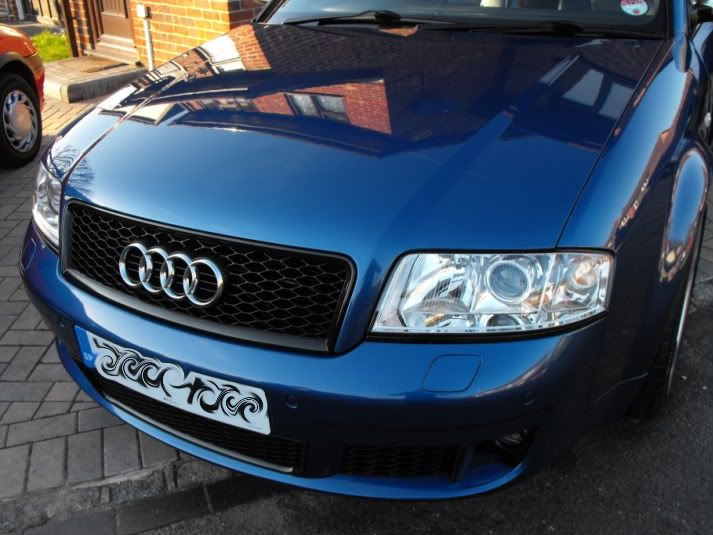

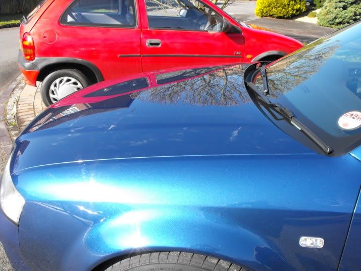

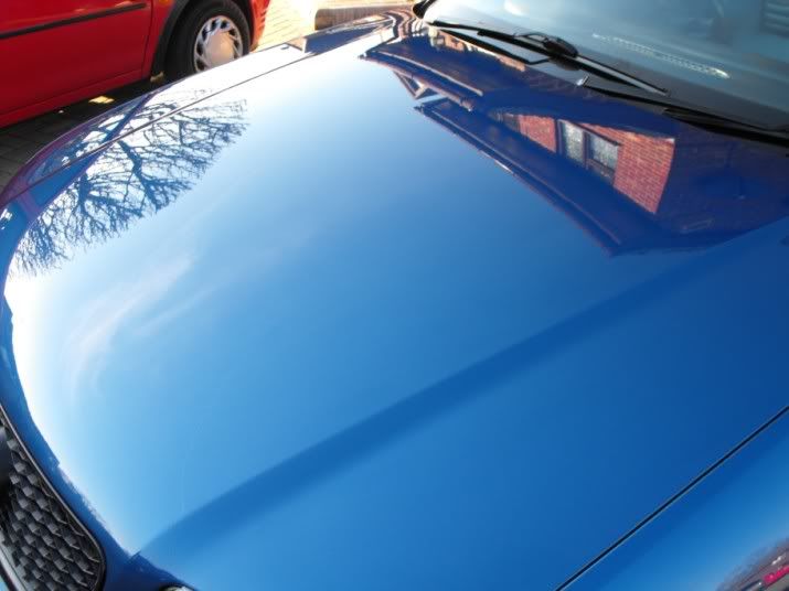

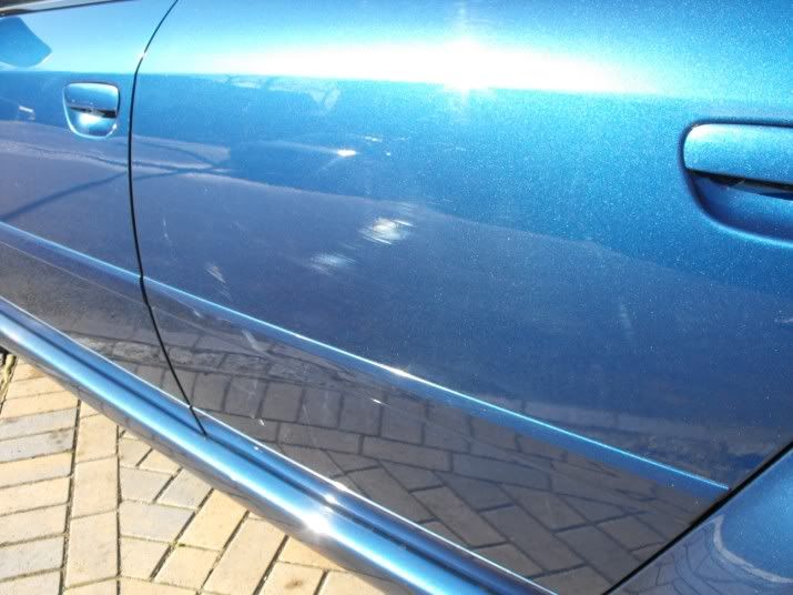

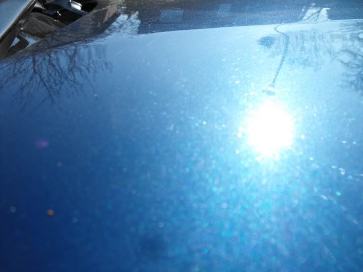

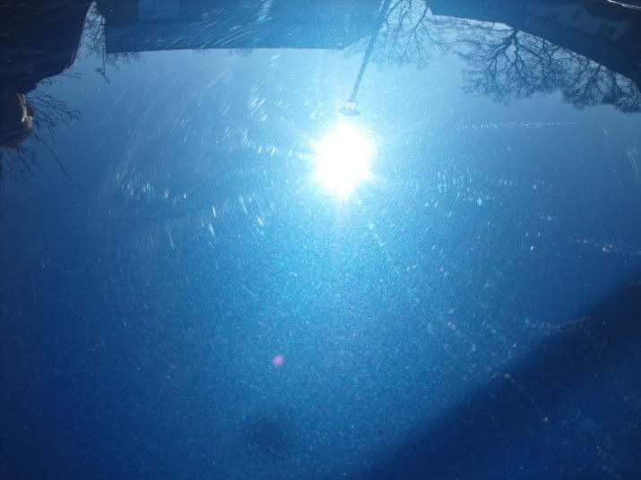

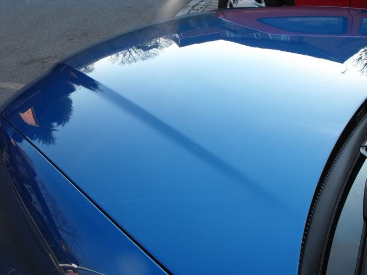

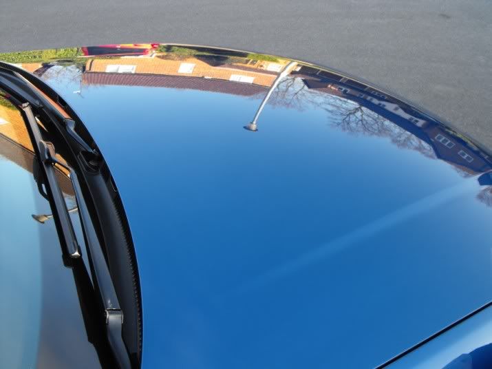

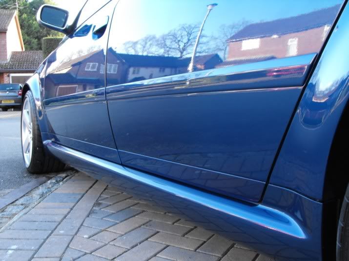

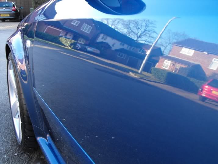

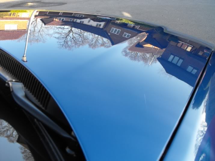

Some Reflection shots of finished corrected finish
A brief Reminder of the Before Shot :shock: ....you can use the ridgline of the houses on the left as reference, the hedge/bush and the pug sw does not even appear in this shot...

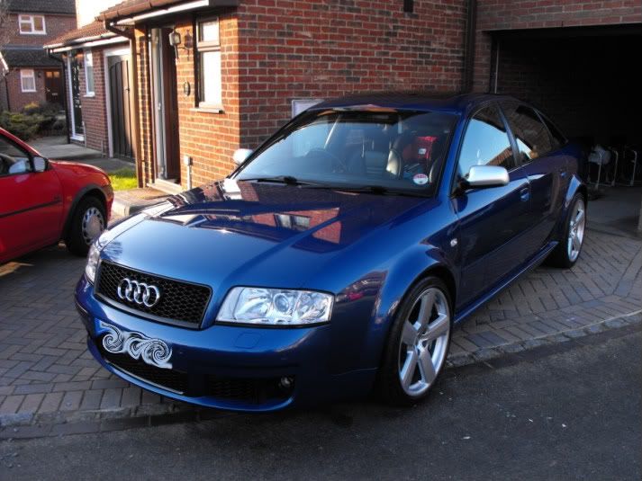

After, using same shot and points for reference :mrgreen:

Great work Steve, the snow foam seems to be getting thicker on every detail, love it!
btw you missed the last reg swirl. I expect you were tired after uploading so many photos!

steve wrote:Image
So reflective you had the blank the registrations out there?! :bowdown:
