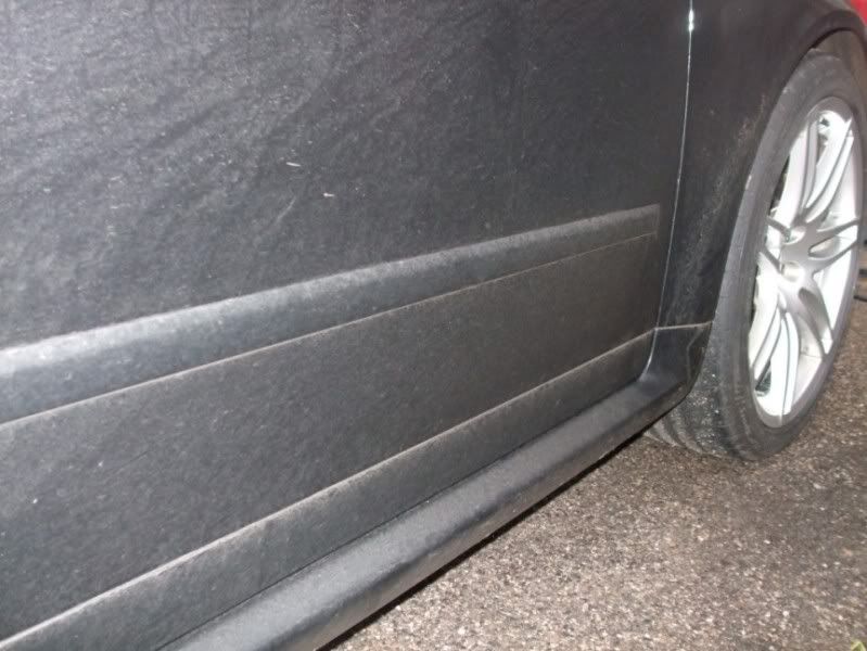

Here is MSLRS4's (Mark) a fellow RS246 member who lives two minutes away from me, so nice and local, used as a daily driver so planned to give it a clean-up, a bit of correction and then protection.

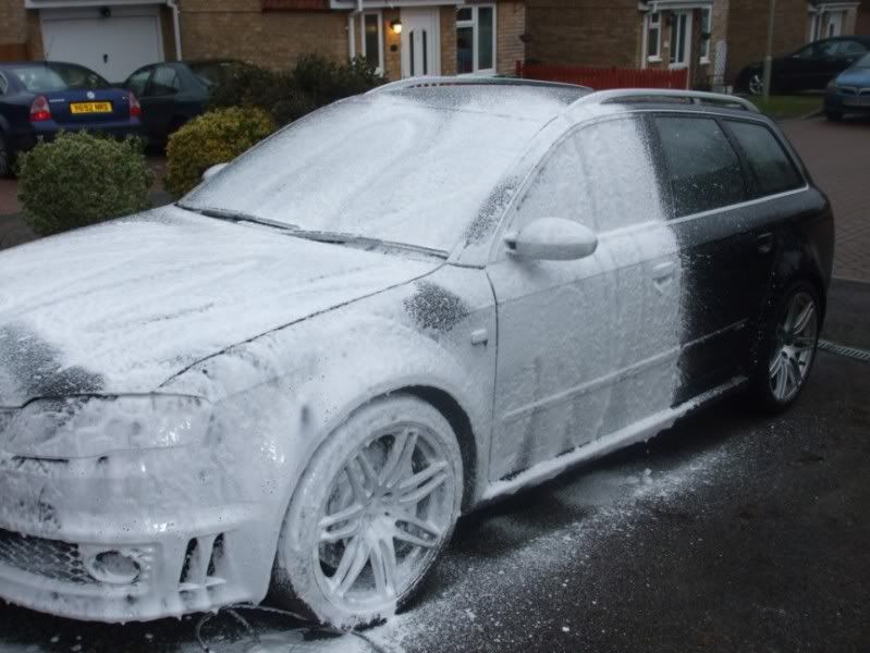

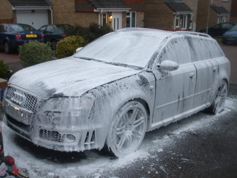

* Foam with AB Magifoam - Nilfisk Washer / AB Foam Lance

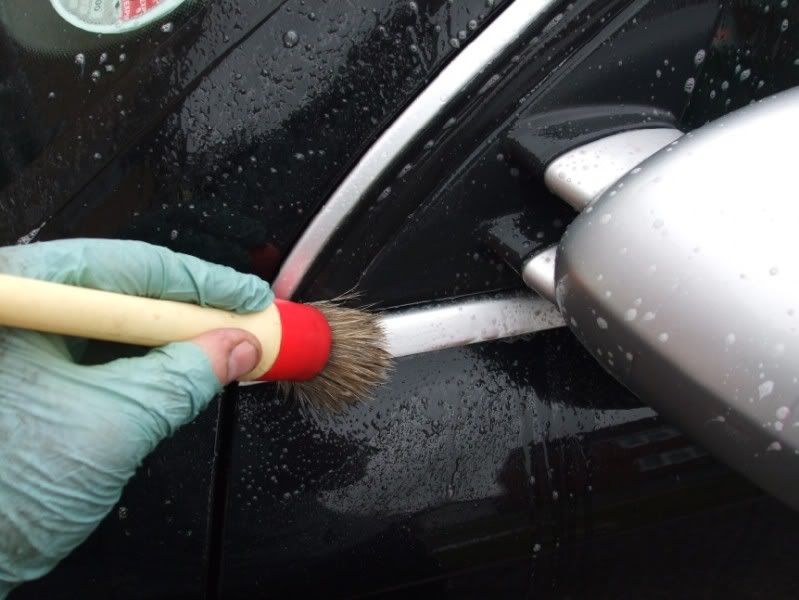

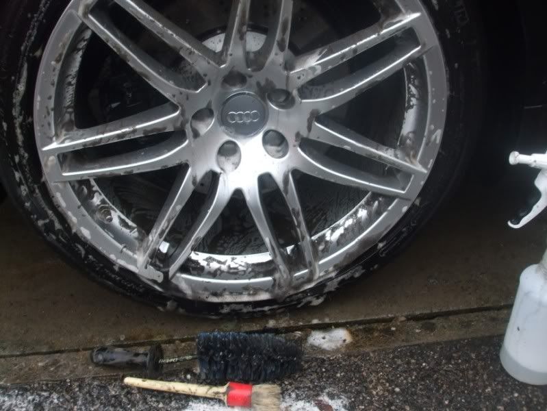

* Whilst foam dwells - clean badges, trim, grills, window rubbers with envy erushes using the foam, wheels arches with Vikan long handle brush
* Rinsed

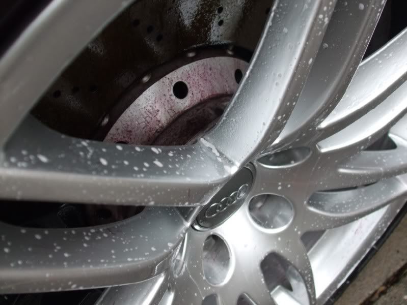

* Wheels finished off with Espuma Revolution, tardis, IronX
* Badges, trim, handles, rubbers, grills finished off with G101 and envy brushes

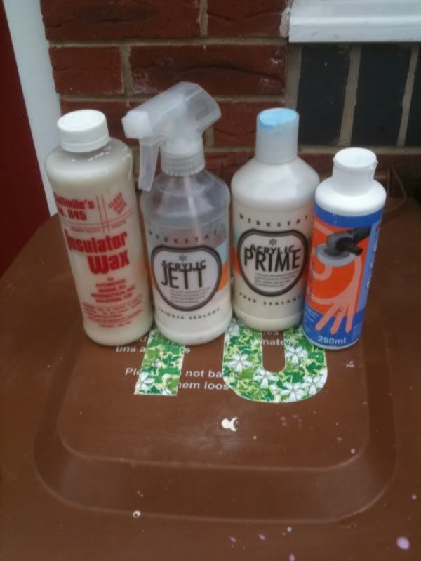

* Wheels, all shuts, chrome trim, glass cleaned/ polished and sealed with Jeffs Acryllic Prime Strong. Wheels covered in Colinite 845 wax.

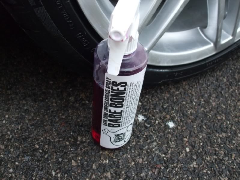

* Arches dressed with CG Bare Bones

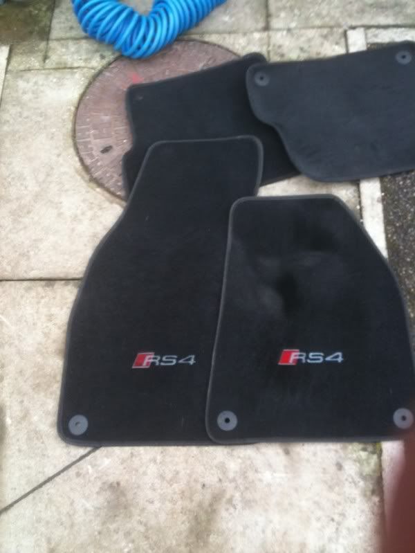

* interior vacumed and brushed with various detail and stiff brushes; Cleaned with G101 and dressed with Espuma Dasheen; interior glass Espuma Green Glass Cleaner; Carpets and matts with Esouma Farbricare; Leather cleaned and dressed with Dr Leather Wipes; Pedals cleaned with G101 and detail brushes. Espuma Fresh fragance used as de-oderiser.

I just love Magifoam at the moment:thumb: ...wanting to give Espuma Activo a go when it runs out.

Its amazing how much Jeffs still sucks out of the wheels when polishing with an MF pad, see the state of pad compared to fresh one.

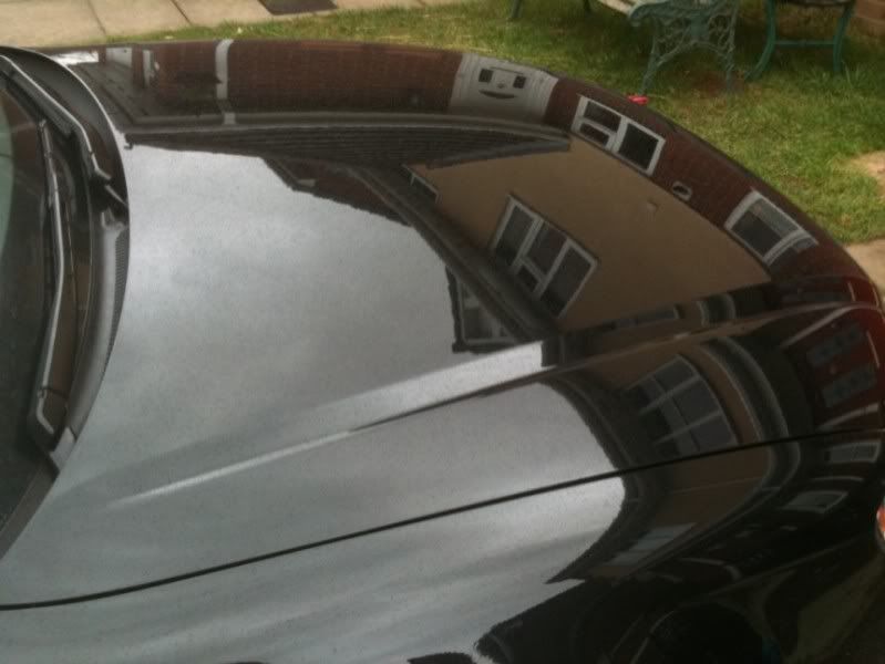

Realised I had goosed some of these pics, as blurry, most of the rest have tuned out really poor :mad: ...lots of the afters had to delete as just too bad so only have a few :wall: The photos dont do the finish justice and it had started to spot with rain, anyway, hope you get the idea. Will improve camera work for next time and maybe have sosmevody else take my photos :D

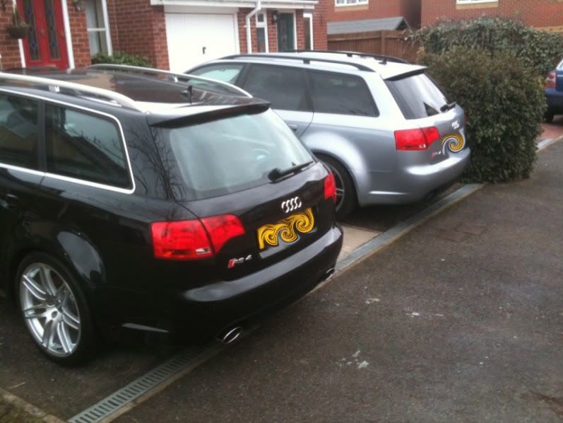

Another one with mine sneaking in :D

Love the photo of the two Avants next to each other!
