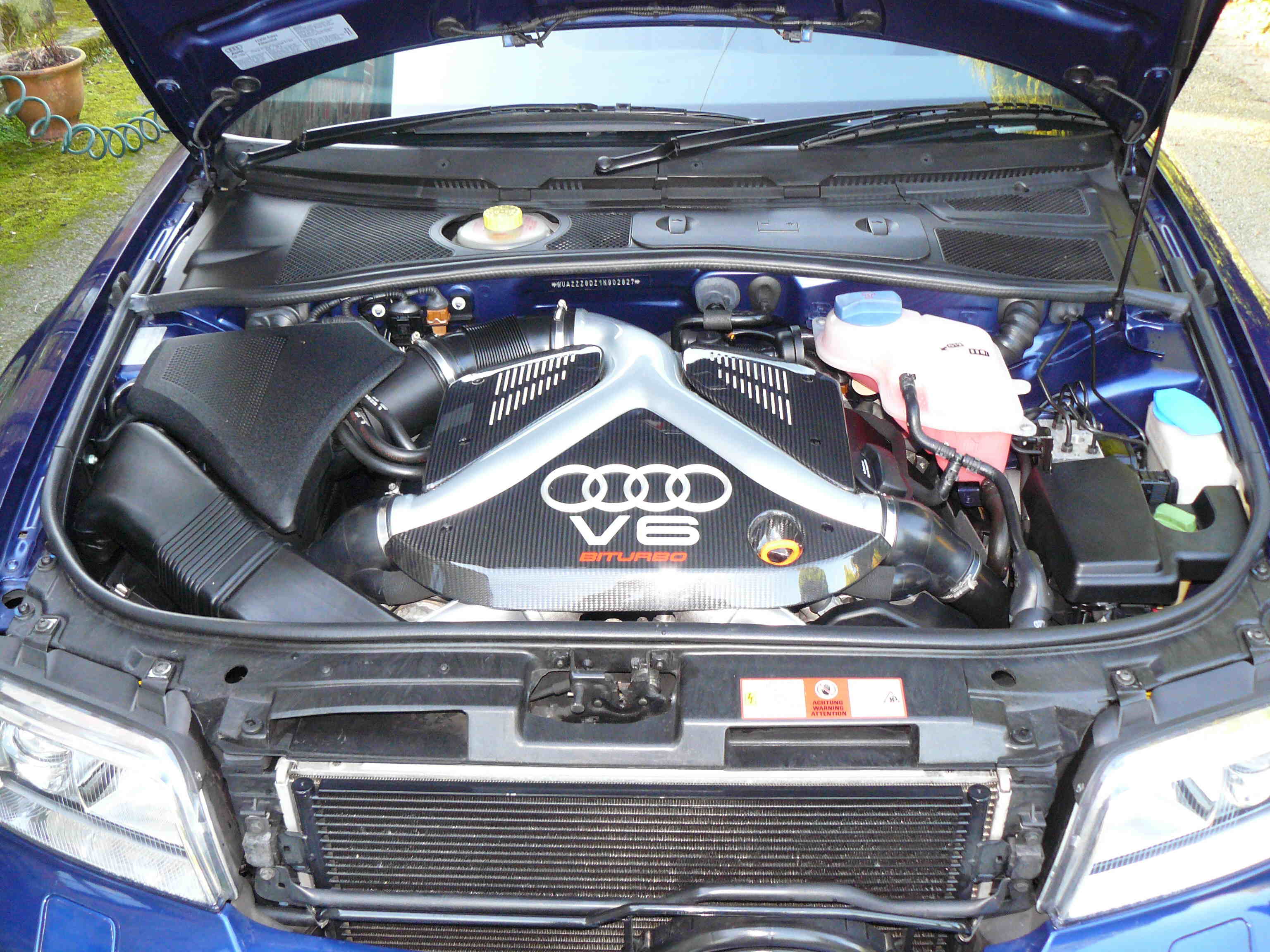

rs4boy is that a new coolant expansion tank? Asine looks that horrible cream colour. Was thinking of removing it and trying to clean it . Have heard ( dont laugh now) of filling it with "RICE" and water and giving it a good shake cleans them up.

New expansion tank is only around £30. I've got one lying in the boot, which I have to fit when I get time
rs4boy doesn't use his car, plus it has delivery mileage hence the "new looking" expansion tank!
