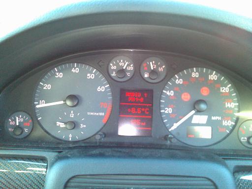

Just a quick one for you collective wisdom... I had my S4 (pre-face) serviced at the main stealer just last week (30th oct) and since then the damn thing's been running hot?!
I've had the car since May this year, and even after some very spirited driving i've never seen the water temp guage rise above just over 90 (straight up on the dial) and oil much above 100, again even after some very spirited driving.
Yet now even afetr driving for half hour or so at no more than 3,000 rpm, dordling on country roads like its running at 105-110 water temp and 115 ish oil temp, and when i switch off even after a very gentle cruise the fans etc remain on (which i apreciate it is supposed to do when it gets hot), yet in the 5 months i've had the car it's bever had to do this before, and it has been subject to some extensive periods of "strictly on a private road only officer" driving :P
What could it be and are the stealer's likely to tell me to shove off if i try and get them to look at and fix it for free like?? Anyone else had a similar thing?
Any info much appreciated, i'll attach a pic of the dials from when i got to work this morning later so u can see what i'm babbling about!

PS - Have attached the image from this morning, this was after a 15 mile, 25 minute cuise to work, never mor ethen 3 maybe 3.5k rpm. oil actually looks slightly cooler than it was yesterday after drive home and usually sits near that mark, water was upto 110 while driving, dropped to temp shown in car park. Previous to this, i'd never seen water temp above the 90 mark, occaisionally a tiny fraction above it but only after a good thrashing like.
S4 Dials - Hot Stuff

Post by SimonS4MTM » Thu Nov 09, 2006 12:04 pm
Looks like temp sensor gone to me. Though oil does look a bit warm as well for the driving you describe.
What service work did they do? I presume they did not leave a set of overalls in front of the radiator?

Actually, you must have given it some stick (or sat in a lot of stationary traffic), you are reading 125 miles with just under half a tank. That may explian the oil temp.
