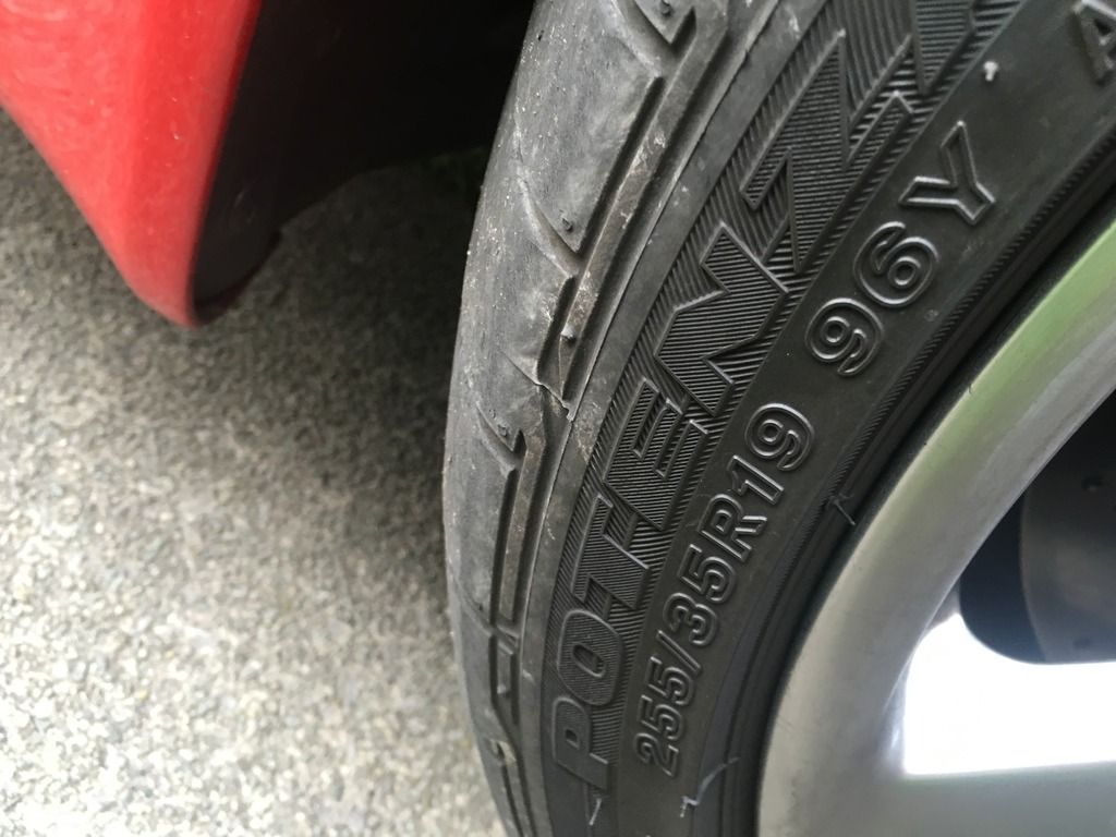

Hi all,
Just got my RS back after a fresh service and new front brakes on Monday.
Took it for a quick 20 miles last night and drove to work this morning.
Then, to my horror, noticed just now that one of the rear tyres was well and truly flat :bash:
I have pumped it back up to the stated pressure and the top of the sidewall is marked and the lettering has been slightly worn away.
Unfortunately, the rear tyres have 5mm left and I did not want to replace them after just paying for the brakes.
So, I assume that I should replace both of the rear tyres for safety and could keep the part worn one as a spare.
My question to you all is; I am currently running Bridgestone Potenza RE05A 255 35 19 all round, should I replace the rears with the same, or should I go down the Michelin Pilot Sport route?
Thanks in advance!
Chris

Stick a photo on or get the tyre checked. It may be repairable if not too far gone. Then replace the pair.

Post by ChrisRS » Wed Jul 06, 2016 7:31 pm
So, here's what one should look like;
And here's the knackered one;

Well your in for a pair of tyres then mate. I'm not sure what the hate it for Bridgestone. I like you thought they were a decent tyre. As far as having them with run flats I'm afraid it's the run flat that makes them poor. The side walls are so hard they make the ride harsh and they just don't perform as well.

Put the Mitchy PSS (MPSS) on and forget'boutit. However, the way you've worn the the knuckle off that tyre is a worry, what pressure was in the that tyre? Should be between 40psi and 44psi. Are you running spacers? Is your suspension copacetic? Had an alignment done?

It has only worn like that because I drove it while it had very little pressure and didn't notice any difference to handling or the ride quality :bash: - I know, idiot!! I check my tyres weekly and are all kept at 40PSI.
Suspension is all in good order, no spacers, I believe an 4 wheel alignment was done last year with the new tyres.
