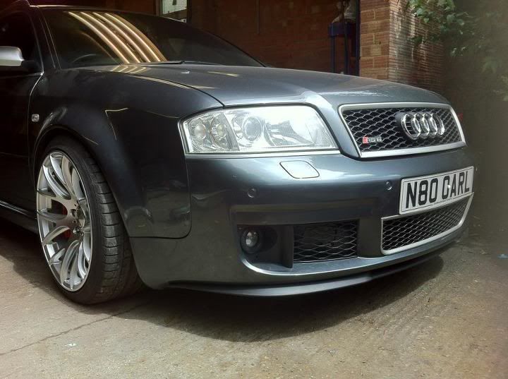

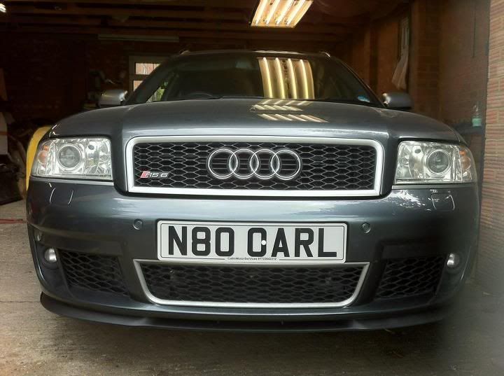

Hi Carl. What's the splitter from?

Nice wheels, would look fantastic if they were darker.

Looks like a seat Leon cupra r spitter

Thanks guys ,Yes splitter is from cupra r £35 from SEAT ,thought is fit it as bumper was off while I was doing cambelt and service

Looks nice :beerchug:

I like that it is subtle. Could have been there from factory.

What year Cupra R. And does it fit as well as it looks, or is there any gaps or any cuts needed?

its from a mk1 shape cupra r 51plate to 54 plate
i had an LCR before my RS6 would not be putting a splitter on mine tho although it does seem to work with any car

Had to cut an inch of either end cause of the shape of the bumper apart from that measuring and straight on ,its gave me another 10bhp lol

Sorry forgot to say no gaps really does look factory

How did you fix it?

Its has perfect size lugs u can pre drill and fit with self tapping screws

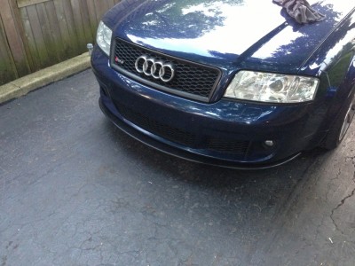

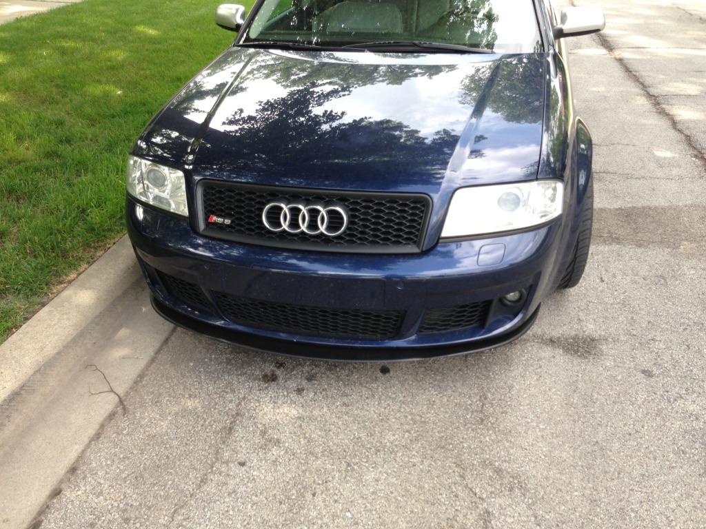

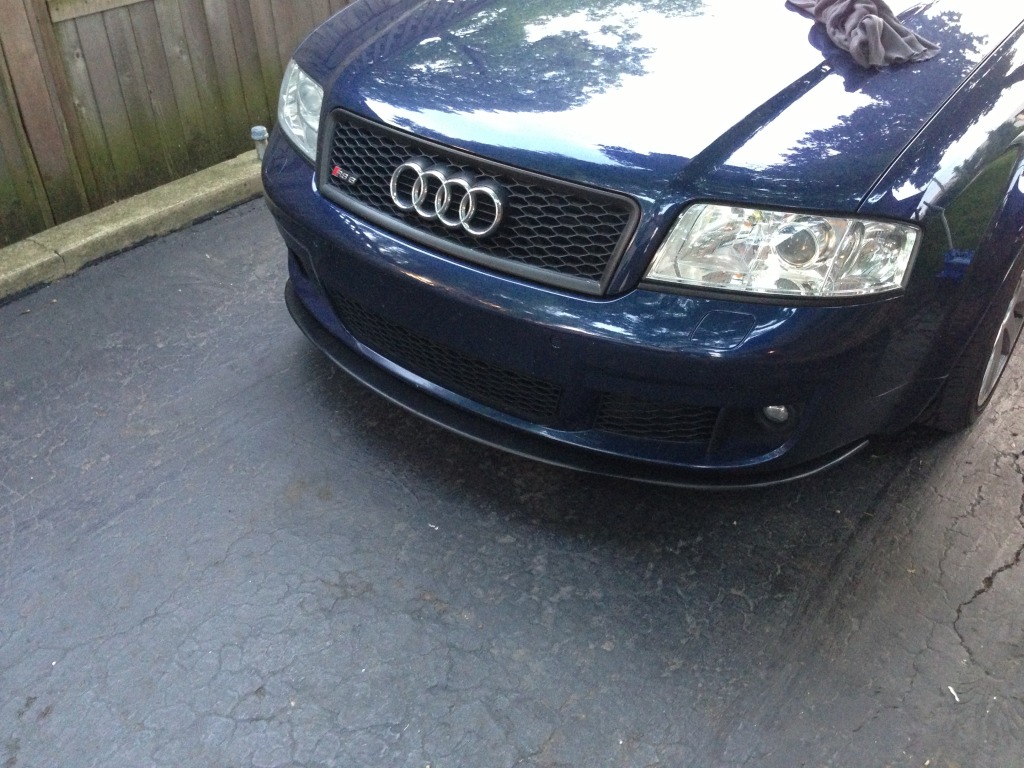

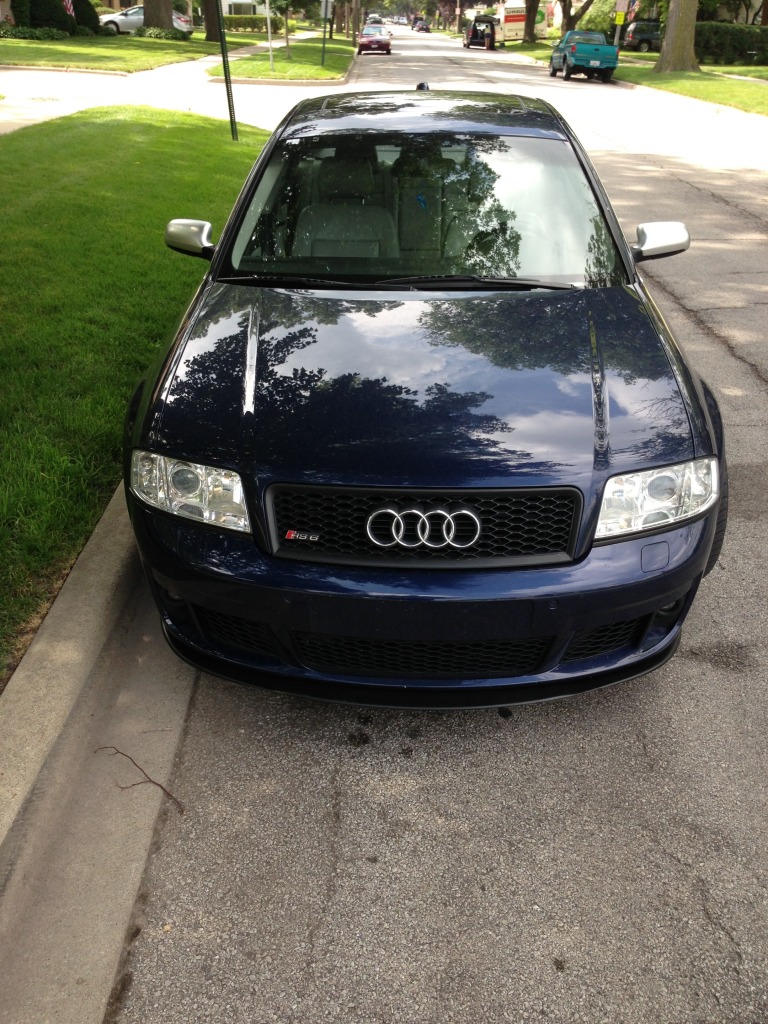

It's from a b6 platform kerscher front kit.

Looks odd. I think the Cupra ones look better.
