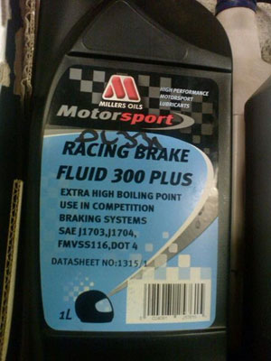

Anyone used Miller motorsport racing brake fluid 300 plus xtra high boil?
The guy who is helping with my suspension uses it in lots of cars including subarus etc and swears by it.
It is happy to use the ATE super blue if that is the one to go for but I who have to buy it myself as he doesn't supply it.
Any thoughts? Is there special fluid for our Audis or will any work as long as it's good with a high boiling point?

SteveCuz
Posts: 652
Joined: Wed Jan 02, 2008 12:43 pm
Location: Belfast
Post by SteveCuz » Wed May 12, 2010 10:32 am
Bump >>>
Guys any comments on this oil above.
I am back from holidays and taking my car today to get the suspension sorted etc and at the same time change the brake fluid.
Just want to check if we need a certain spec for the RS6 or any good quality high boiling point fluid will suffice.
