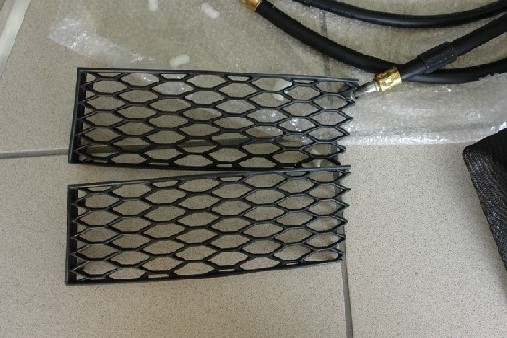

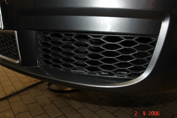

First step is to take the fog lights out. That will enable better flow of the air.
Second step is making custom grille. Just one like MTM and Sportec makes. Maybe some one knows where to buy the grile ?

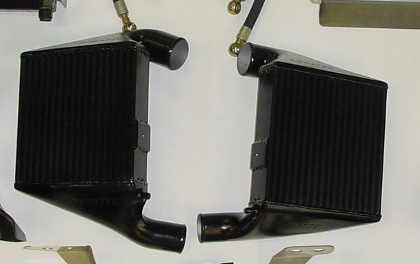

Third step would be the replacement of the intercoolers.
There are two options:
1) Sportec kit that is very expensive. The best price I have found is at AmD Technik Inc. VAT £3333.85 (Exc. VAT - £2899.00).
2) Making my own custom Intercoolers based on sizing of Sportec. Core dimensions are as follows: 270 x 270 x 64mm.
Are the any other ways to the the temperature of the air down ? Are there any other companies making intercooler kit for RS6 ?

I purchased the meshing from MRC
