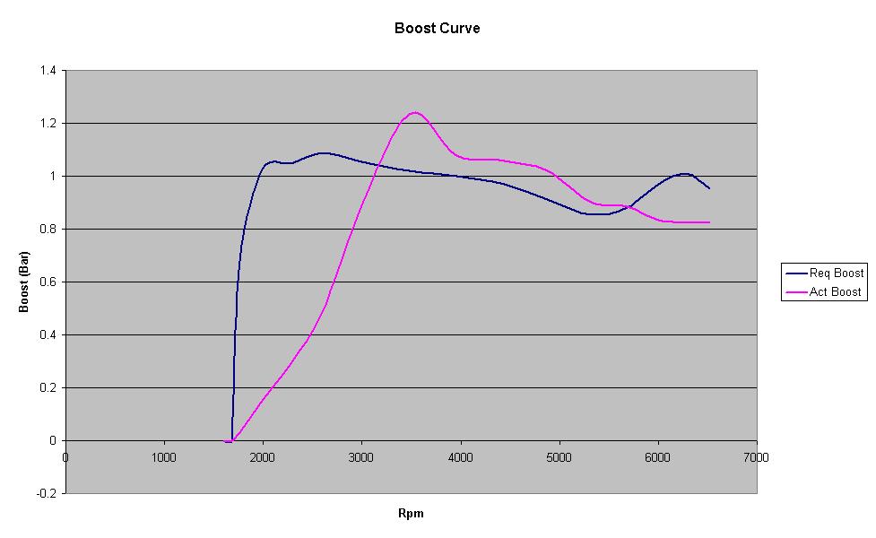

Just borrowed an Apexi boost controller and was wondering how I could connect it to control boost to see if I can try and smooth out my boost response curve.
I would like to leave the boost control totally upto the EBC leaving the N75 connected only so the ECU doesnt get upset.
Happy to hear people's suggestions or why it wont work if that is the case.
Below is my boost curve currently.
