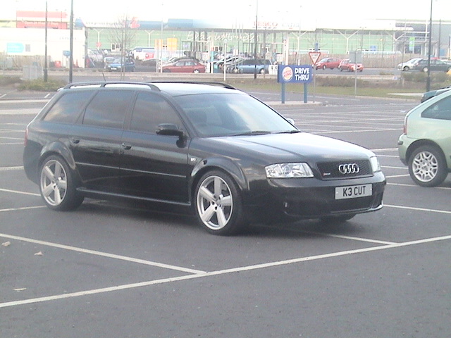

Hi guys 2 new front shockers fitted last at Audi but now ahve a kinda of rattle when going over bumps and potholes( theres enough of them) after a while of running the thumping stops was back to dealers this morn up on ramps but they could find nothing loose or anything that would rattle and on the test drive it did not rattle.
Any 1 with similar problems??
