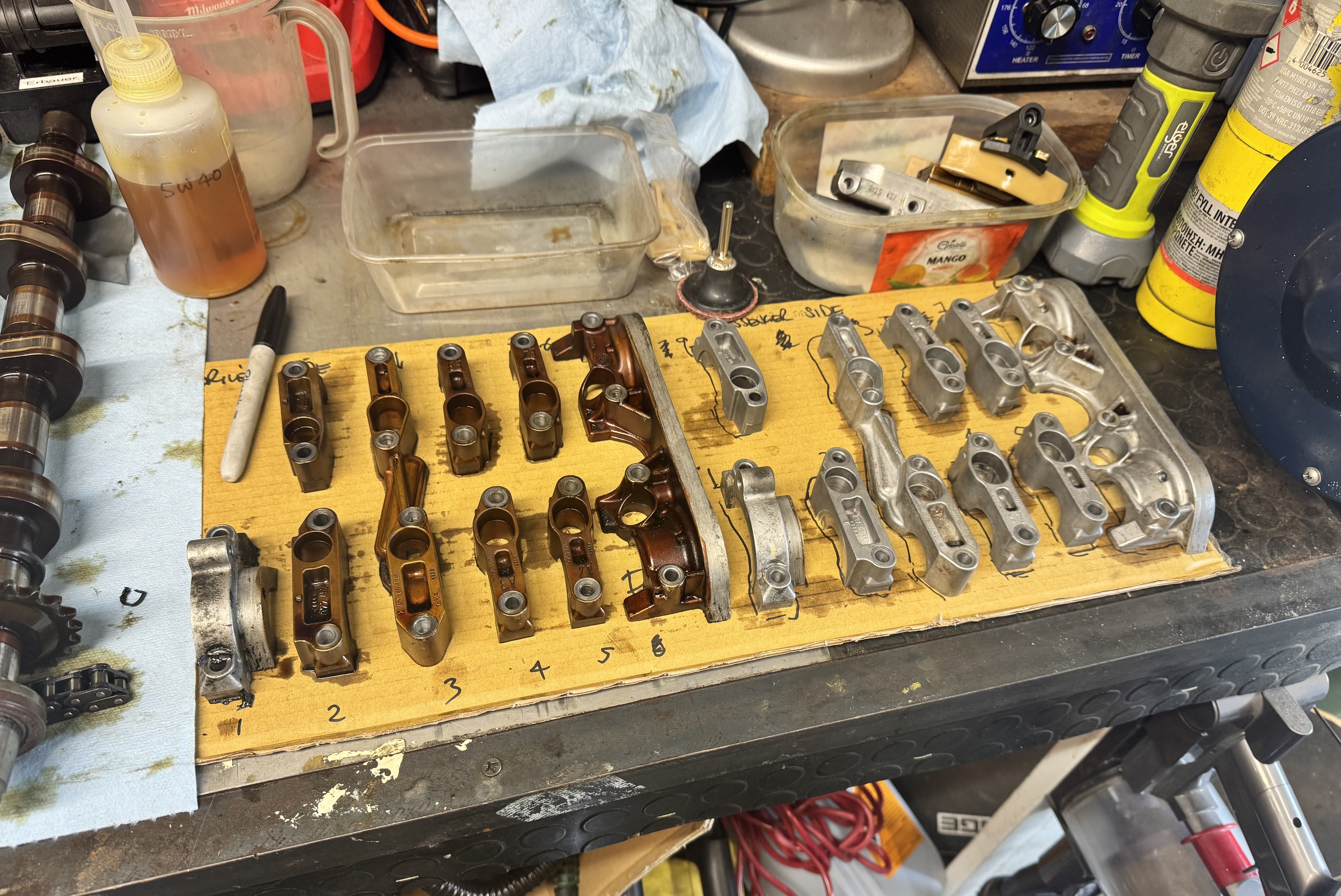

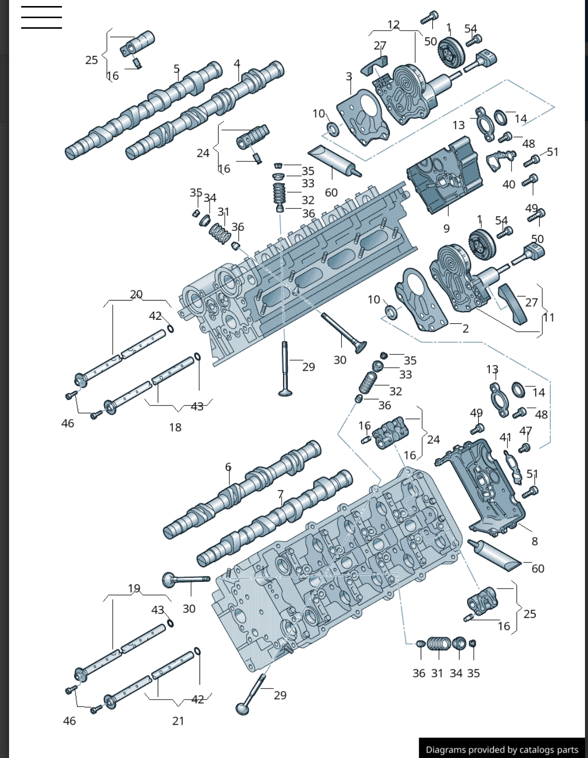

They aren’t that hard to swap really it’s just getting to them. You need to prise them upwards with a small pick. I also used a plastic trim tool so you don’t scuff the head anywhere. You also need to remove the cams (which is tiresome and expensive when you need to replace all the 52 bolts) but if you are doing the cam tensioner pads with your cambelt it’s only a little extra effort. With the cams out you can rotate the holder in place and see rhe hydraulic fingers.
The parts in question are 16/24 for inlet and 16/25 for exhaust.
Exploded view

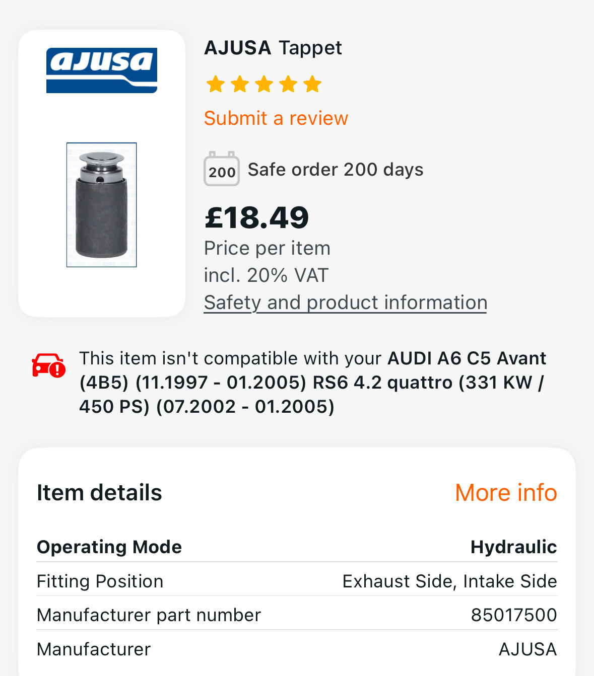

Now, the hydraulic fingers are expensive though. From Audi they are about £40. EACH! I doubt anyone wants to spend £1.6k on some. You can buy the holders instead which come with fingers. They are about £250 each. And you need 16 of them. So what to do. In my head I thought the exhaust valves would get more punishment from heat so I bought 16 and would clean all the others and find the best ones.
The ones I bought were from AUTODOC made by AJUSA. They don’t list against the RS6 but checking the OE part reference they are listed as a replacement. Inlet and exhaust are the same part.
AJUSA part

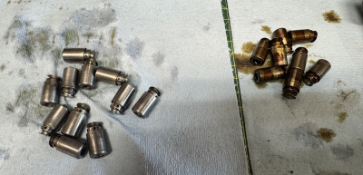

New ones just slip straight in. Old ones had a bath in the ultrasonic cleaner then a poach in some warm oil overnight.
Clean vs old
I also cleaned all the caps very gently.
Cleaned vs dirty cam caps

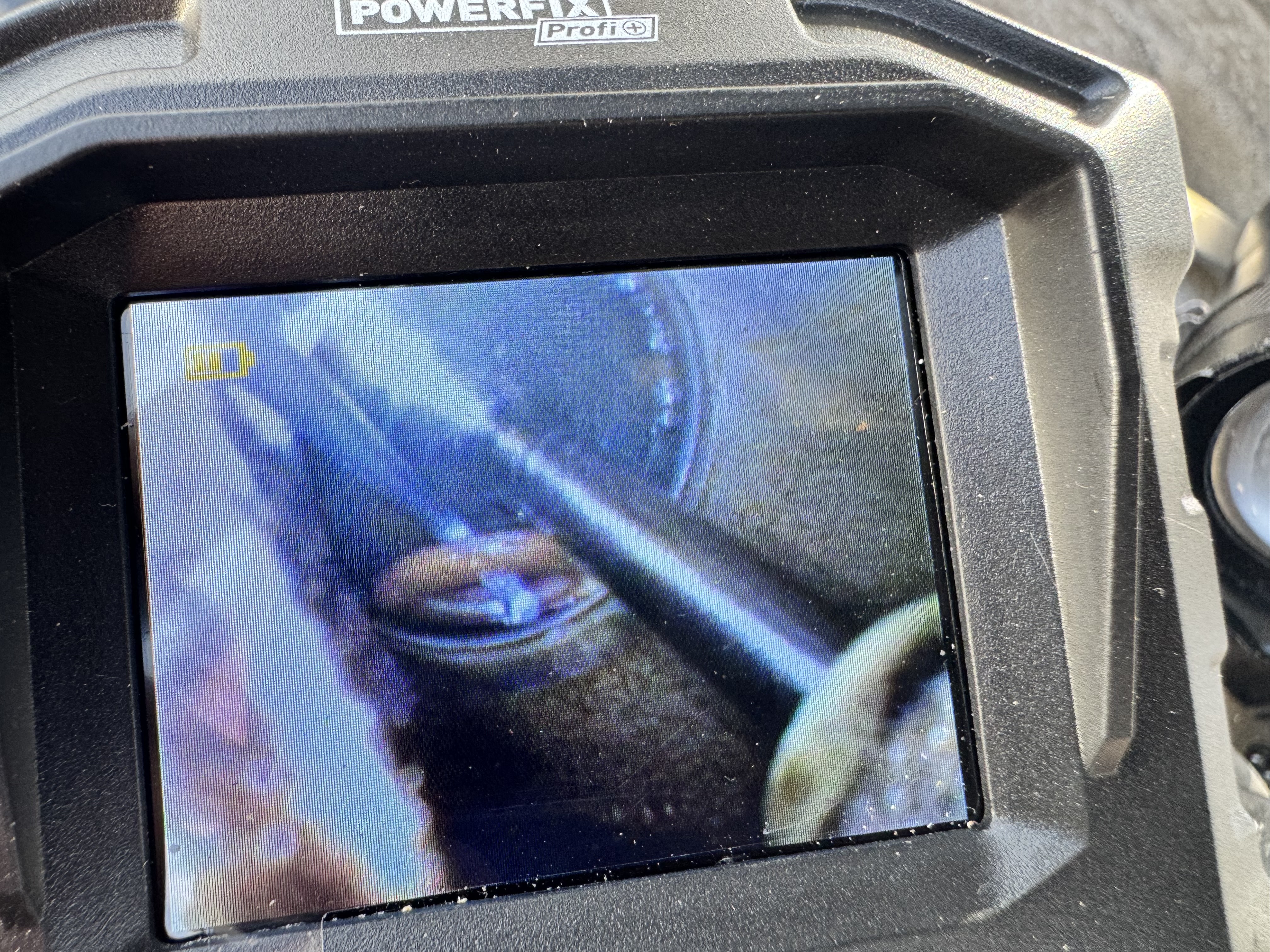

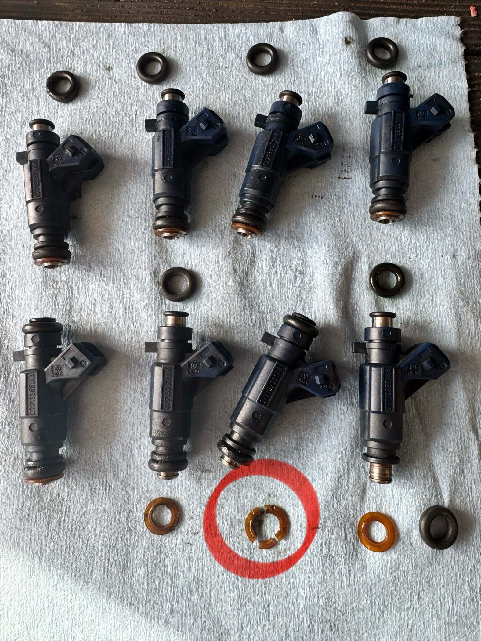

I’d also decided to clean my injectors and replace all the seals. Little did I realise the pain it would cause me. When removing 2 injectors the plastic caps were nowhere to be seen. They could only be in one place though as they fit in the end which goes inside the inlet manifold.
One cap had broken up and needed hoovering out but one was too heavy and had to be hooked out. Luckily with the cams out the valves were closed.
Inspection camera helped
All parts accounted for thank god.
