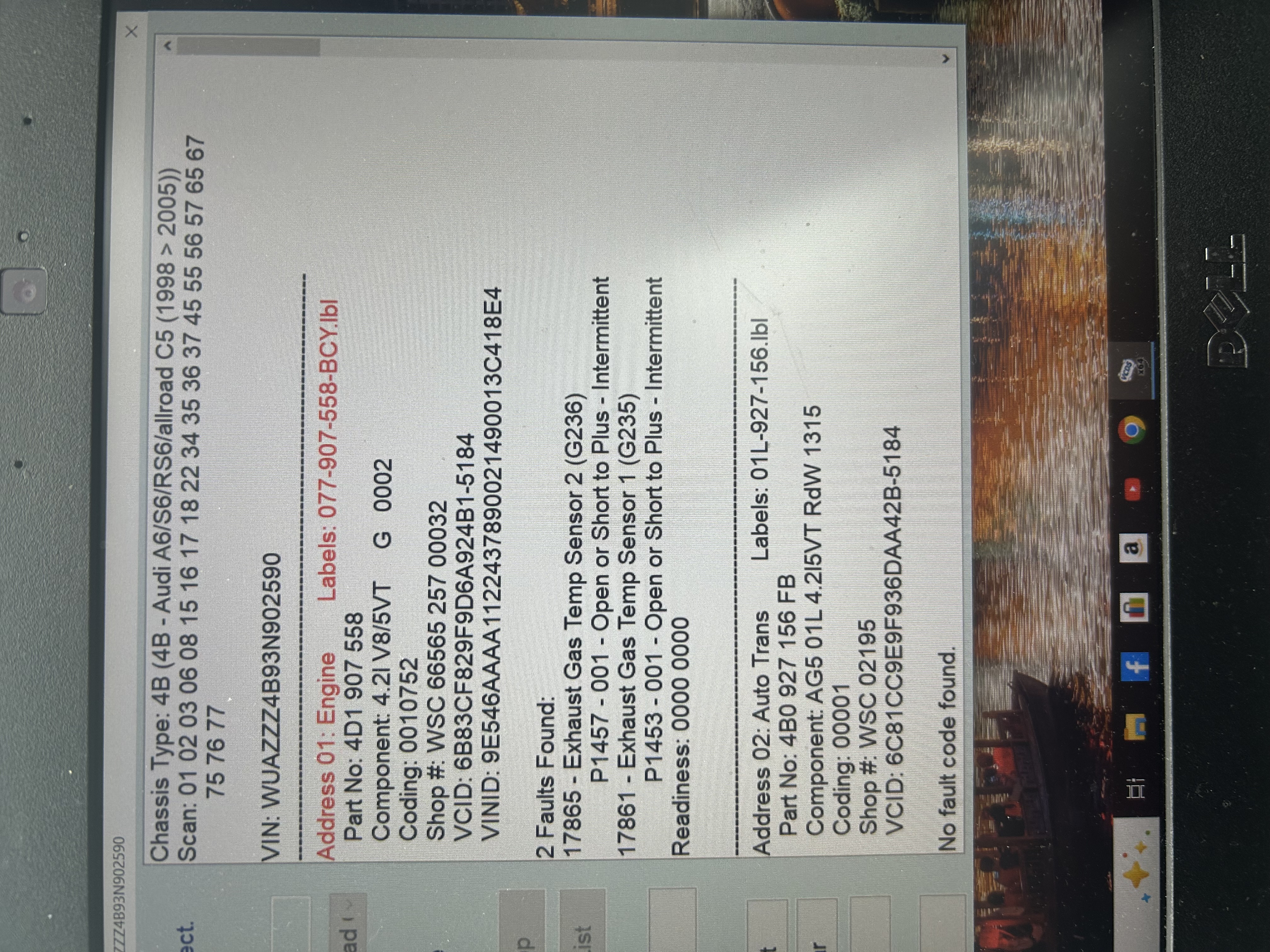

Scanned this morning and EGT errors came up on both sensors.

Hmm. Hard to believe that both failed at the same time. Clear the codes and see if they come back. You don't want to be changing those if you can avoid it. The access is a nightmare.
Maybe they were unplugged from inside the engine bay at some point recently?

Yes mate I wondered about both failing at the same time.
Both say intermittent faults.
I have cleared them.
Check again in about a week or so.
I don’t think they have been unplugged.
I did have the exhaust coupling/sleeves replaced a few weeks back.

If they are originals they had a softer potting compound on them that was easy to remove so that you can often resolder & repair in-situ. IIRC it's usually just the connector solder joints that give up. That later EGTs had a much harder potting compound that might not be possible to remove - but perhaps also gives a bit more support so the solder joint doesn't fracture in the first place.

Just re scanned the car.
No EGT warnings. Either it was a blip or the garage had disturbed something when they installed the new exhaust pipe sleeves. I did have a minor exhaust gas leak at the joint. The new sleeves rectified the exhaust fumes leak.
