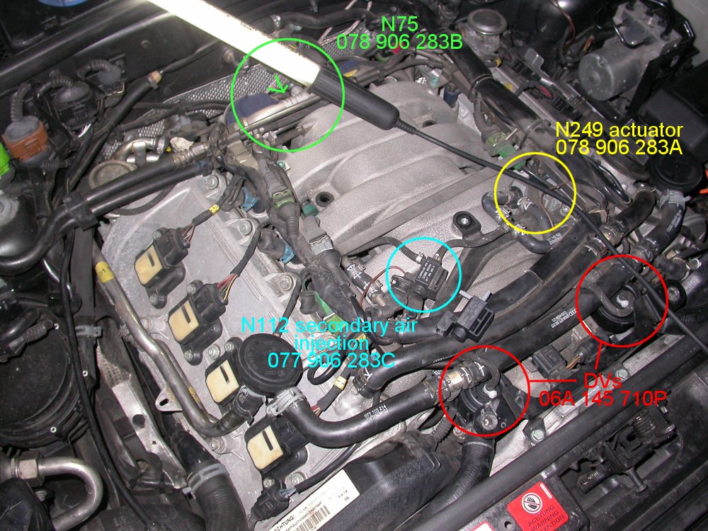

It's strange to have this error on both, so it's something common to both combi-valves. I would be checking the vacuum lines that run from and to the secondary air injection solenoid (N112). Not sure where this photo is from, but maybe it was created by Ben? It shows the location of the solenoid. The other possibility is some blockage from the SAI pump to the combi-valves, but sounds unlikely when I say it out-loud

Yeah, that's my engine.TOPMAN wrote: ↑Wed Sep 17, 2025 6:55 amI would be checking the vacuum lines that run from and to the secondary air injection solenoid (N112). Not sure where this photo is from, but maybe it was created by Ben? It shows the location of the solenoid. The other possibility is some blockage from the SAI pump to the combi-valves, but sounds unlikely when I say it out-loud![]()
Definitely sounds like a massive leak. The solenoid valves can also leak or fail. Pull it off and blow into it while doing output tests with the Vagcom. See if it switches. Or just replace it. They are cheap.
