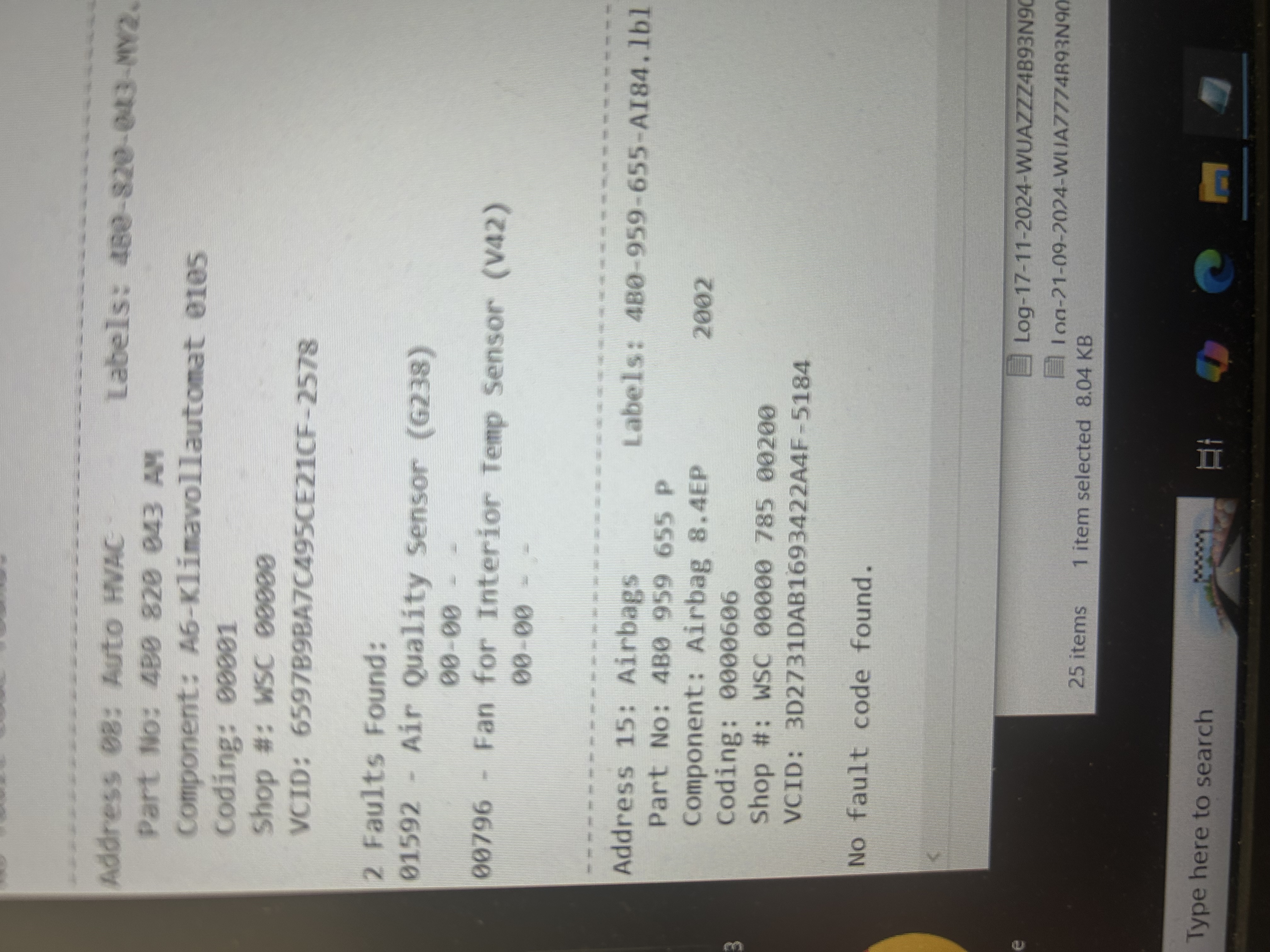

Did a scan today. Looks like the HVAC unit interior cooling fan has packed up.

Isn't it the temp sensor / connection to temp sensor for the fan that has packed in not the fan itself? If it wasn't making any weird noises in the last weeks I'd think it could be that. Also with the pollution sensor also not working maybe it's locked out ventilation?
I'd check the fuses for it first in case it's died of old age or spite.

Every thing is working fine Suz. Air con ok fan blasting cool air out in this hot weather.
It’s the tiny fan inside the hvac unit for cooling the HVAC unit internal components. I did hear a slight squeaking noise some weeks ago. But it stopped.

What makes you think this fan is internal to the climatronic unit? I'm not convinced it is.
/Looks like it probably is. I can't find a separate fan in the parts catalogue.

I googled error code 00796 v42.
Led me to the fan in the hvac unit.
I will leave it for a while then do a rescan.
“Christine” has a habit of fixing herself.
