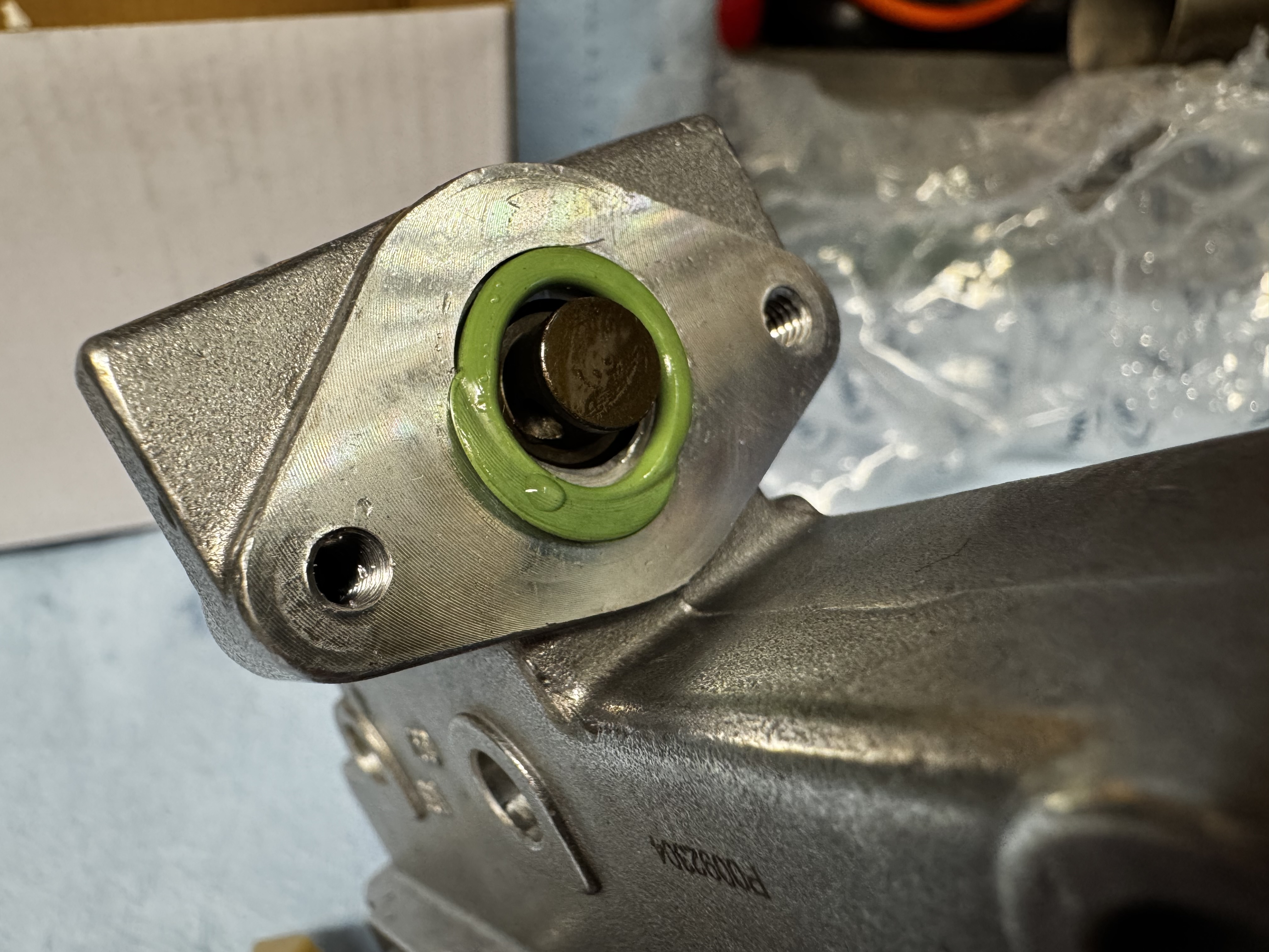

And there’s a problem. During assembly the solenoid has been bolted on and pinched the (oil) seal.
Bugger. I’ve emailed the UK supplier and they have been in touch with VAICO themselves. No word yet but doesn’t fill me with confidence in the parts.
