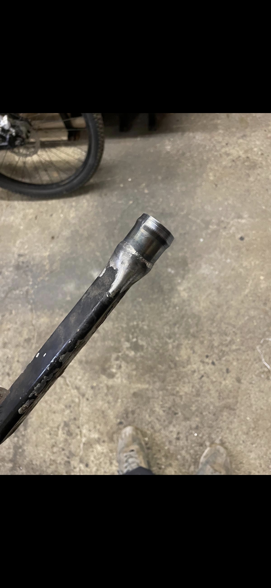

Great minds obviously think alike because I have actually already modified my existing pipe, and done it exactly like you. I bought a joiner with a rolled end and fitted it the same position. I didnt braze it in however but tig welded it on. Looks good. But typically just after painting it and intending to fit it tomorrow I've now come up with a different idea that I feel would work better so want another pipe to try another solution.
What worries me with this way of doing it is how to go from the new cut end, to the top of the rad neat and successfully. I have a rough idea in my mind how it will go and work but as you know, till the engine is in, and the rad pack is back on, i won't know if it really does work!
I don't suppose you have any pics or can describe how you went from you new pipe outlet up to the rad?
I've cut the clamps off the old top radiator hose and bought a 300mm long bit of rubber hose with a 45degree bend in it and was hoping it be able to make it work with that lot.
But it's all guesswork and a risk.
My new idea wouldnt mean guesswork or risking it.
Interesting to see and or hear of your solution.
Here is mine so far.
Picture too of it test fitted to the car with a random bit of rubber hose i had.

I made a stainless dog leg from 2 90 degree bends tig welded together with only a short connector on each end. There is a pic of it installed somewhere on here.

Only thing I can immediately think of I'd do differently - ideally put a swage on the dogleg ends. I couldn't - so just made sure to rough up the ends properly with 40 grit so the hoses would clamp & hold well.

My thoughts exactly. My plan is to buy a joiner with beaded ends. Then I can cut it in half and use it on either end. If I can find one in stainless.
Re: 077121071BL. Coolant pipe wanted.
Hard to find. I found loads in ali. I found one in stainless, waited for a month for it to arrive from china and then it was - ali. If you could find a copper olive the right size (32mm?) could maybe braze that on. Anyway, I've done loads of non swaged pipes on stuff over the years and as long as you rough up the end properly, I've never had one let go.
I even tried cutting a stainless ring that slid over the pipe that I could tig on and then grind to a nice shape - hard to weld bits that small, they just puddle up and run away - but probably your tig welding is better than mine.

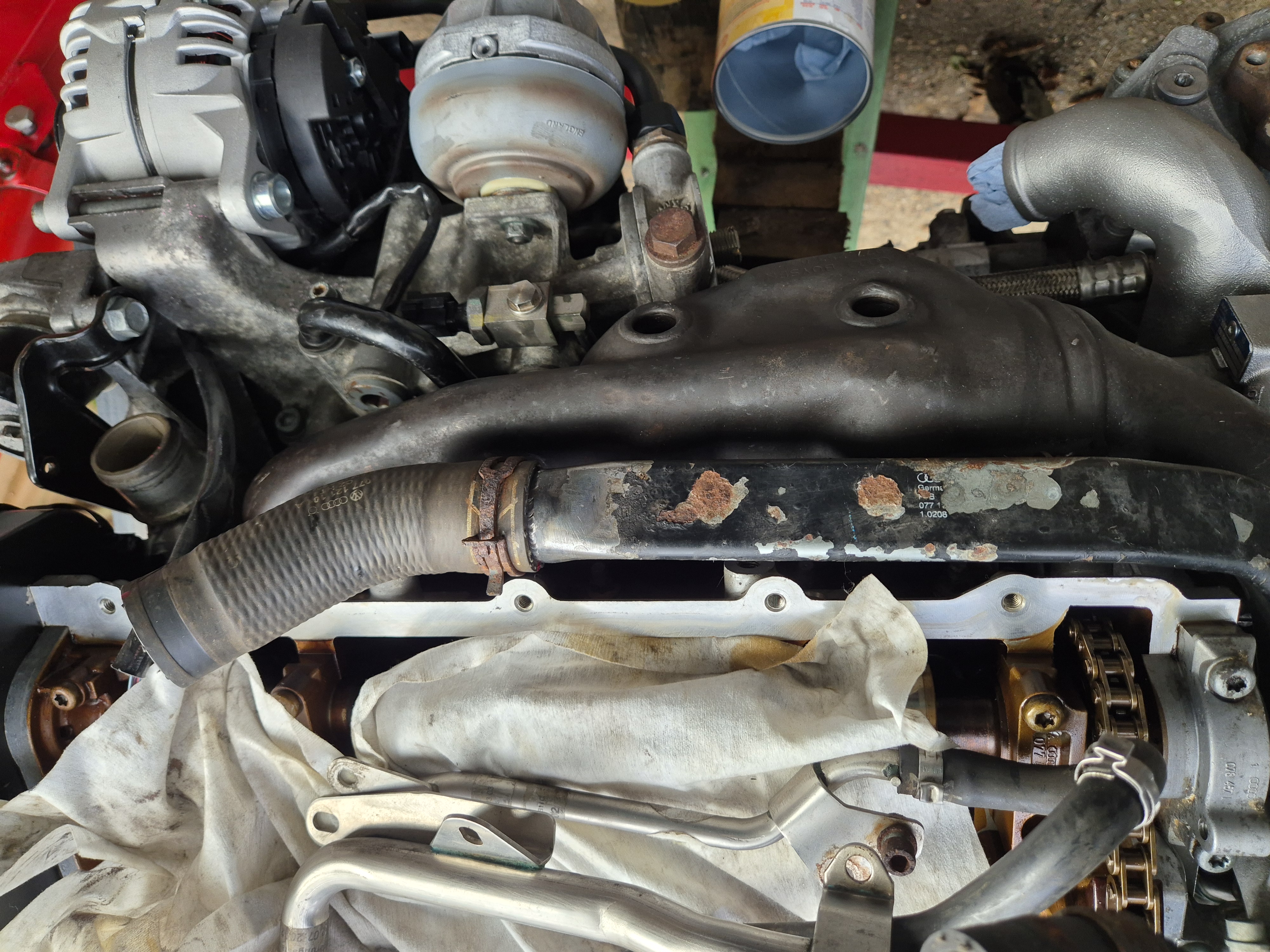

Just in case someone's wishing to do the same in future and comes across this thread. Can't find my old thread with the pics in:
I bought a used one off ebay for £45 a few months ago, as mine is corroding away, i was going to clean it up and treat it, then give it a few coats of hammerite or similar, i know it wont stop it corroding from the inside out, but hopefully it should allow it to last a few more years, not sure the current one will last more than 12 months to be honest, I did manage to pick up all the necessary 'O' rings too, just want to get it boosting properly before i strip more bits off,
