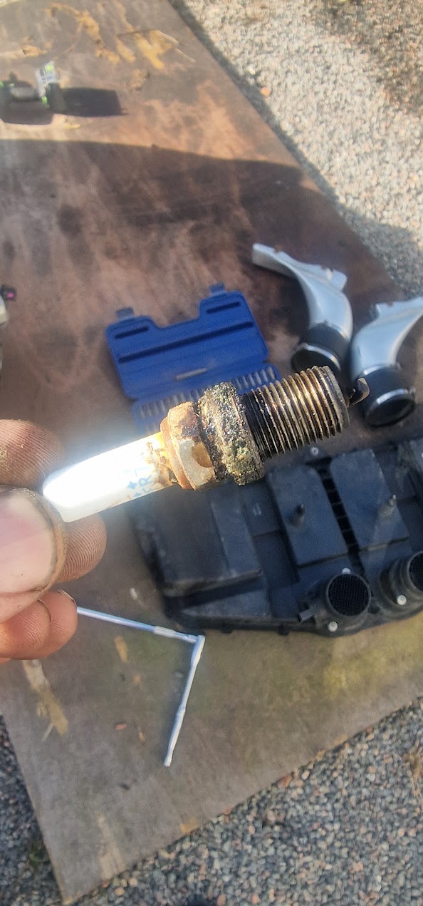

So i pulled the airbox today and found this...
Top Bodging!
Looks like the MAF seal has gone aswell.

The plug was also loose, all part of the journey, we have ticked off most of the major faults intercoolers leaking,DRC removed,belts are sorted, turbos are good, Vac pipes are all clear of leaks as far as i can see, smoke testing next week and the parts are ordered. lets see what the result is, The SAI pump is dead so that explains the fault code.

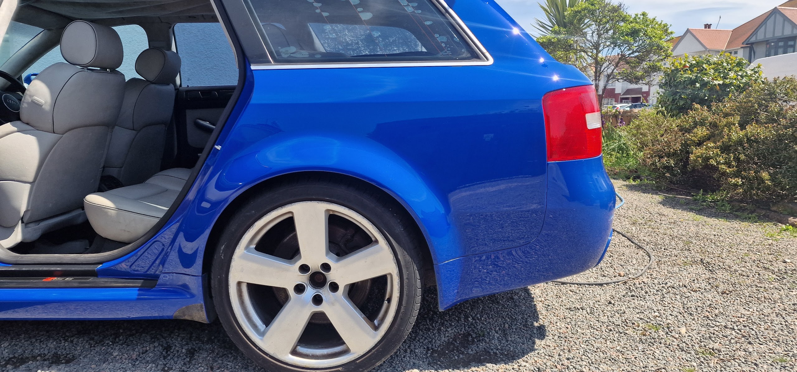

With regards to the paint here it is polished up, ive never seen sprint blue in the flesh maybe someone can confirm, i just assumed Nogaro.
Its not rocket science do it yourself.
Re: Rs6 Refurb Maf Readings
Hard to tell from a photo. Only way to know for sure is the paint code on the options Sticker (or a dealer could get it from the VIN lookup, obvs).

The Code is blank on the Sticker I am going to contact the dealer, either way it is a stunning colour, I just like the prestige/heritage of Nogaro blue.
