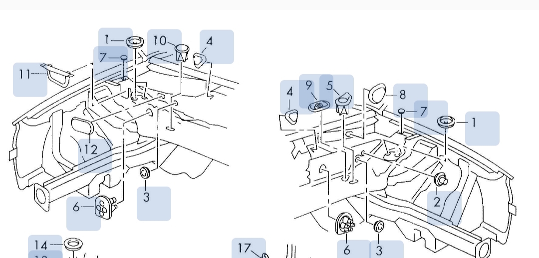

There is another one under the master cylinder area from memory. You'll probably need a small inspection mirror to see it
Items 5 and 10.

Item 5 and 10 appear to show a drain on each side of the car. Plus 1 drain under the coolant reservoir.

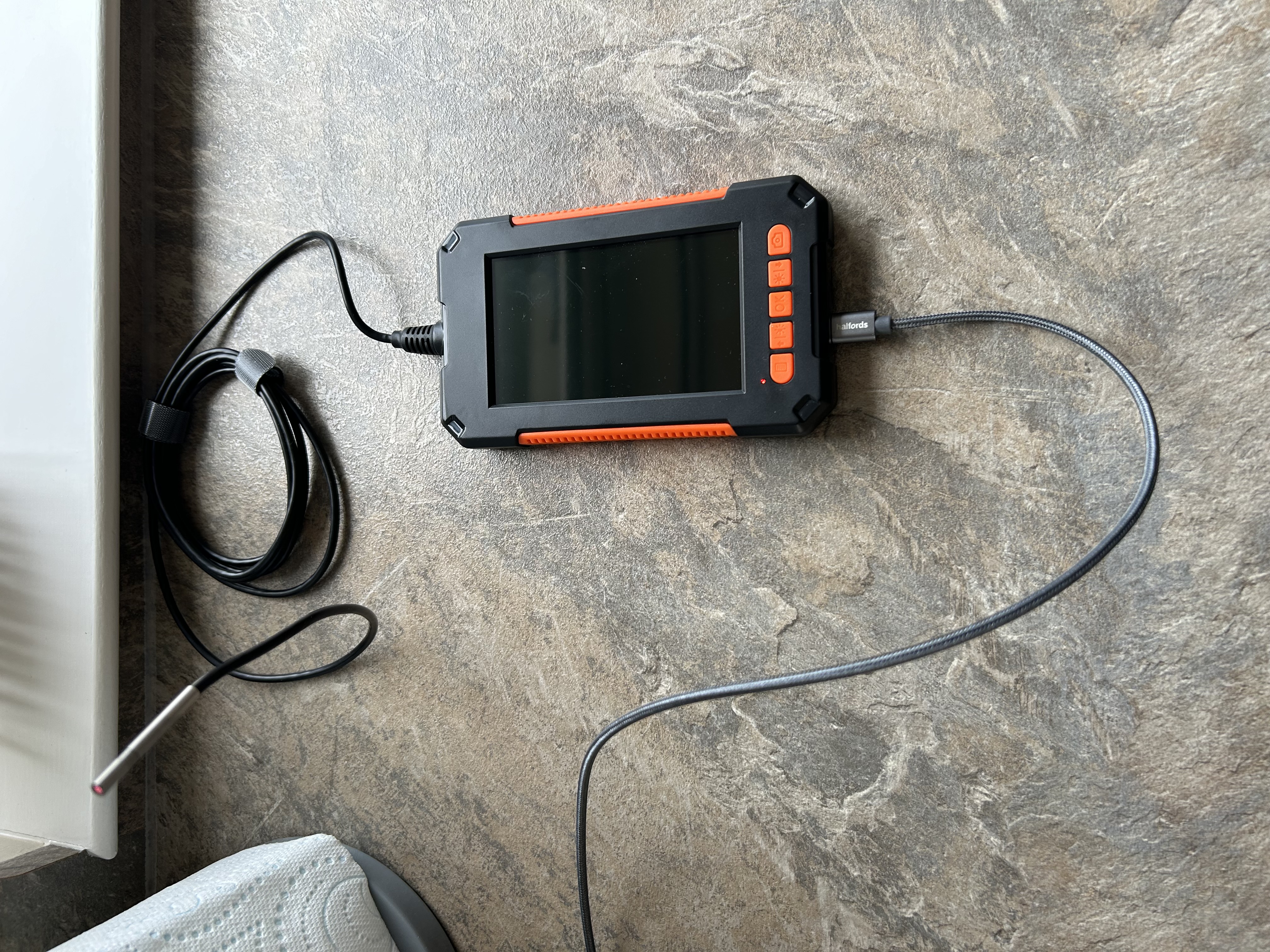

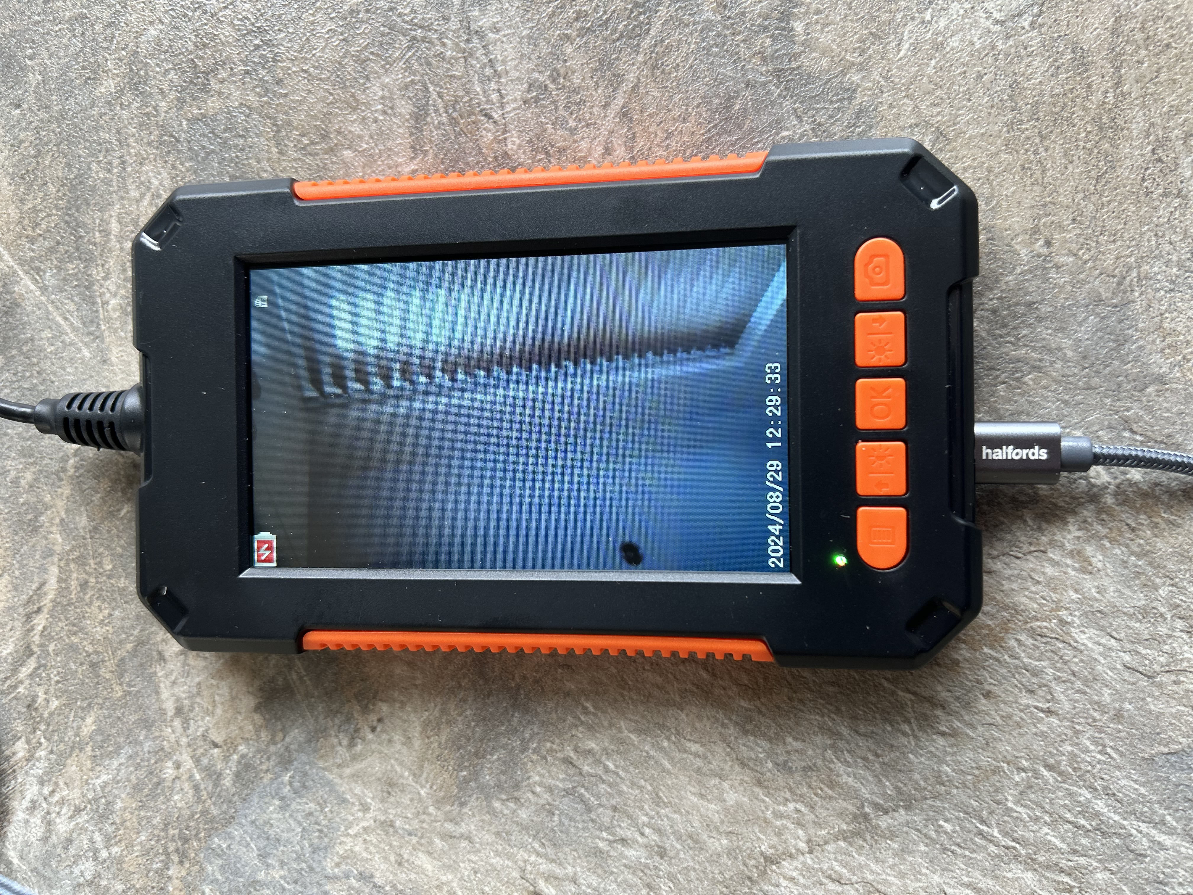

This screen endoscope P40 is really good value for the money at approx £30.
You get a great quality picture in areas that otherwise would be inaccessible.
Saves lots of time stripping stuff down.
Will wait for it to charge up. It’s one of those tools that you only use now and again. The built in probe light is great for viewing in dark places.
Once battery is fully charged I will then be able to hunt for scuttle drain plugs.
From the drawings provided by felix. It does look like there are 3 drain points.
