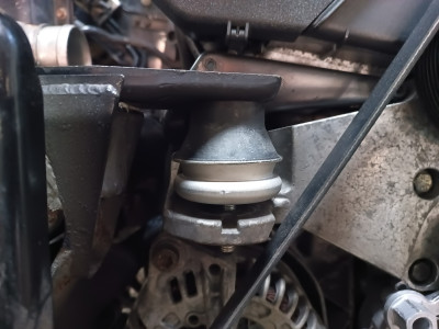

Hello everyone. I am happy owner of RS6 for a 2 years right now. Few month ago I’ve decide about making service of it. The torque converter was dying and because I needed to take the engine off, few other things have been done. Now I am about to finish but I have small issue. I needed to change front torque mount. I chose 034Motorsport product. After it is installed I noticed that there is a gap between mount and its holder (about 5 mm). When it is tighten, it is constantly stretched. All other mounts (engine and gearbox) are brand new OEM.
Should it be like that?

No,you need to put some washers to eliminate the gap
