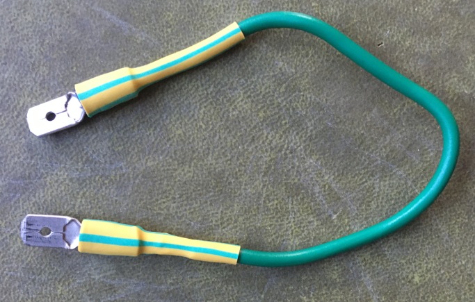

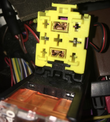

Classic F125 indeed, your dodgy starting symptoms are exactly what happened on my 2002 S8 a few years ago.
Fixed in the short term by taking out the J207 starter relay and putting a short circuit wire in. Longer term a new F125. That's the J207 socket in my S8. The wire goes between the two smaller steel connectors (left and right in the picture) NOT the big copper ones!

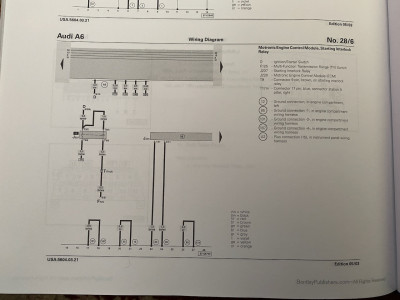

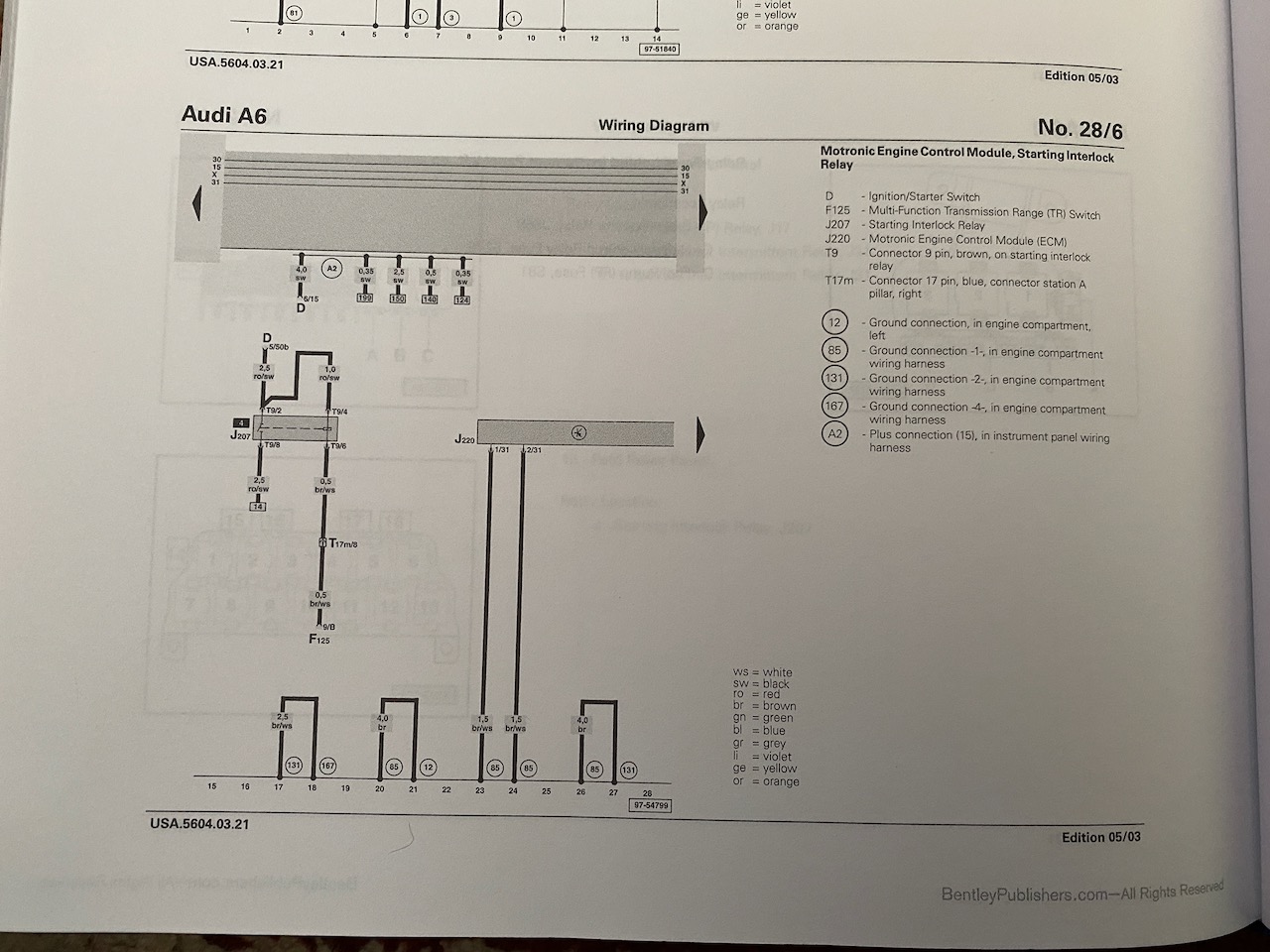

Found this useful bit of the wiring diagram in the Bentley manual. Definitely where trouble might be intersecting.

Yup. The signal goes via the F125 and to the J207 so it could be one or the other. Given that you're also getting PNRDS lighting up then that suggests that the F125 is faulty. I'd change both, to be on the safe side.

This is good for confirming/eliminating the J207. skygtb's method is good for eliminating everything else.HPsauce wrote: ↑Sat May 18, 2024 10:02 pmClassic F125 indeed, your dodgy starting symptoms are exactly what happened on my 2002 S8 a few years ago.
