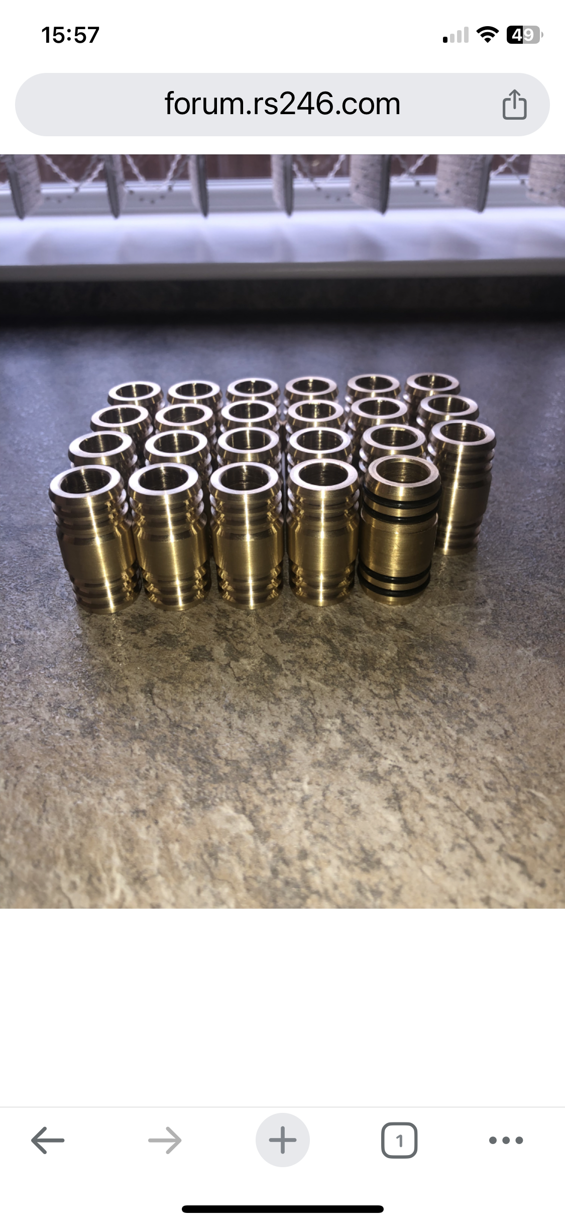

Re the bufkin pipe. If you need one let me know. IIRC I have around 8 on the shelf. Complete with viton o rings.
Cost £15:00. Posted anywhere in the UK.

OOOO YES please!!!
Il come see you start of May for one ive exceeded my RS6 budget this month so tell myself no more parts till May for the fear of her indoors burying me
