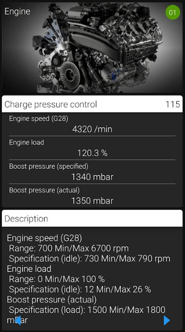

RESULT - Car feels way better, all the issues are gone she pulls nice and smooth. I have another question as looking at the logs after the work the boost still seems lowish?.. correct me if I am wrong. On the full load heavy acceleration measuring block 115:
Engine load 120.3%
Boost specified 1340 mBar
Boost actual 1350 mBar
It doesn't seem right with the engine load over 100% result of remap?... and according to the description, the boost range should be between 1500 and 1800 mBar. I might go back and check the fuel pump efficiency as a hand-up... I forgot about it until the engine was hot again... fire hazard/safety first.

That's a pretty encouraging result. Yeah, loose spark plugs would definitely cause issues. Did you order the correct NGK plugs? It's important on this car.
The engine load % isn't useful. It can (and often does) go above 100% on a stock map. I don't know what the ECU strategy is for the load so let's ignore it for now.
Your low requested boost is curious, if you have no DTC. The stock max boost is about 1750-1800 mbar (there is no min, ECU often specifies zero boost).
Now that you've fixed the issues, clear all the codes in all modules, drive the car for a few miles. Stop the engine, turn off ignition. Drive another few miles. Do this a couple of times. See if any DTC appear. Check TCU and ABS for codes in addition to ECU.
