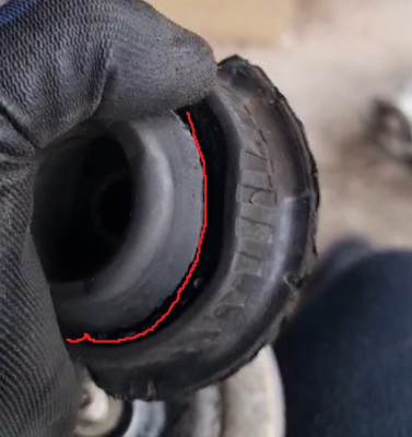

So after my initial investigations on the car looking ike trhe arms where not that old I thiought I may as well check the top strut mount , and they were absolutly destroyed.
I think the H&R coilovers may have caused the failure as they are not very soft , with the stiffness transferring a lot of the load to the top mount.
They had split in two the rubber had failed completely , the photo above doesnt it justice.

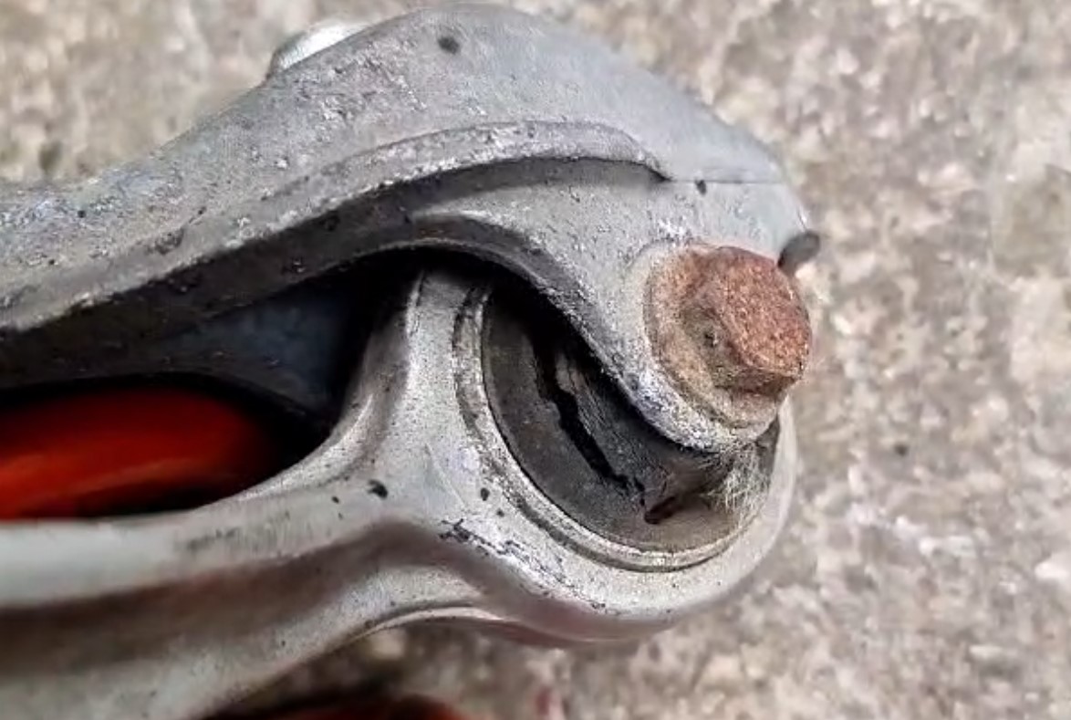

While I was there I also found that the top rear suspention arm had a split bush and a knackered ball joint , from my intial testing I couldnt see the bush properly as its tucked right in to the wheel well and I must admit the ball joint felt OK when it was installed but removed from the car the ball joint was shot.
