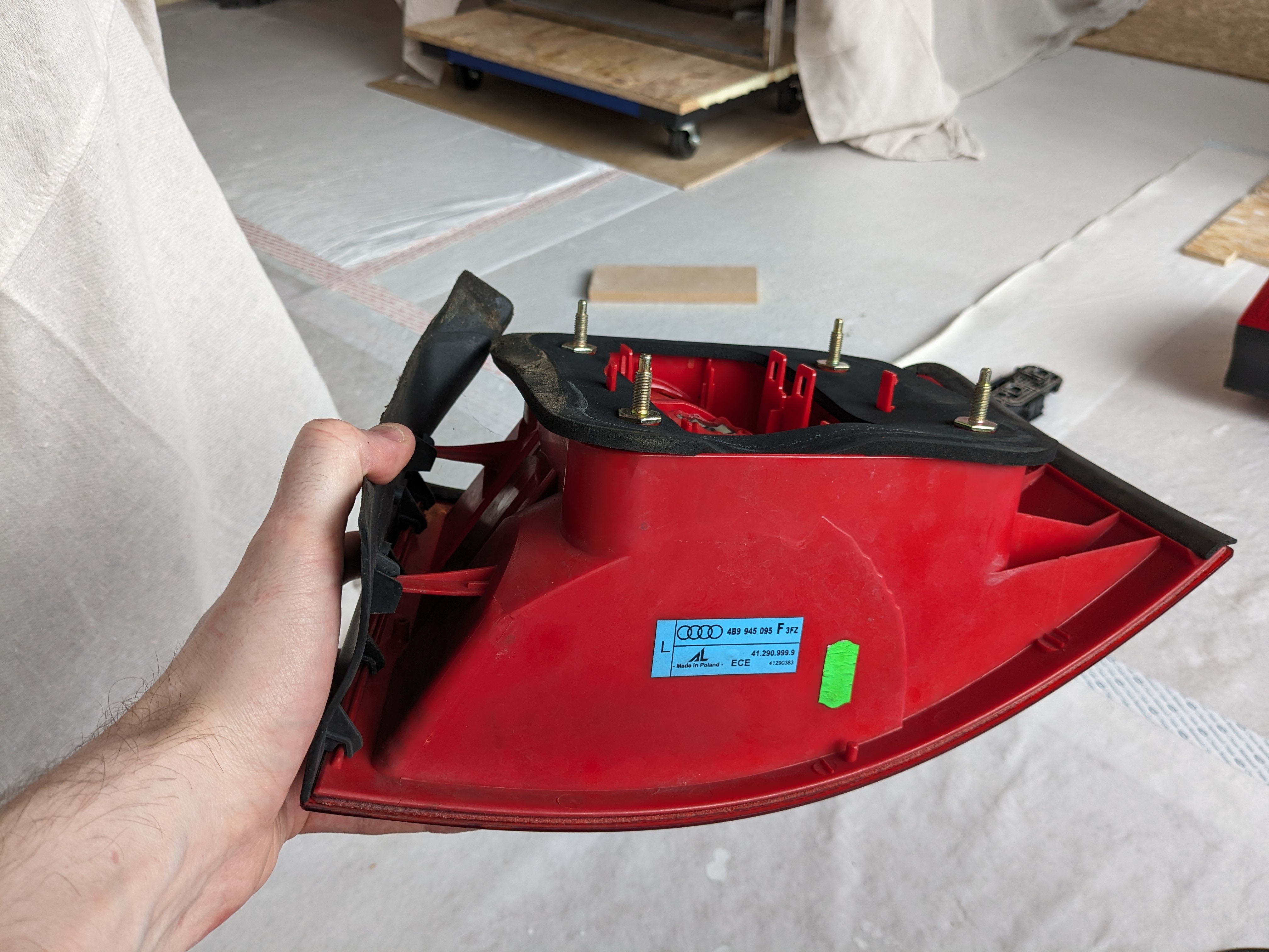

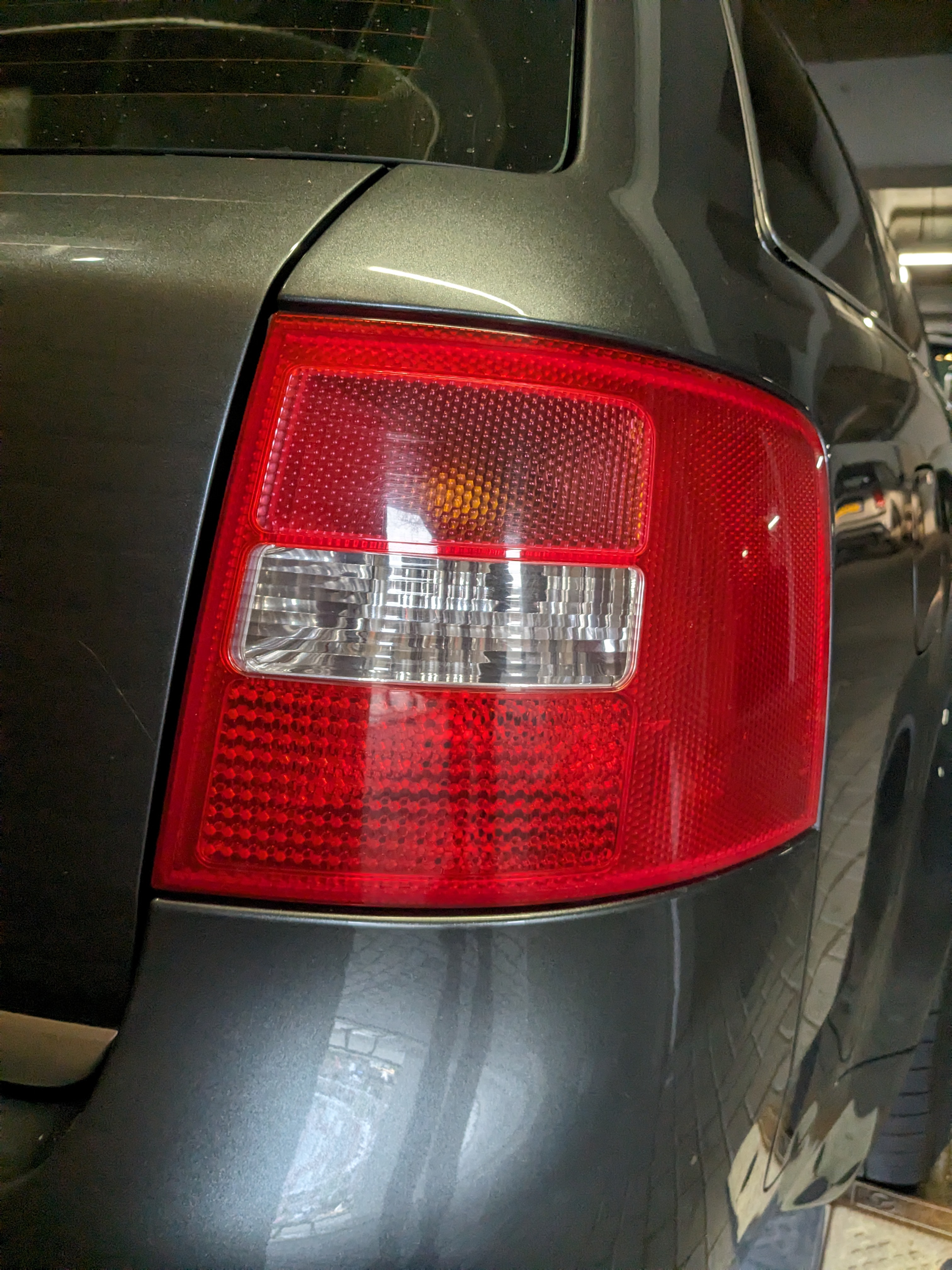

i figured i'd swap the rear left cluster with the replacement the garage gave me... only they're different. annoying
(replacement left - original right)
The unit that came off has a linear pattern on the reverse light and is a brighten red with a kind of golden glow. It matches the one on the right.
It has a part number 4B9 945 095 F 3FZ

I'm guessing the one that came off the car is correct and the garage gave me a normal A6 light. The one they gave me (on the left above) looks a lot like this from Audi Tradition:

The darker light is a pre-facelift light. The other is a facelift light it really is a simple as that.
The RS6 is a facelift car, so only came with the newer version light

cool, so i just get one, or two new 4B9 945 095 F 3FZ and i'm good
