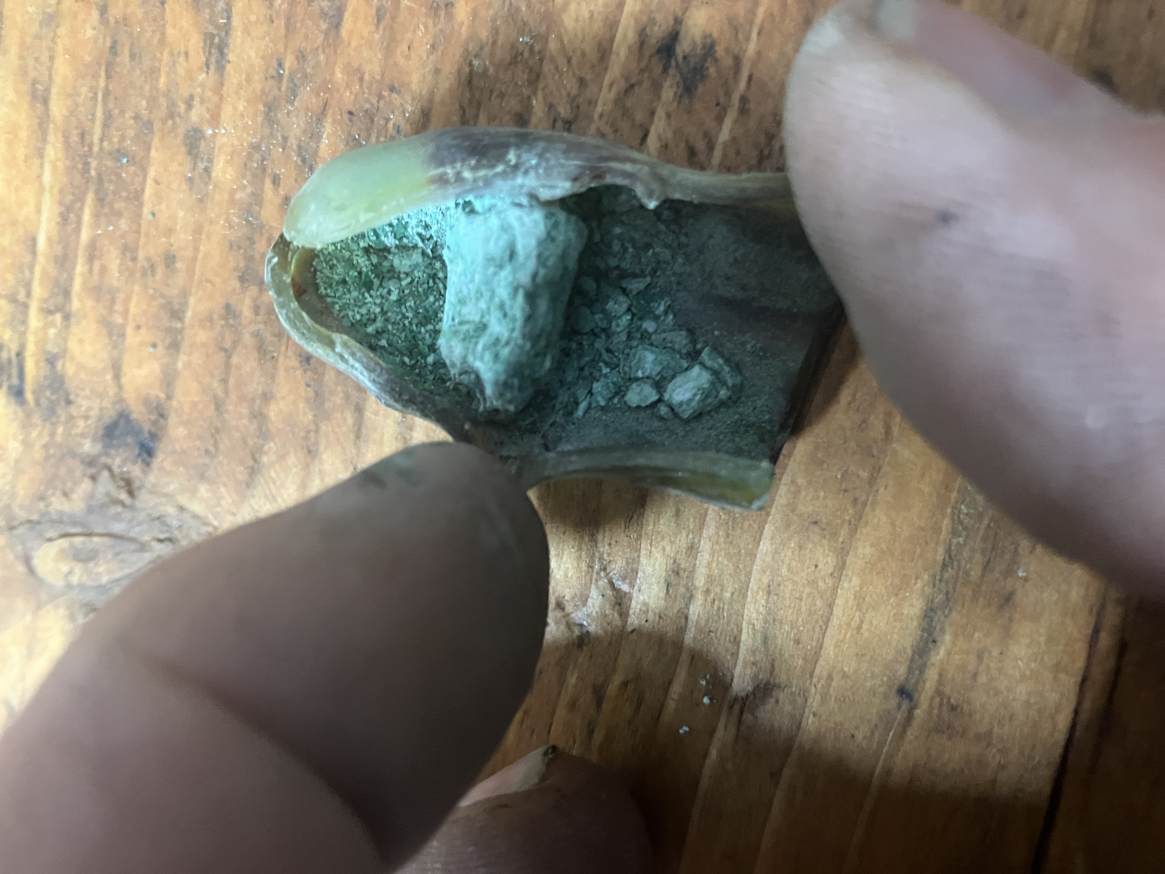

Tested the input and it was a bit odd, sound 10v. So thought i would check the wires under the seat, couldn't get the bloody seat out! followed a couple of online guides, rear caps off then undo the bolts at the front. It was still solid so i moved it forward as far as it would go and cut the carpet a little right under the seat and out of sight.All the wiring perfect and dry, except for the bundle that seems to cause problems. It is a complete bodge under there, 5 wires crimped together with a little rubber hat on top. Hopefully the picture has uploaded but that's the remains of the joint.
Anyway, just to test things i bundled them together with tape and tried it. Everything back to normal!
Just need to work out a permanent way to connect them, a Waco block would do it but will try and think of something better. I would suggest that people check this joint if they get a chance as it looks like a ticking time bomb.

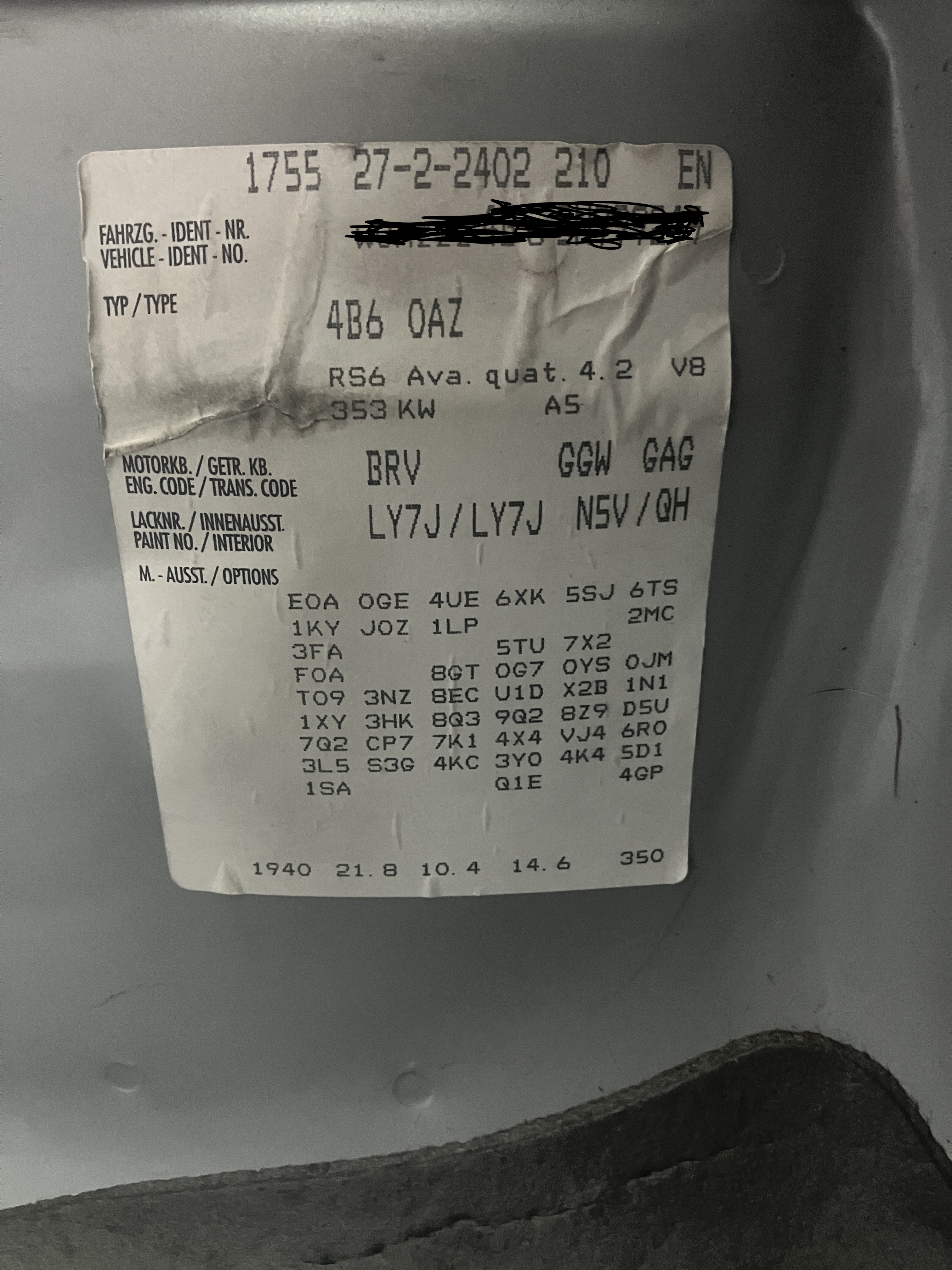

I have checked the Sticker to see if the RNS-E was original but couldn't make head nor tail of the codes, what am i looking for? Not sure i should put a screenshot of it online as it has everything on it.

Wow. What a mess! Hard to believe that’s an OE fitting.
I personally would solder them and use heat shrink to insulate. I don’t really like mechanical connectors for multi core cables. Having said that, those Wago connectors with the little lever are ace and they would be better than chewing gum.
Doesn’t really matter about the options codes now. You’ve found the problem.

Actually you could post a pic of the Sticker without the VIN if you want me to decode the options. The vin is the only potentially sensitive bit, and even then, not particularly.
Or send it to me by PM. Whatever.

Funnily enough there was another a couple of inches away and that's fine. It was dry and almost seemed like galvanic corrosion that you get on boats. My mate has a VW California and that is corroding on the roof, apparently its due to all the electrics and the alloy roof is acting as an expensive sacrificial anode.

Oh, you've got a Plus. Nice. All Plusses had RNS-E as standard.
The RNS-E replaced the RNS-D on all models towards the end of the production run. Maybe that explains the "bodge" as relatively few cars had it.
Anyway, the relevant option code is 7Q2.

Maybe I should learn to read better.

If anyone is interested in checking theirs the wires are a couple of inches below the seat belt bolt on passenger side transmission tunnel under the seat.
