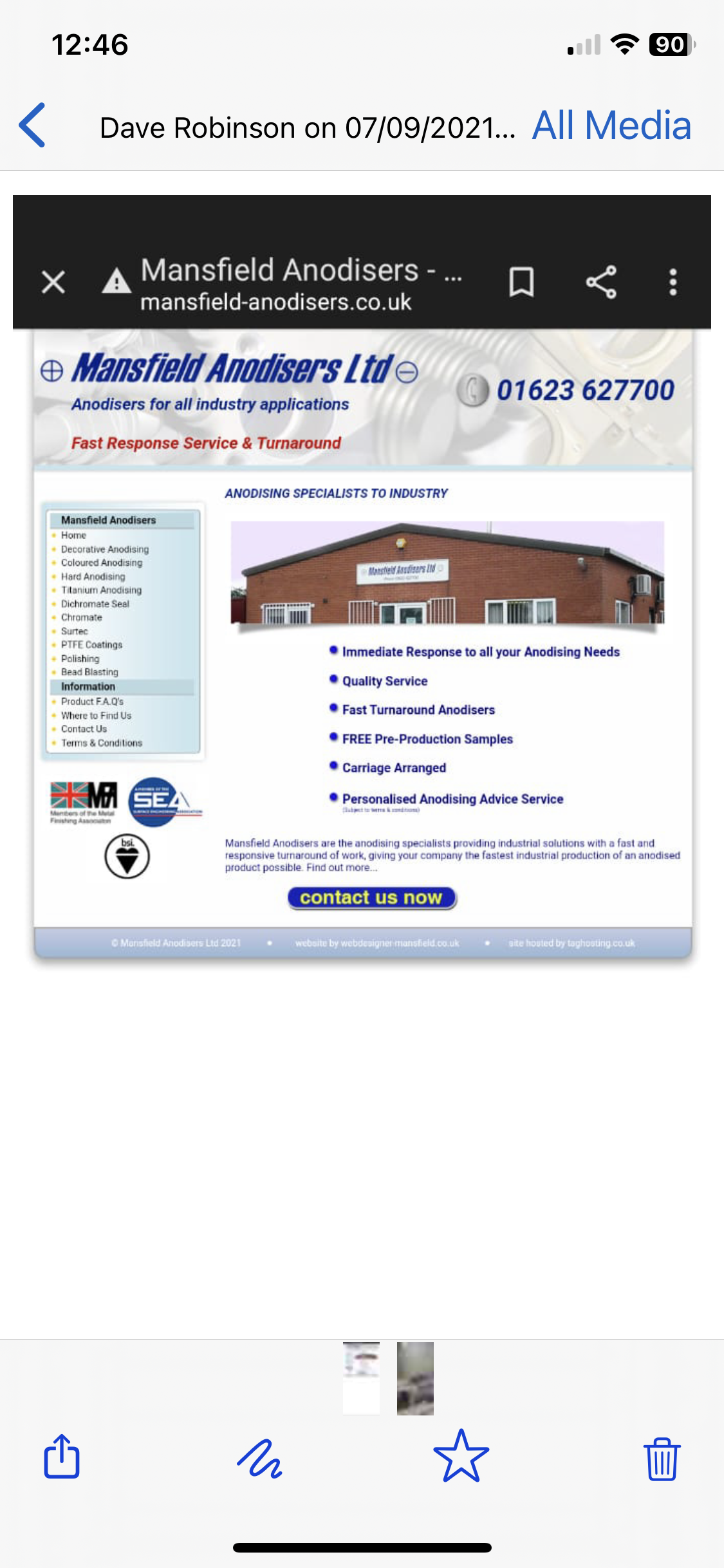

Re: Anodising roof bars and window trim
Have you still got the anodising company details I sent you a while back Ben.
I could poss get the info again from the company I used to work for if you don’t have them.
Just wondering if they had decent sized tanks.
Quality work. The company I used to work for highly rated them.
