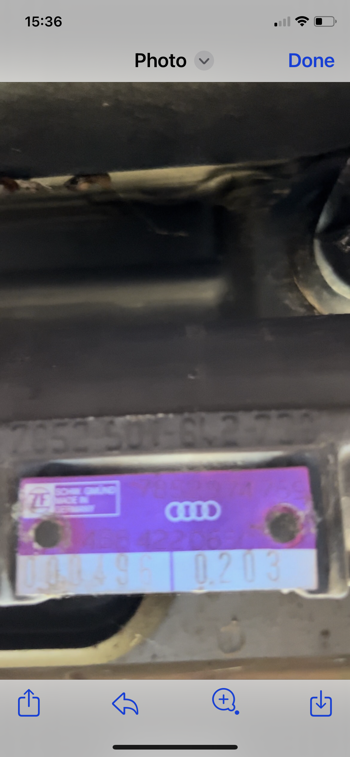

Ps Ben. The photo I got of the 65c rack has a ZF badge on it.
