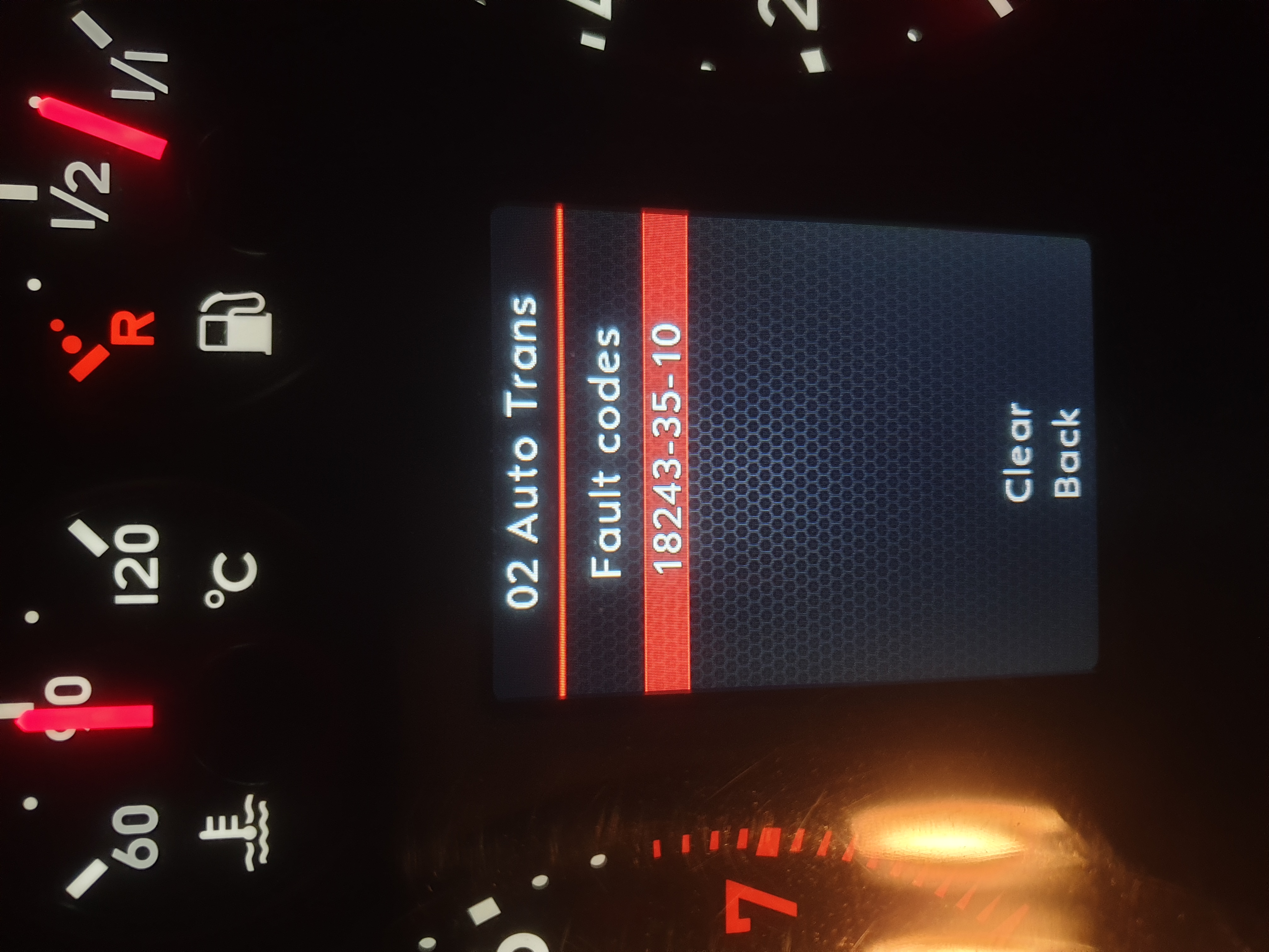

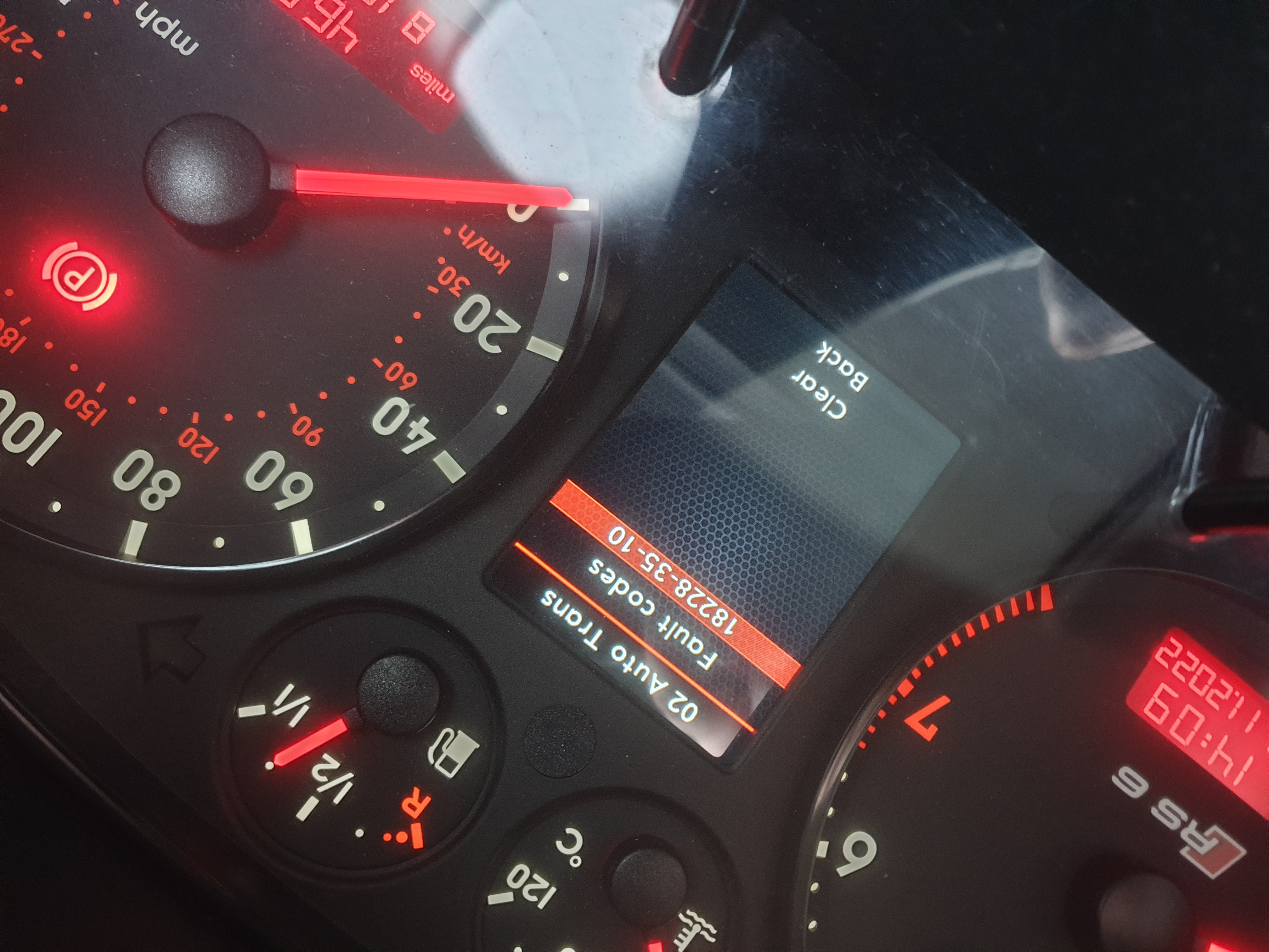

Any idea what could be the cause of these codes. One came on Monday morning an one this morning cleared them an they stayed off for now. The temperature has dropped this week and wondered if it could be this an the fact the cars been stood afew days.
Gearbox was serviced and loom changed 12k ago.

Could be:
Corroded contacts in the plug to the gearbox
Corroded contacts in the plug to the TCU (suggests water ingress - check under carpet insulation for damp)
Failing TCU
Bad harness inside gearbox
Could even be the thing to which the fault code refers, the N215 solenoid valve.
Failing TCU

18243 and 18228 are both coming up together each time the intermittent gearbox fault flashes up.
Re: Gearbox fault
I suspect a contact problem rather than a problem with the solenoid valves. I guess it depends how expensive they are. My feeling is that the harness will resolve the problem, but if you've had corrosion on the pins then that might never make a good connection. Have a good look when you replace the harness.
