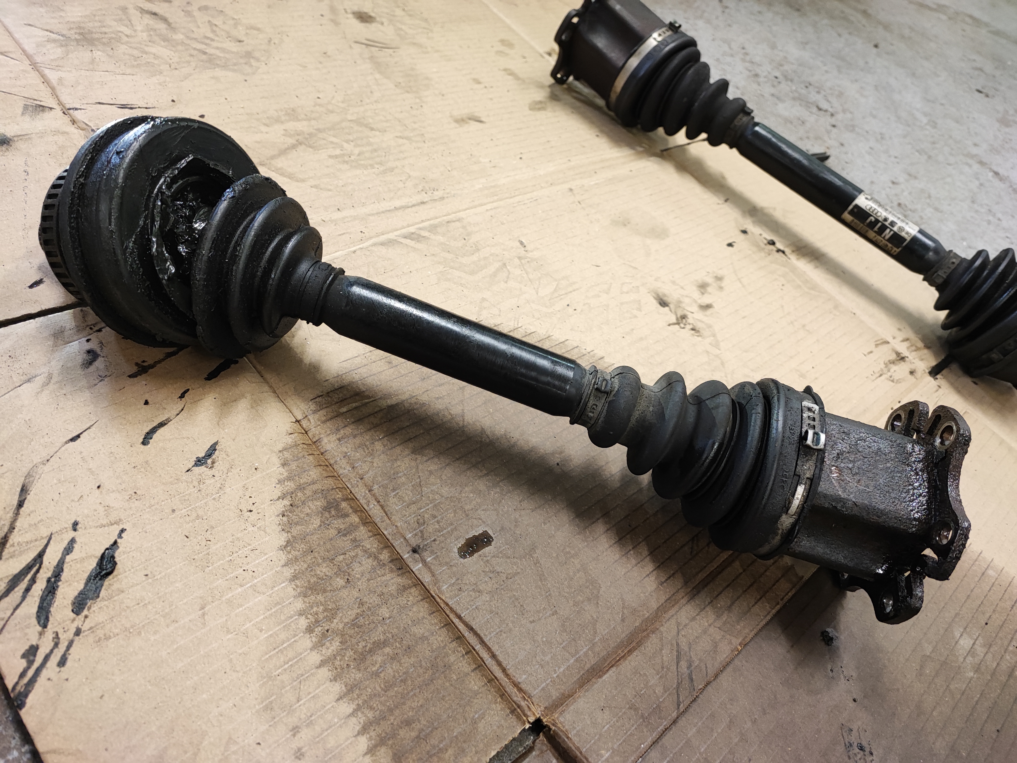

Been having fun these past three days with pinch bolts, stuck control arms and more. Reason?, well:
The other shaft is actually ok but I will replace both in any case.
