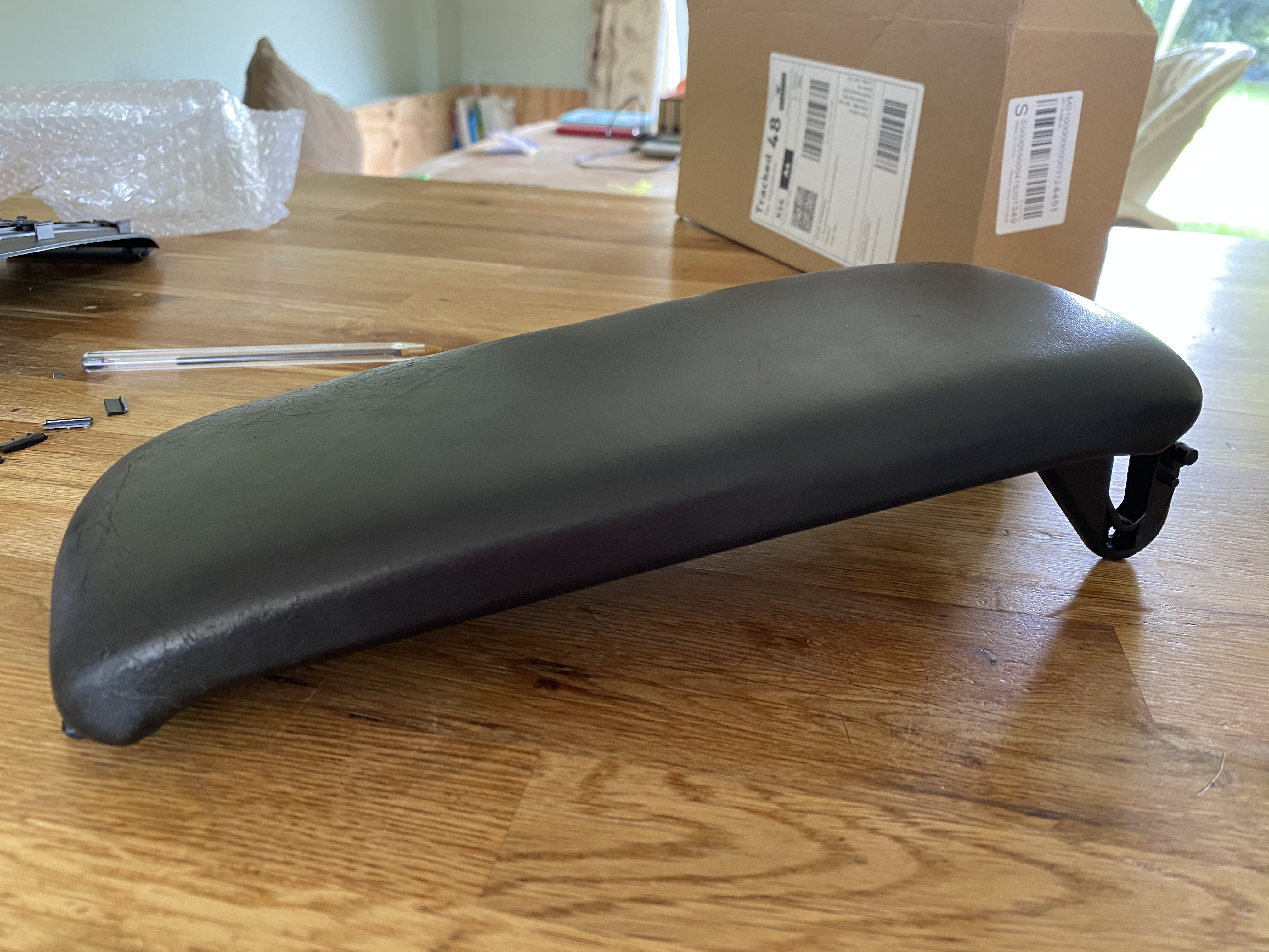

Well there’s no need to recover the armrest...
At £10 a pop I thought I’d break one up to see if the part can be split in two and it can.
Pop the top off from the hinged base. The OE part has three tabs per side while the new bit has five.
Once they’re apart you’ll see the two tabs per side that need to be removed. A couple of passes with a stanly then snap them off does the trick.
Now you’ll see two little triangles along the front edge that need to be removed. Again the Stanley done the job.
Unfortunately here I had started clipping it back together before I spotted these two half moon tabs to the rear that needed to be removed. Thankfully the multi tool made sort work of them.
Here you can see how much more padding the OE has over the knock off.
Anyway the job took 10 minutes and just clips back together. The only risky part is not breaking the OE retaining clips when you split them and reattach. However even if you did do this the I’m sure velcroing the lid on isn’t a bad idea.
EDIT; just to add that there are two little bump stops to take off the front of the OE rest and pop in the new fitting. 👍
Hope it helps guys. 👍
