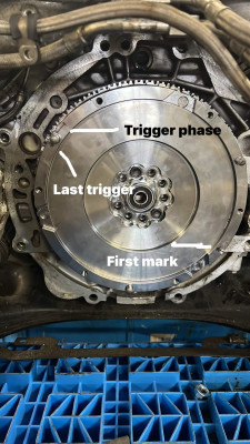

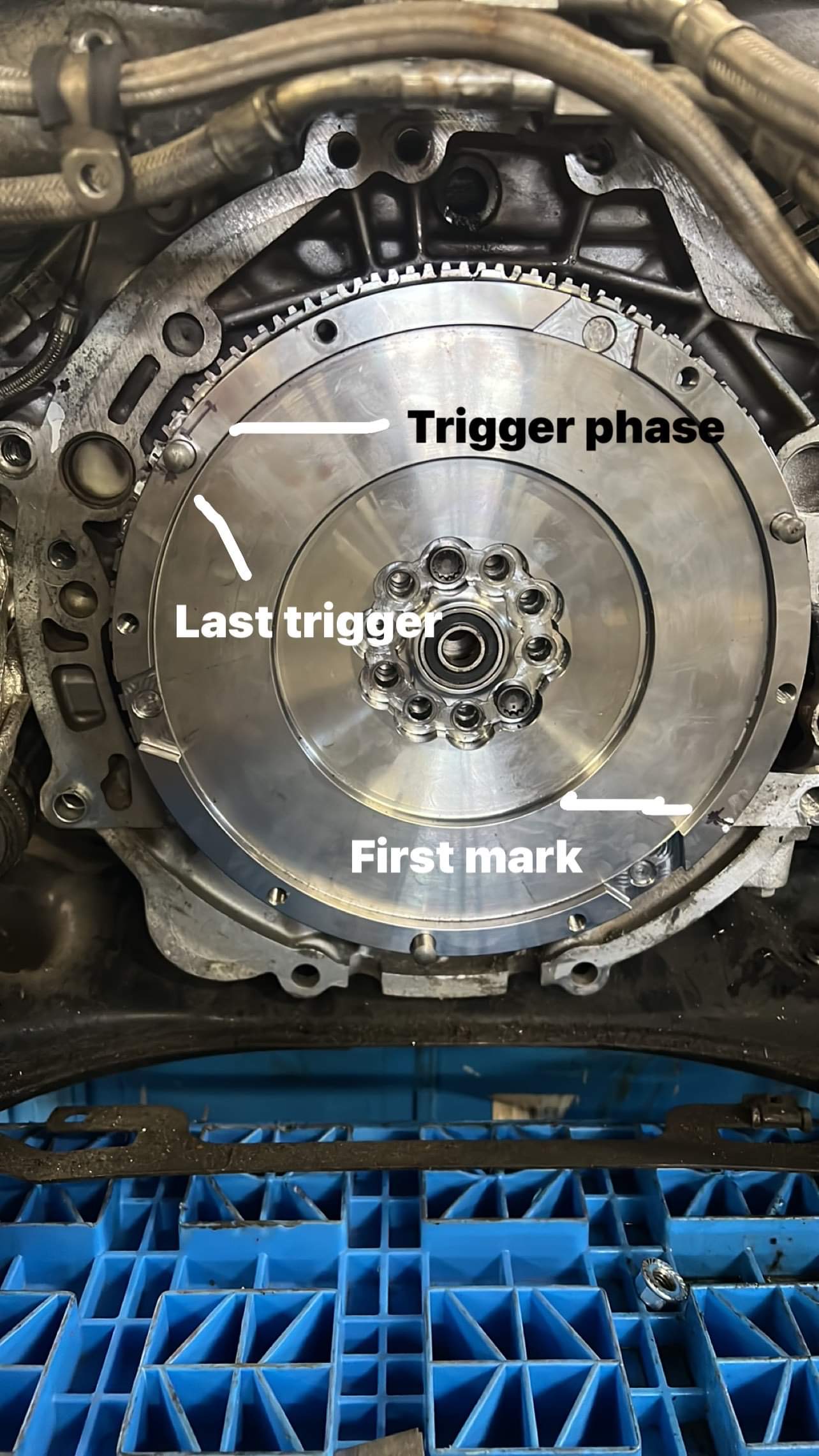

The trigger is not in the same place as the auto...a few teeth off as the sensor mount is further towards the top of the motor compared to the auto. I was worried about the same, but knew that my flywheel came off of a running car, so trusted the installation. Here's a pic of mine where the trigger lines up with the lock pin in.
